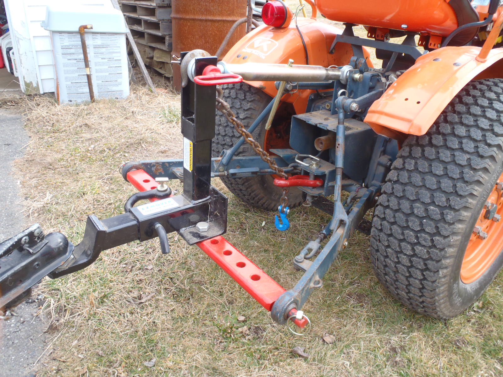

Have a JD2210 (class 1 3-point) and just picked up a Agri Fab lawn sweeper. I have a draw bar accross the lower arms that I attach the sweeper to.
The sweeper has a huge grass catcher. When it is half full the weight will start to lift up on the 3-point and the sweeper will not function.
How do I keep that 3-point down?
I cant attach the sweeper to the chassis, where I have a ball mounted, as the tounge on the sweeper is not long enough and would hit the tires in a turn. That was the problem I had when I picked up a lawn cart which led to the draw bar.

Disable draft control (or whatever JD calls it on sub-compacts).

Can you chain the 3PH drawbar to the drawbar on the tractor? Or you could run a chain from the top link attachment point to the tractor's drawbar. I'm not familiar about how your tractor's 3PH is set up.
That is what most people do to keep the 3PH from lifting up. Just be careful not to try to lift the 3PH while it is chained. :duh:

Try what gwdixon described, like this:
Wow, I would not try something like that, it looks like an opportunity to break something!
IMO, you should not need something like that, the 3pt should not move on it's own if draft control is turned off.
Should or not, there is no hydraulic down pressure on a 3PH. You can lift it yourself if you don't believe it.
The problem comes with a trailer that is loaded improperly or the load shifts to the rear causing the tongue weight to be negative. The trailer tongue and 3PH will tilt up no matter where the draft control is. Granted, the draft control should be disabled to keep the 3PH from lifting automatically.
To the Safety Police: keep your hands off the 3PH lift lever and everything will be fine (as stated in an earlier post). Even then, the hydraulic pump will likely go into relief if 3/8" chain is used and somehow lift is applied. 5/16" chain will work on smaller tractors. The chain won't snap, nobody is going to get killed. This procedure has been used for the purpose ever since the 3PH was invented.

You just contradicted yourself. WEIGHT holds it down.
What??? Weight doesn't hold it down when the trailer or implement is lifting it up, which is what the issue the OP stated at the top of this thread. Nor when you are backing up and something stops the wheels on what you are towing and it tries to rear up.

Another vote for chaining to the drawbar.
Its not always about just correcting the issue with weight, sometimes the issue just cannot be corrected.
Having to do a quick brake, will cause the 3PH to rise up sometimes EVEN if there positive tongue weight. Cause as it raises, the hitch comes forward. When stopping in a hurry, momentum going forward can sometimes overcome the weight pushing down. And then you have a trailer hitch coming forward and up toward the operator.....NOT GOOD.
My car trailer empty has almsot no tongue weight. (actually only about 100#) It dont take much to make it raise.
Varying terrain can also cause unexpected results.
I agree, just chain it down. Been done millions of times for many decades. And been talked about on here endlessly everytime someone mentions towing a trailer with the 3PH.

Have none of you guys ever seen the stay bars that go from the top link mount to the lift arm ends? They're as common as a pocket on a shirt with the 3 pt. mounted draw bar. You can even adjust them for the draw bar height you want. Take another look in the farm store and they should almost be right next to the draw bars.
   / How to keep 3 point from rising #20
