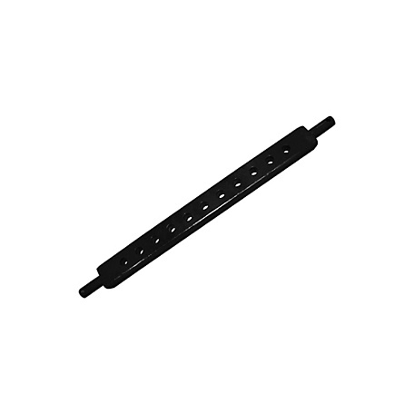

If you can weld, you can make one pretty easy with a Tractor Supply drawbar and a couple of pieces of angle iron.

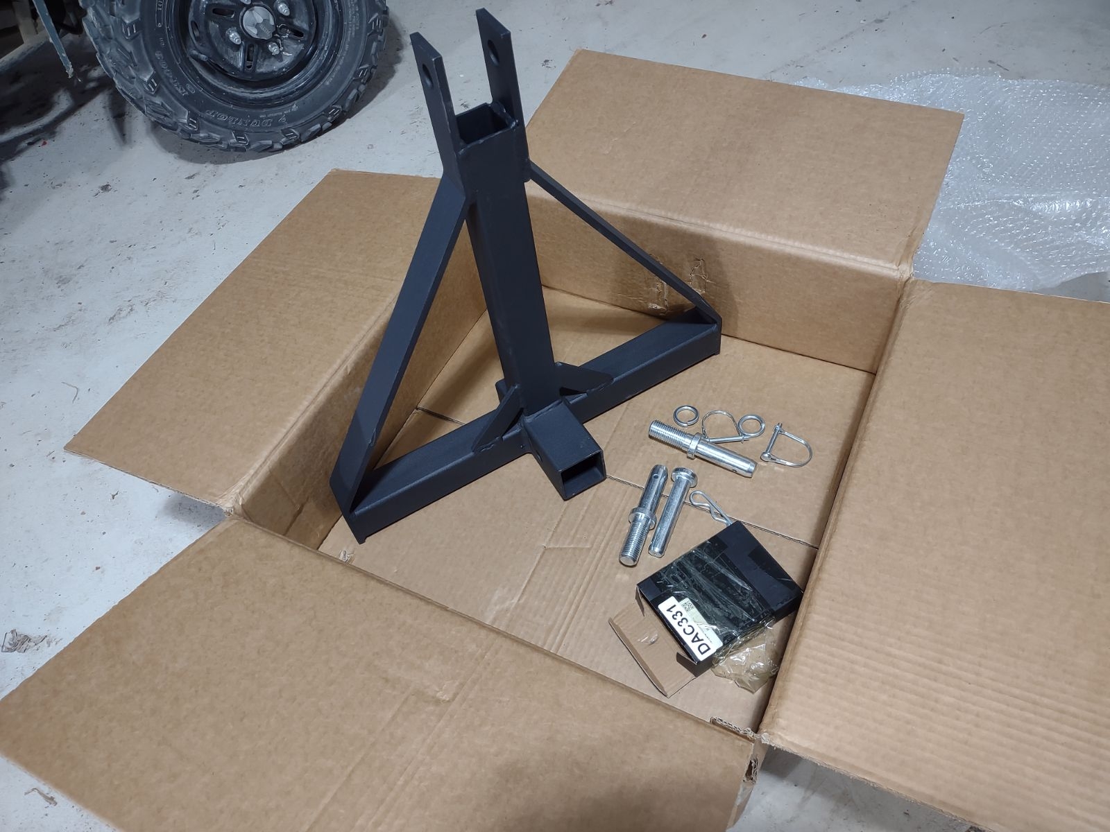

I found this on eBay. $40ea, with pins and free FedEx shipping. I bought two. Made in China, but I should be able to make them work.
Just wondering - how can some Chinese "company" copy someone's design, buy steel, make them, powder coat them, ship them across the ocean, include the nuts and pins, pay for shipping and have any markup left for the re-seller in Texas to sell them at $40... ??

Something to consider:
Many of those frames and trailer movers are not quick hitch compatible. They have an obstruction below the top hole that prevents the top hook from reaching the pin.

Yeah, my quick hitch is pretty big, under that top hook.
That's okay, I think I can fit these. They're going to be cut, welded and/or modified anyway.
