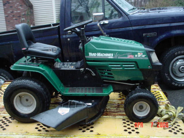

You need a new mechanic. It should never take 40 pulls to start a chainsaw even if it is completely out of gas. I have four chainsaws that I use constantly. Three Husky's which consist of two 55 Ranchers and a 262XP. The other is a Stihl 210. None of them require more than 4 pulls to start and possibly six or seven if they run out of gas. Sta-Bil is the cure for your carb gummy problems in any two cycle or four piece of equipment. I have fixed quite a few carbs for friends that have had this same gumming problem. I've also picked up many lawnmowers including this 18hp hydro unit for free because the carbs were plugged up and wouldn't run.
