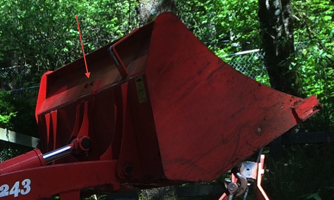

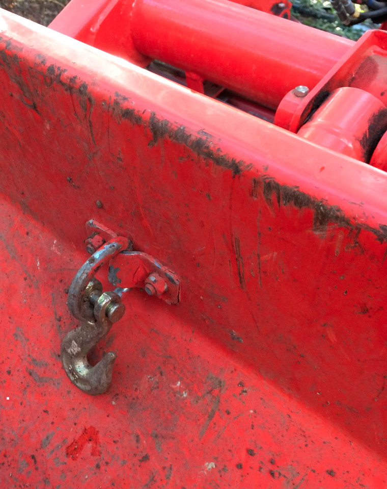

Make two attachment points on the inside of the bucket where the loader arm reinforcement is.
This is how I did it on a BX with one center cylinder. The hook and loop have never interfered with normal use of the bucket.

I'm not sure how thick your bucket is, or how heavy you are lifting, but you might want to consider putting a doubler plate on the back where the bolts go through.
   / How to lift from the center of the bucket #6
There is already a 1/4 thick plate there for the cylinder mount.
Bruce
   / How to lift from the center of the bucket #7
Bruce
I see it, now that you have pointed it out. Mine has two cylinders on either side, so no plate in the middle

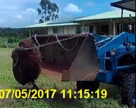

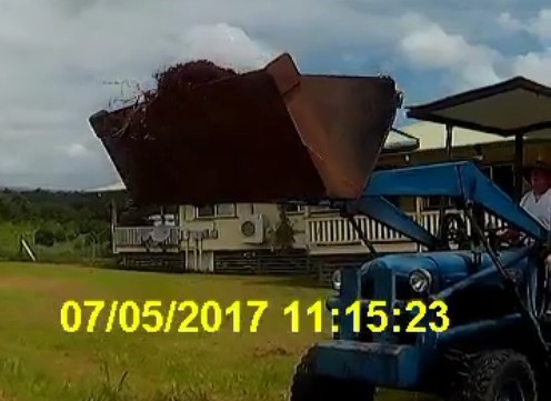

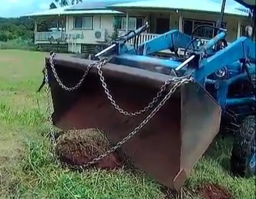

I do this all the time after I pull the rock out of the ground with my subsoiler:
Hook rock with chain
You can either set it down and reset the chain for carrying
or
Drop it into the bucket
