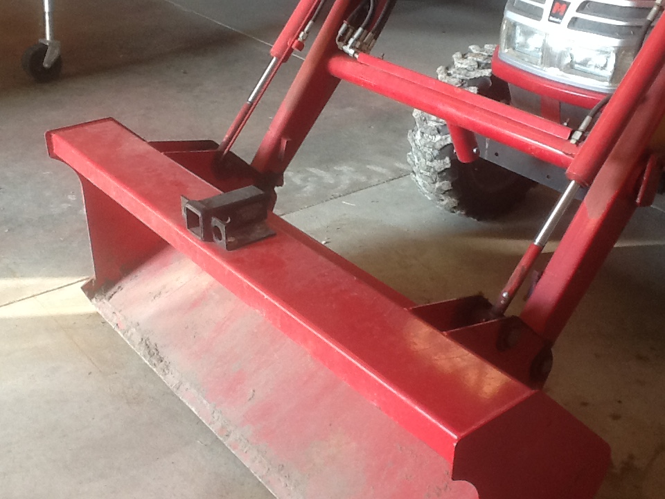

image.jpegimage.jpeg. I bolted a receiver to the center of my bucket. The base is 5" X 7" so the load is spread and I can use chains or a trailer ball mount.

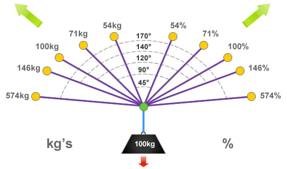

Sorry, but I think your reasoning is wrong. To analyse this, you need to think of the tension in the chain (the force exerted), and the directions in which it is pulling. It is a vector problem from upper high school Physics - if you have a 10kg weight hanging from a single vertical chain, the tension in the chain will be 10kg (for the purists, I know forces are measured in newtons, the units don't matter here). If you put that same 10kg weight on two chains at an angle, then the total vertical force must still be 10kg, but you also have horizontal components added, so the tension in each angled chain is more than 10kg. The shorter the two chains, then the greater the horizontal components of the forces.
A quick demo - stretch a chain very tightly from the tow bar of a parked (brakes on) vehicle to a tree, and then stand on the chain - the vehicle will be pulled towards the tree, even though you normally would never be able be able to push it. The chain MUST move down to provide the upwards force supporting your weight, and the vehicle moves in just enough for the force vectors in the two halves of the chain to cancel your weight. Details at Pull a Car From a Ditch With the Super-Strength of Physics | WIRED
To get directly to the question of lifting loads with two chains, try: Vector Forces - ropebook
They have a number of excellent diagrams that would have saved me a lot of typing!
   / How to lift from the center of the bucket #28
As others have already noted, the shorter the horizontal chain, the more stress you put in it, the hooks, and the welds. In fact, it's quite easy to put more than the rated working load (and even more than the breaking load) on that horizontal chain with even a moderate weight being lifted or pulled. For example: assume you are hooked to the midpoint of the horizontal chain, and that chain has a "sag" of 1/2 foot at the midpoint. If the hooks are 4 feet apart, the sideways force on each bucket hook will be 4 times the weight you are lifting (1/2 the distance between the hooks, divided by the "sag"). Tighten that horizontal chain up to a 4" sag, and the sideways force on a bucket hook will be 6 times the weight you are lifting.
