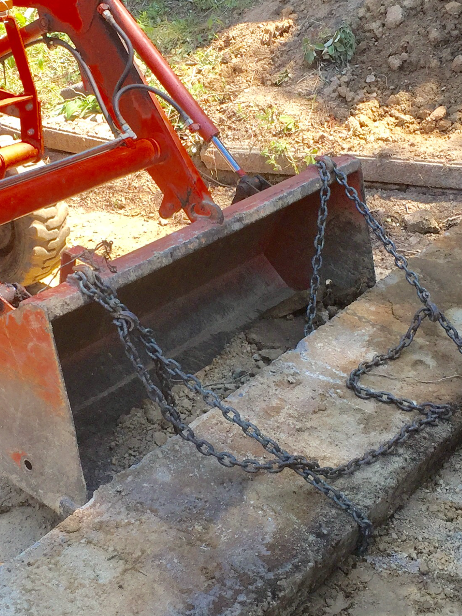

I welded a piece of 2 x 2 x 1/4" angle across the top of my bucket. I put grab hooks on the ends and a slip hook in the middle. This has worked very well for me. No bent bucket top lip here!
When using the slip hook I put the chain in one of the grab hooks. For me this set up is perfect. Never had a desire to change or modify it.

My opinion... (and this is based on if I understood your OP correctly) Since you already have hooks welded on each end of the bucket, I would use a short chain attached from grab hook to grab hook, then another longer chain attached in the center of the short chain. However, I would NOT use a ring like the previous owner used, seems to me that the ring could slide back and forth and possibly cause the load to be pulled off center of the bucket. I would use a chain that had a grab hook attached to each end, and hook to the short chain. The other end obviously would be used to attach your load to the bucket.

The center of the bucket is the least supported area of the bucket (top). The side plates of the bucket are the support and without further reinforcement.... use your most "outward" hooks you mention. "Dumping" the bucket to a point where a center mounted hook is vertical to the load is the next best thing and won't put the downward bending stress on the bucket.

I have always liked using hooks at each side of the bucket as others describe and lifting objects with a chain going to each hook. It's a more secure hold for what you are carrying and keeps it from swinging while you're moving the tractor. With a single center chain, whatever you're carrying is a pendulum that can bash into something or come loose.

Getting my B2650 work ready and have a question.
On my B7800 I have an anchor hook welded to the center of the bucket.
We do a lot of landscaping with sizeable stones and have used to center hook
for lifting and placing stones around our property. The weight in the center has bent
the top of the bucket.
The B2650 comes to us with a pair of grab hooks welded near the loader arms.
Not sure if I should buy weld one of Ken's anchor hooks in the center or use this set
up the way the original owner did. He used a 4' chain draped between the grab hooks
with a steel ring in the center for connecting to the chain doing the lifting.
Looking for some ideas as the best way to set this up.
chain in a "Y" lifts from both arms and centers on the bucket. Not rocket science.
I would change the weld on chain hooks that I put on the bucket for a slotted rail . With the rail, there is no directional limitations.
