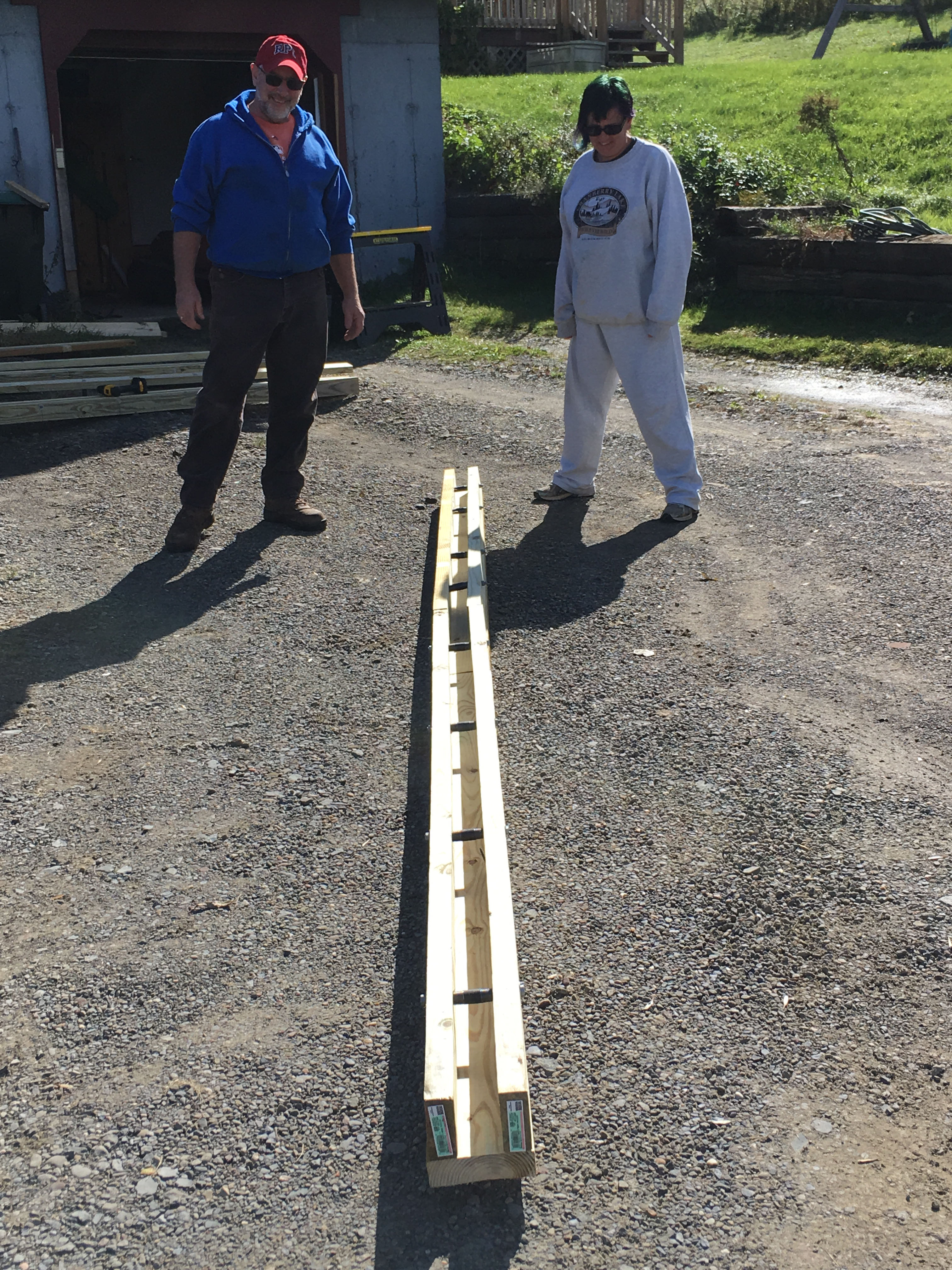

We made these from pressure treated 2x4’s and a 2x6 and 2” pipe nipples. Sunk 3 of them into my sister-in-law’s gravel driveway. They have controlled erosion really well. They can be kept clean of leaves and debris with a leaf blower. IMG_0119.jpg

We made these from pressure treated 2x4’s and a 2x6 and 2” pipe nipples. Sunk 3 of them into my sister-in-law’s gravel driveway. They have controlled erosion really well. They can be kept clean of leaves and debris with a leaf blower. View attachment 650289
Be certain to use ground contact PT.
The standard PT from the big box stores is usually junk.
You need .60 CCA treatment
I built one with a 2x10 and a 4x4 on either side allowing a 2" trough. Pricey but very strong.
