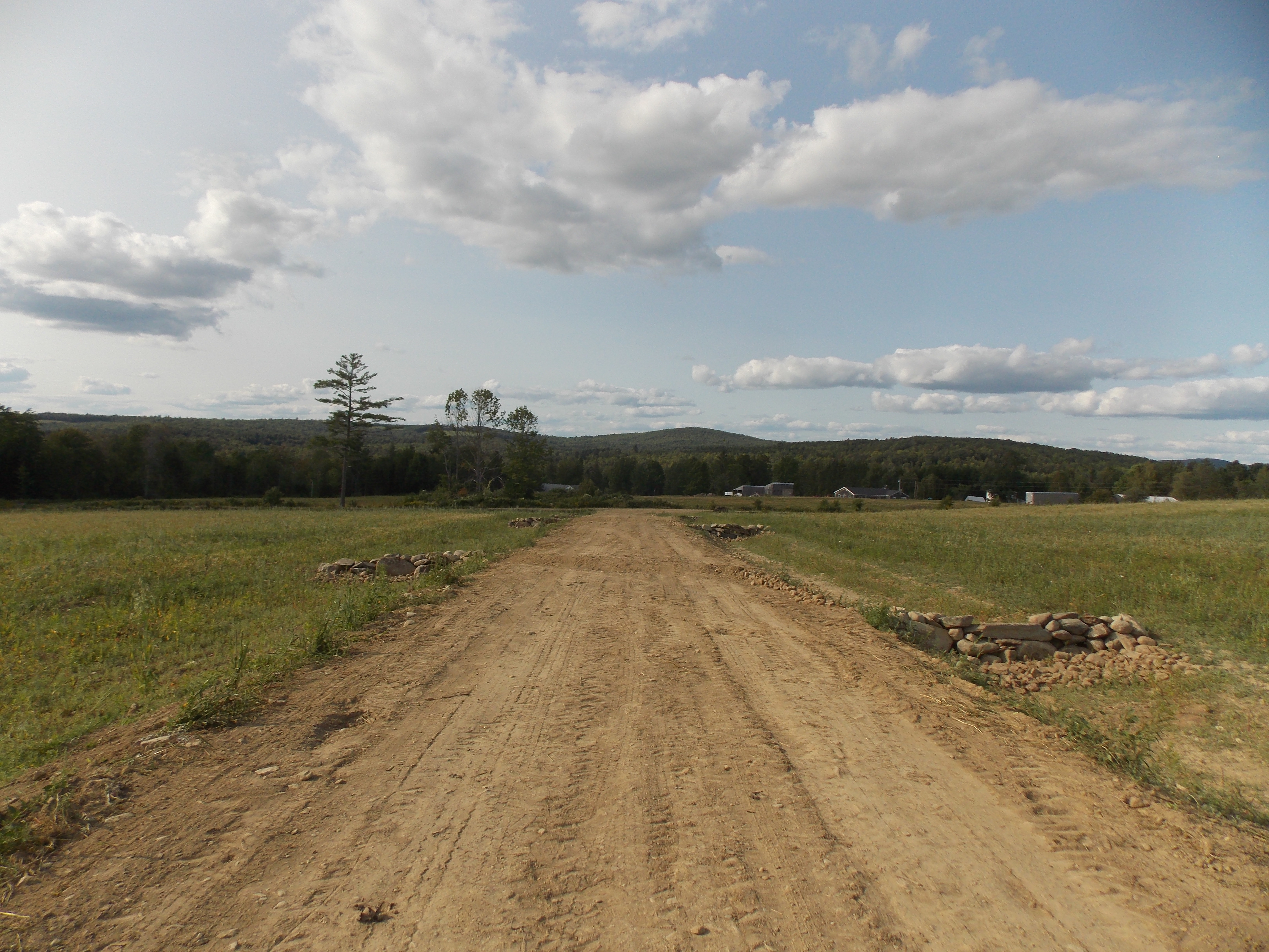

I just use earthen humps on an angle, terminating the downhill ends with rip-rap to keep erosion at bay as it diverts road surface water into the ditch. I then put an rock check dam in the ditch, across the ditch, to prevent ditch erosion. (These can be seen in the photo)
I do that just because I plow my Heavy Haul Roads all winter, and figure if I plow them out, I can put the angled swales back for free, instead of having a rubber razor or box culvert to replace at a cost.
I think it looks professional, and is functional, but what "looks good" is subjective.
For what it is worth, this road, on a 9% grade, in soil characterized as Highly Erodible Soil, was approved by the US Dept of Agriculture, and met the Federal Soil Engineer's specifications for this road. The right side rock check dams have nothing to do with the swales; they are just for ditch erosion control, but the left side is just for erosion control of the water being diverted to the ditch by the swales. Just as a note, this road looks flat, but truly is a 9% grade, which is about the maximum a truck should be climbing/descending. The photo is an optical illusion.

So you just pile up the material at an angle across the road and pack it in? I like what you have and it’s what I looking to do with rock and crush and run material. I’m interested in exactly the process of making the swales in the road to stay and not wash over time like you have. Thanks

So you just pile up the material at an angle across the road and pack it in? I like what you have and it痴 what I looking to do with rock and crush and run material. I知 interested in exactly the process of making the swales in the road to stay and not wash over time like you have. Thanks
You can make it two different ways, depending of course on what you have for equipment.
1. The first way is to take a backhoe or the bucket of your loader (it does not have to be a big backhoe) and scrape the road down from the uphill side, to the bottom. This creates a berm. That berm should be about 30 degrees of an angle across the road. Then just take a garden rake and rake out the berm so that it is a smooth transition. It does not have to be a long, deep berm...water will take the path of least resistance, and obviously drain downhill.
2. If you do not want to scrape down into the road, then you can always just form a berm at the 30 degree angle, by hauling in gravel and placing it across the road. Then raking it out so that it is a smooth transition.
I think mine are something like 6 inches deep...maybe 8 inches at most, with the berm tapered back by four feet on the downhill side of the road. Just be sure to rip-rap where the waterbar terminates in the ditch because it channels an amazing amount of water in that one spot.
I thought my truckdrivers would complain as they rode over the (4) waterbars that I put in, but when they never complained (and truck drivers ALWAYS complain), so I mentioned it, and they said they never even gave it a second thought. And they were rolling over them with 100,000 logging trucks.
