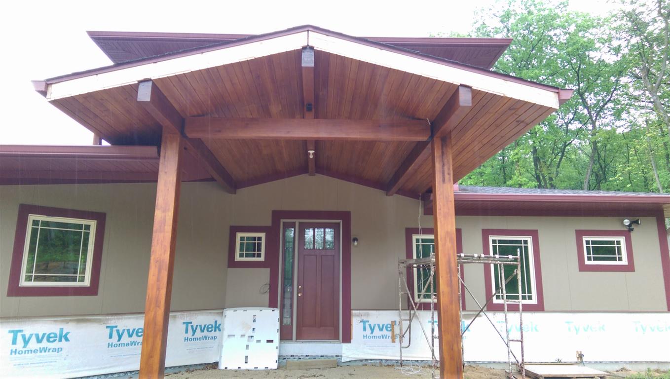

   / How to mount T&G wood on ceiling... #15
I used a pneumatic stapler on the tongues. Just did it at an angle back towards the board a bit so it didn't interfere with the next board fitting over the tongue. Next board covers it up. Been up in my outside decks and entry ceiling for 2+ yrs now. No issues.
