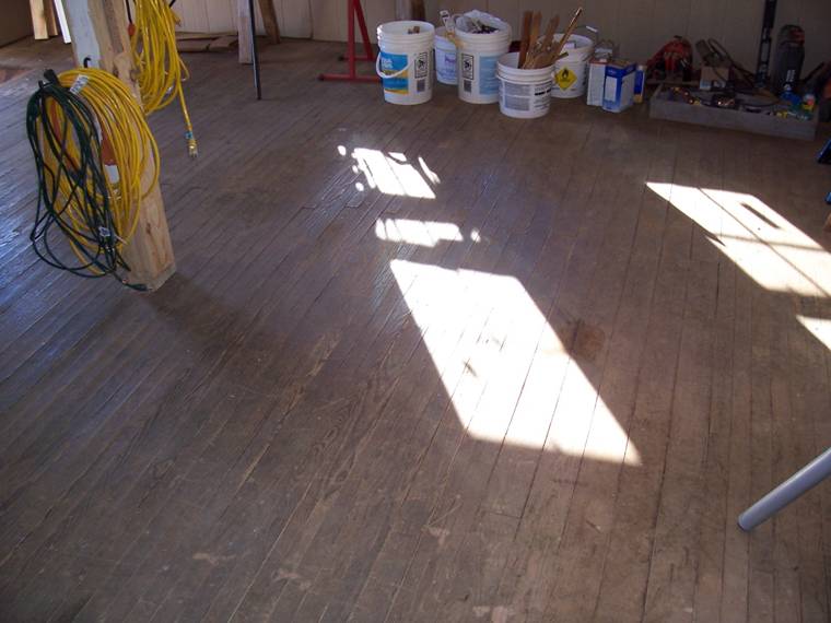

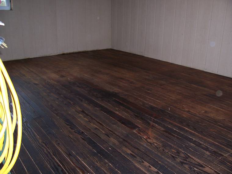

smstonypoint - that looks very nice and the white paint job helps with the illumination. OH, MY - I just noticed - is that a solid oak floor. I do like that and the dark stain you used on it. I don't ever remember a shop being so clean - I think that's cleaner than my kitchen.
Thanks for the kind words. Here are before and after photos of the floor. Dad used cull T&G boards left from building the family home and/or other houses that he was remodeling (or building) at the time he was building the outbuilding. I rented a pad-type floor sander to loosen the dust and grime that had accumulated over 70+ years. I didn't use a belt sander because I wanted to maintain some of the floor's patina. After sanding, I applied an exterior Cabot stain.
