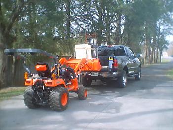

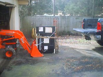

The BX's FEL is rated to handle the weight to full height so it boils down securing it properly.
Heres a few pics of my BX23 lifting approx 150 lbs (stove + dolly) to approx 3'. I have chain hooks on the FEL and used a chain to secure the load back into the FEL. The BX lifted it effortlessly. I wouldn't hessitate to try to lift the 250lb air compressor.
Good luck
