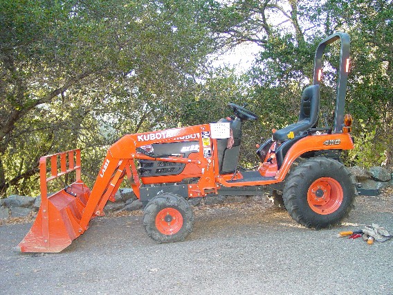

The weight is no problem. Last year my wife wanted a 540lb fountain she found at Costco. I moved it into the backyard with the BX loader (be sure to hook up the box scraper for counterweight). The problem is having it tip over when curling the bucket. The BX bucket is only about 18" high. I added a "backrest" to the bucket similar to what you find on quick-attach forks. Every week, rain or shine, I haul our garbage cans up the driveway to the street with this. Two of the huge cans fit perfectly side by side in the bucket. I've had this setup for 5 years now and I've safely moved a lot of stuff I couldn't otherwise, including a full size refrigerator.
Probably overkill for a one-time use but you could easily move a vertical air compressor with this.
