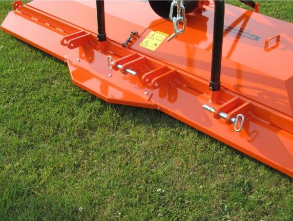

Mount your 3-point A-frame on a sliding tube. Here's the first example I found.
https://farmimplements.com.au/implement/h-range-rotary-cutter/
Or make a set of alternate mounting points like this. The pins are in the offset position.

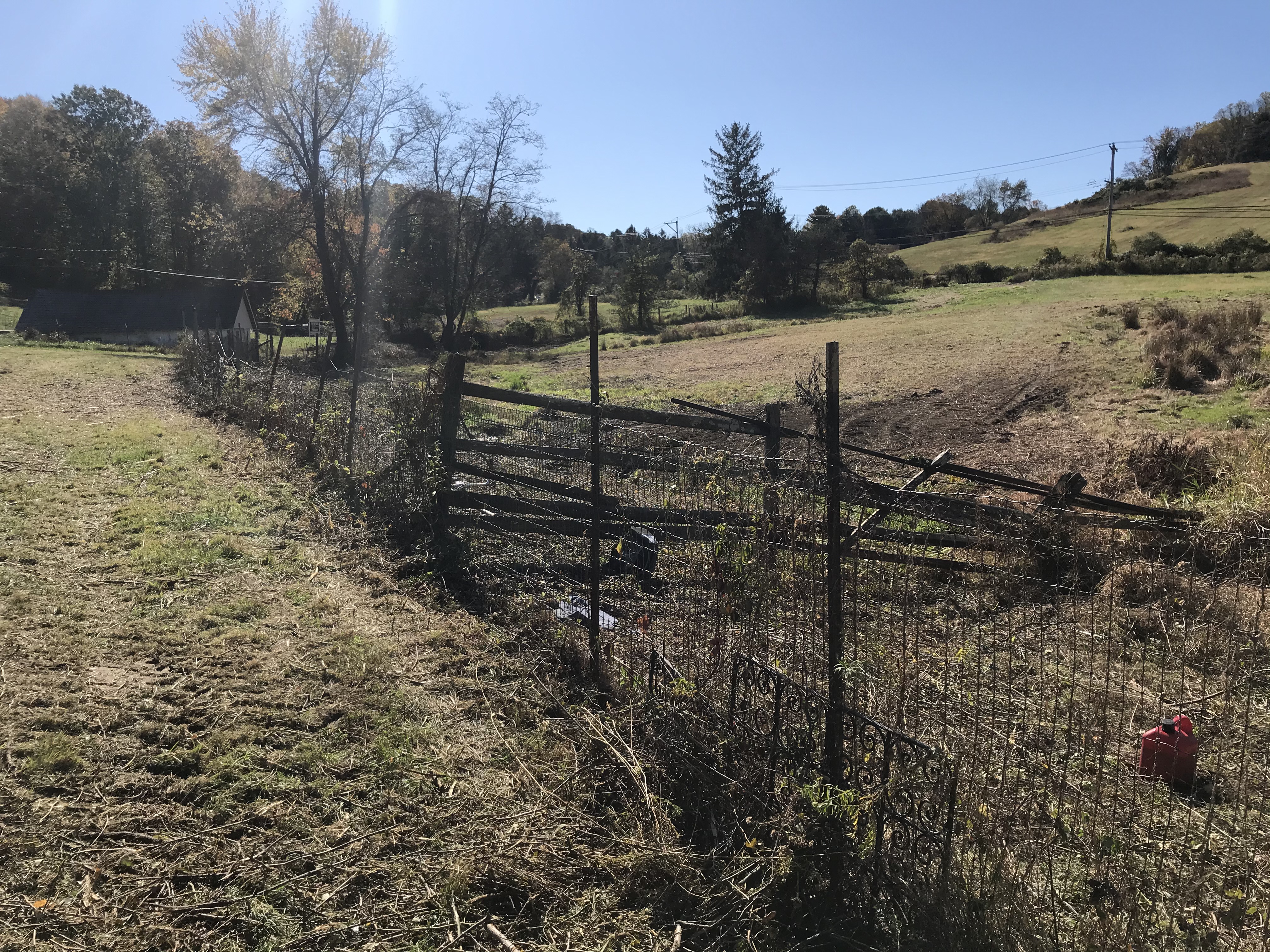

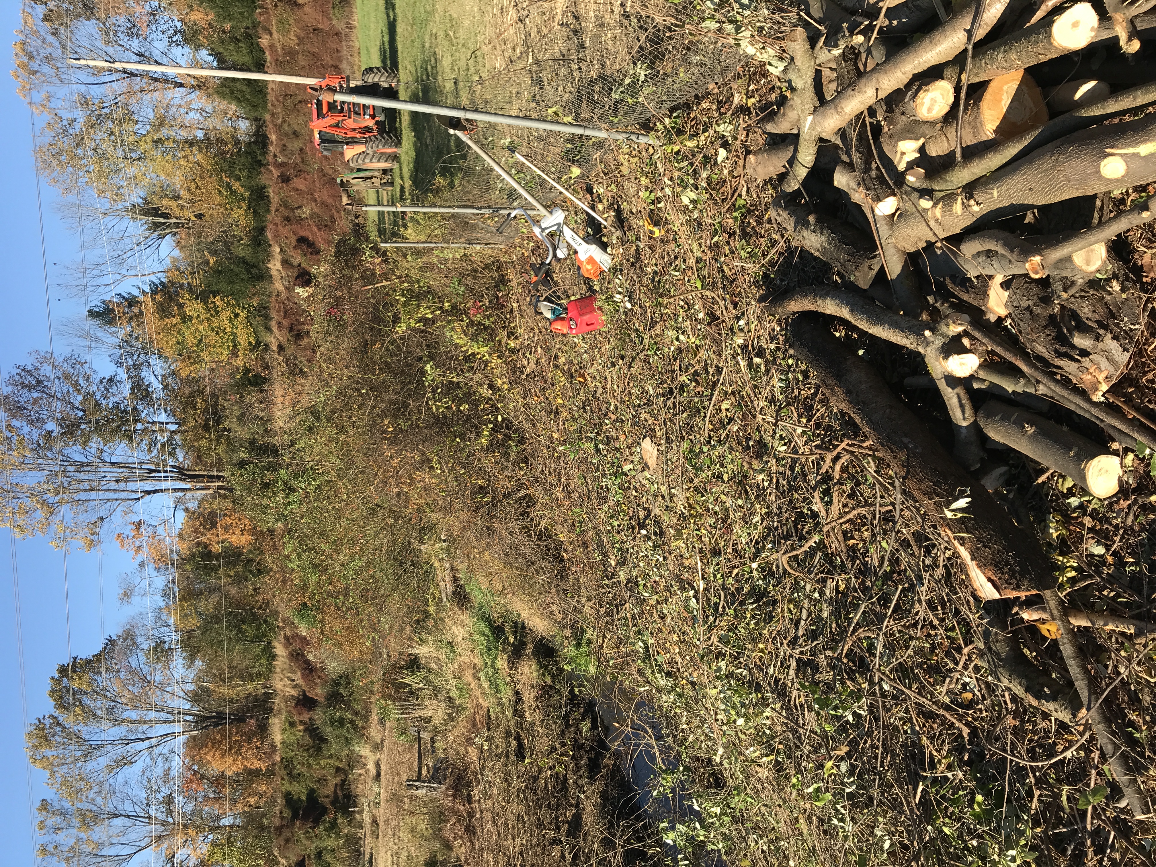

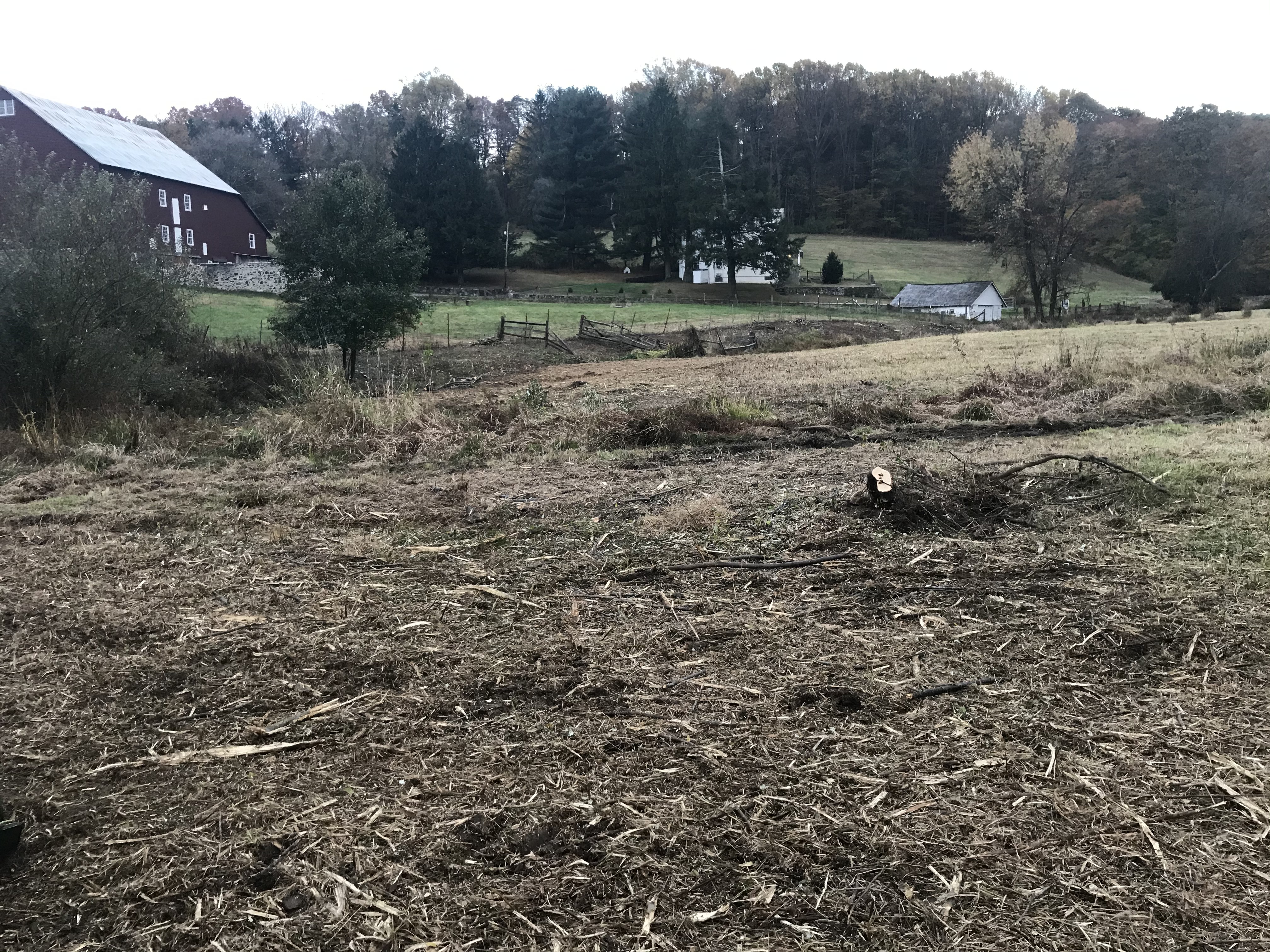

I have(had) a very similar problem.Six foot brush hog and loosing cab lights.With my brush(10-12' tough stuff) backing in just lifts the hog up+I have miles of hedge rows and backing in isn't practical.
I hired a Skid Steer and FECON head and he beat back mine and now I can keep up.
I do this for customers.
I rent a machine and cuts back years of field overgrowth. It's expensive, though. Cheapest weekly rental I could find was $3000/wk. Ssometimes I can use the wing of my CX-15, but even with 4-5' of overhang, it's not enough.

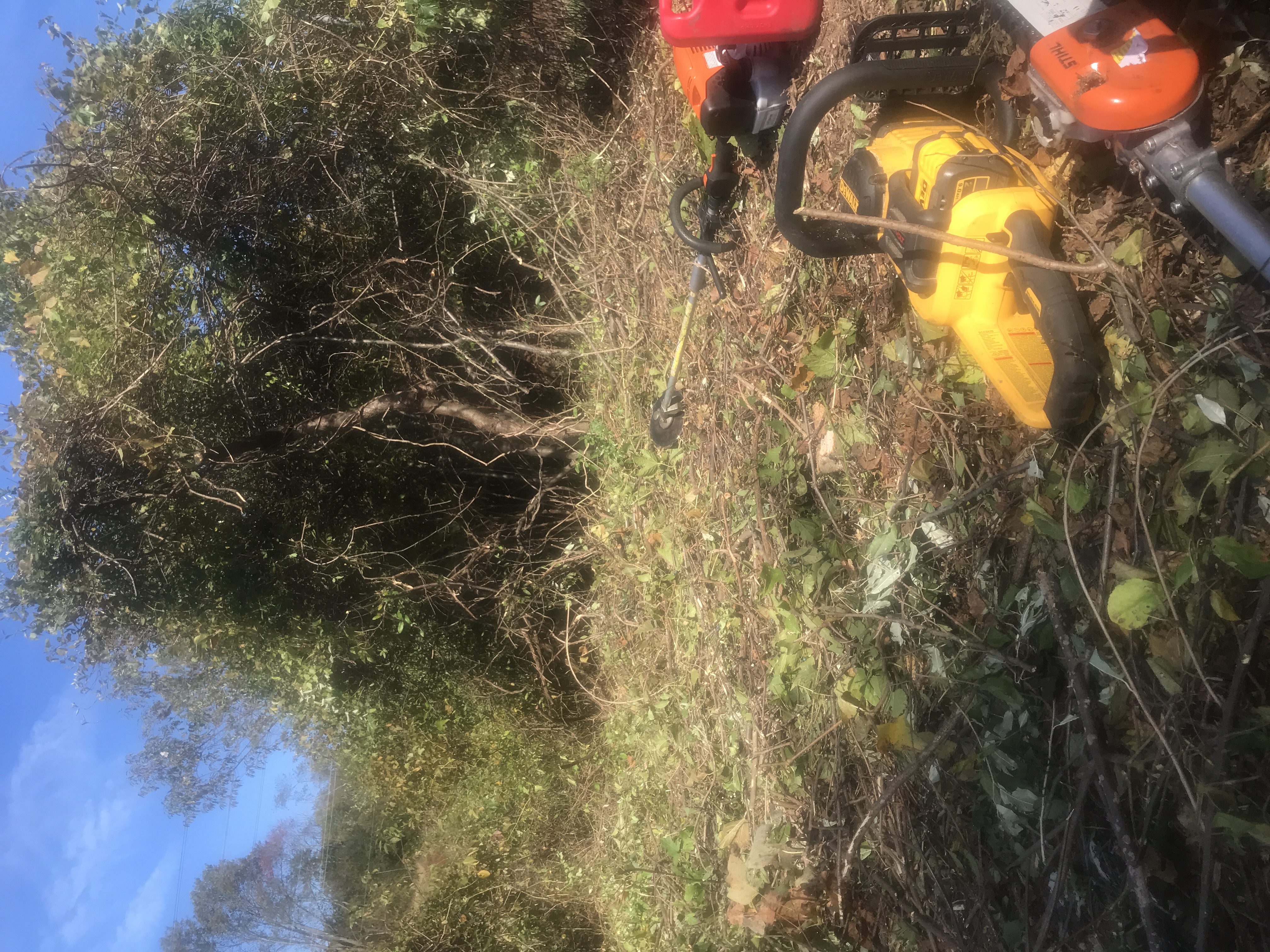

I had to do some of my own fields over the years and I'm really cheap, so reluctantly I bought a Stihl FS560 brush cutter and cut the brush myself (mostly autumn and Russian olive, stickers and vines). I pull the brush pieces into openings where I could pile it up in small piles, then grind it up with my Kubota M-135x and 15' Deere CX-15 into wood chips. If the chips end up in the field, I take the hay rake and whisk the chips off the grass and into the woods.
I have had a lot of success doing this and have turned at least 30 acres of wasteland back into the productive farm fields they once were. I'm doing a large area of brush now. It's been fantastic exercise for my health and I'm gaining more and more bales of hay, so it pays for itself in the long run.
Sorry for the sideways picture. I find this website incredibly difficult for uploading photos.
