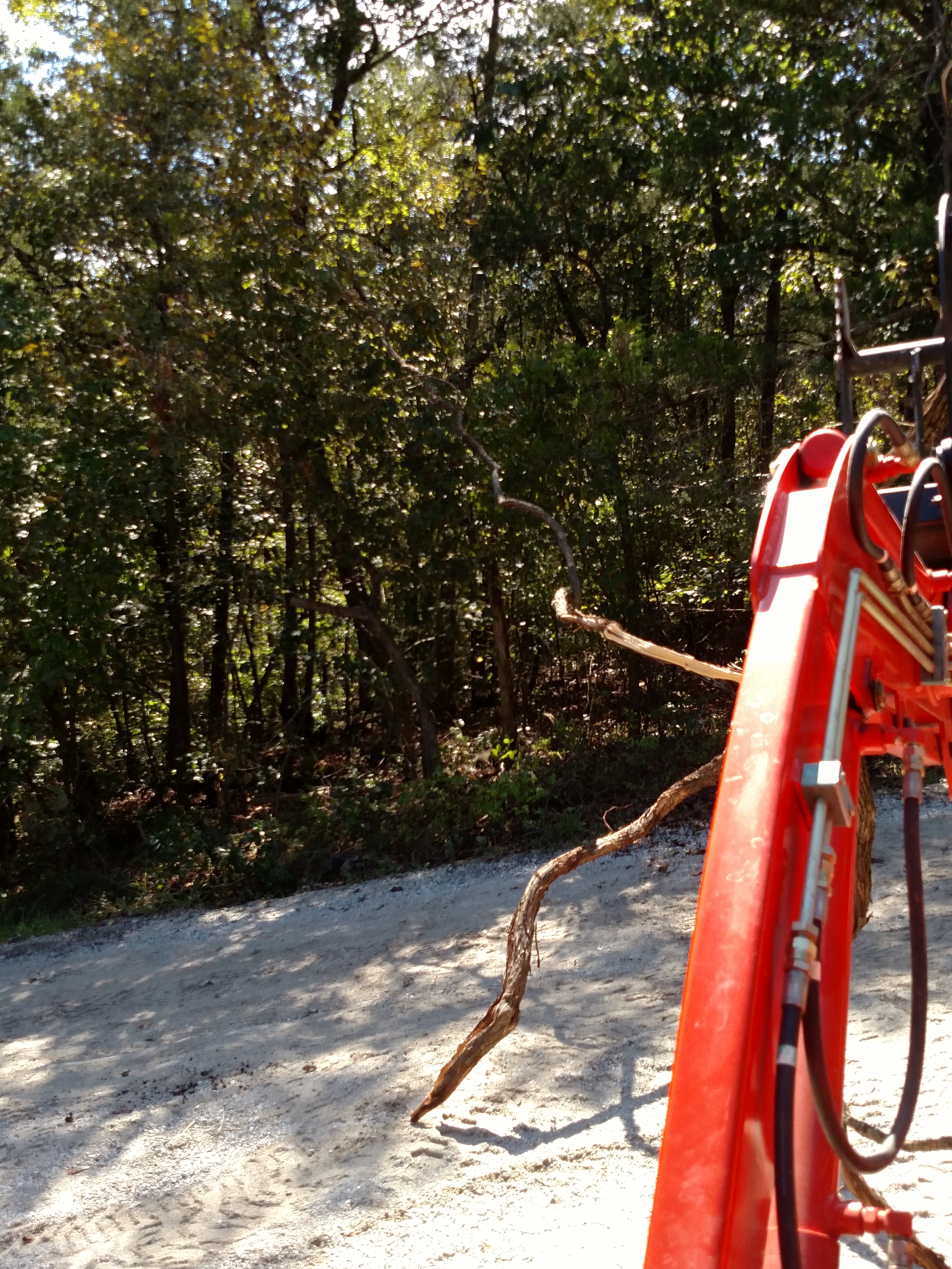

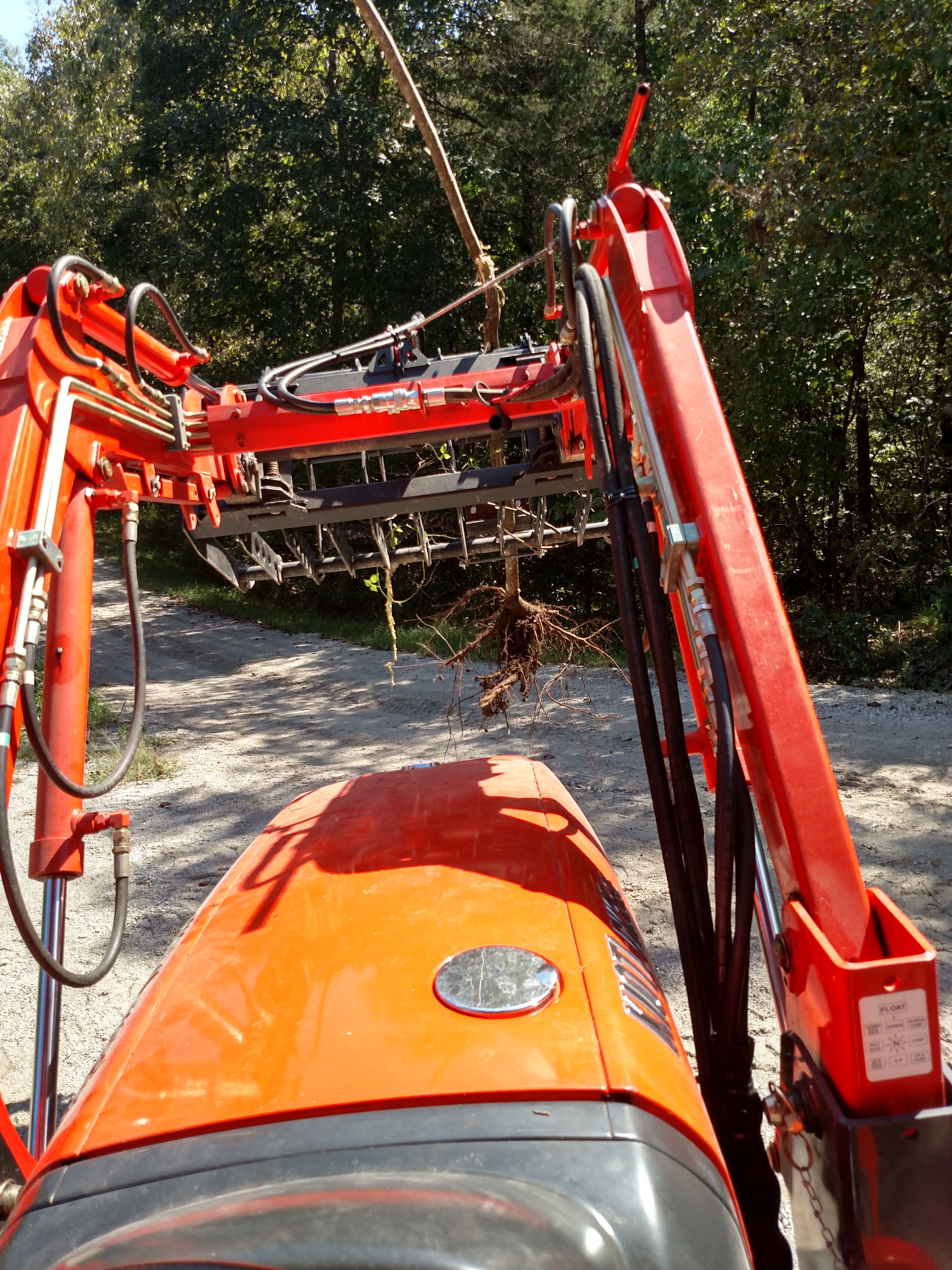

I'll add a few things not to do.
Don't try and dig huge boulders out, like this
And don't try and pull out stumps without digging around them first the cylinders will bend and break themselves like this
View attachment 508602View attachment 508602
To echo what was said before, not a bull dozer, and build up your grill guard, the grapple is one of the handiest tools I've ever used, but it can lead you into things you shouldn't do with a FEL.
Enjoy!
As previously said, just go slow, if you see the loader flexing STOP!
The non removable loaders on the Kubota TLB's are quite a bit more rigid and tough than the removable loader attachments.
It was a wise decision to buy the L39, as I'd have gone thru several tractors otherwise by now. I have a Max28XL with a very strong little loader, but I am careful not to abuse it as it is not structurally rigid. The KL401 Loader appears a stout loader. That must have been some stump.
   / How to not damage your FEL #44
It was a tiny stump, with a giant idiot trying to get "the last obstacle" in a trail building project cleared! I had the curl all the way extended and try to push with the tractor. Happened in a flash going from bent to broken with an exciting rush of released hydraulic fluid under pressure. All I could think was "maybe just a hose"...
