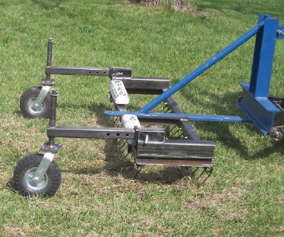

I use a 3PH dethatcher that I built a few years ago. I take the gauge wheels off, and I can back up and stick the rake under the tree, drop it down and drag a big pile of needles out into the open. Then I load them up in my FEL and dump them.

gizmo111, my rake is five feet wide. Measuring from the bottom & tractor side of the "L" tine support piece the forks are three feet long spaced six inches on center and the rear rack is three feet high. This is a nice size for the BX and works great for pine needles (but oak leaves are a bit of trouble). Build yours to suit your tractor size.
Thank you for the great info and especially the picture.

Thank you very much RedDirt for your reply and of course the pictures you posted earlier. I am going to build one like you did as it can be used as a rake and a loader. Thanks again for sharing.
