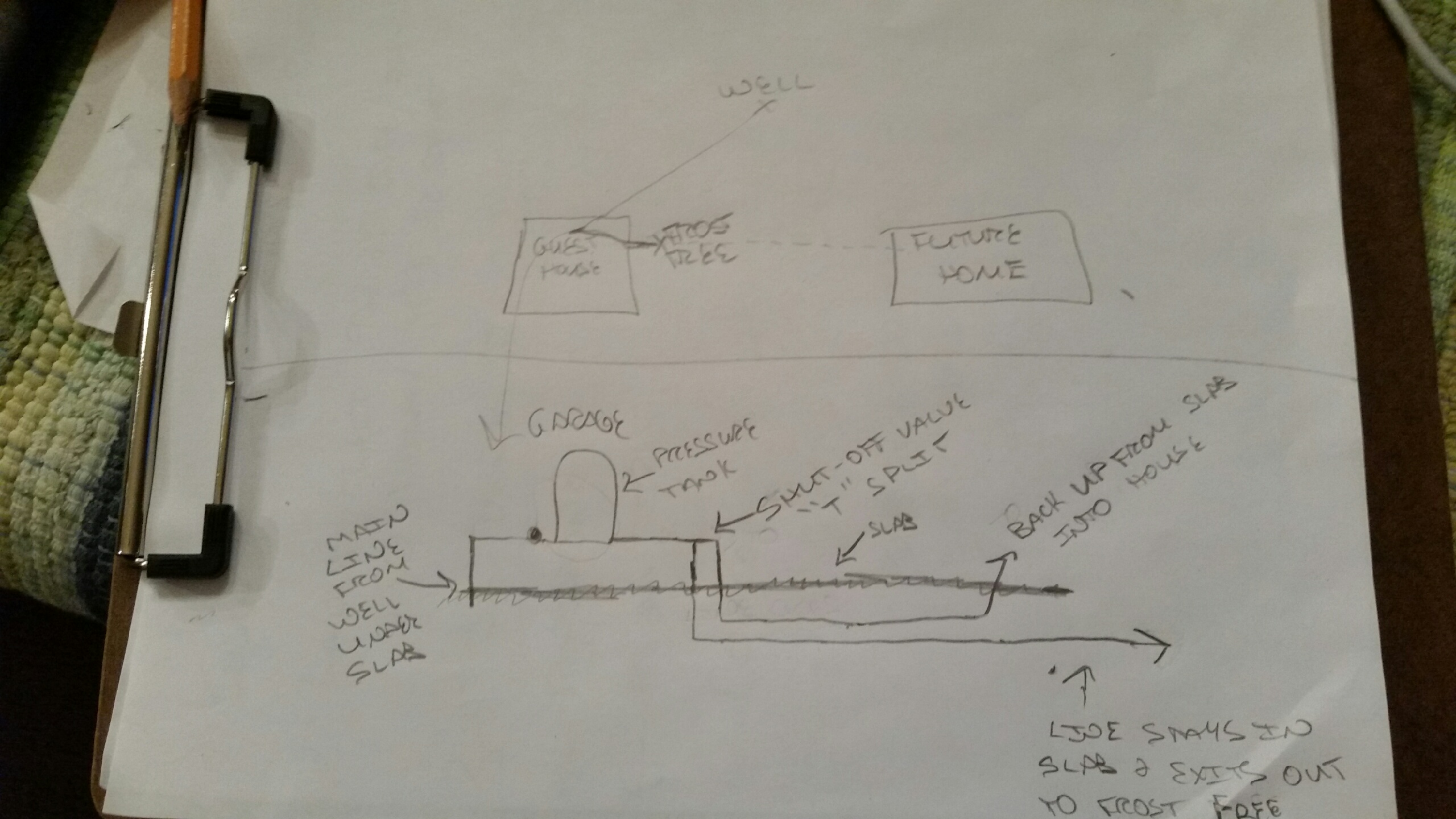

I am going to use SharkBite connections so I don't need the special tool to expand the PEX.
You only need the special expanding tool for Upondor. Regular Pex only requires a tool to crimp/clamp the rings but both are costly for one time usage when you get beyond 1". How much is that special sharkbite fitting going to cost you? I am curious since the small ones cost a pretty penny. Sharkbite fittings are nice and we keep them stocked in our truck for special occasions.

The bigger the fittings (1"+) the more they cost.
The 1 1/4" male adapter for the pitless is $23
The 1 1/4" tee is also around $23
Once nice is that the fittings are easily removable if needed without having to cut or splice. Just use the removal tool and done.

Friction loss is one of the reasons we ran 1.5" mainline for our 1,000 feet that feeds three houses and a shop. Of course, since we are in Florida, we ran PVC and don't have to worry about the "freeze" or "ground thrust" do to changing temps
Home Depot and Lowe's doesn't carry 1 1/4" CPVC. Will have to probably purchase online.
SharkBite fittings only accepts CTS CPVC, not PVC
I want to use around a foot of SCH40 CTS CPVC at the well pit area and then transition to PEX.
Tan color collar is for Pex Pipe
http://www.homedepot.com/catalog/pdfImages/e5/e508b263-1af2-4277-80d9-5be1a84405fc.pdf
2016 Catalog
http://www.sharkbite.com/sharkbite/wp-content/uploads/SB_Catalog_2016.pdf
2XL fittings
Large Diameter Pipe Fittings & Other Large Bore Fittings
http://www.sharkbite.com/sharkbite/wp-content/uploads/SB_2XL_SpecSheet_010112.pdf
The place to buy one and you will need a different insert for Pex
SB113532M - SharkBite SB113532M - 1-1/4" 2XL SharkBite x Male Adapter
http://www.supplyhouse.com/SharkBite-SBTL35-1-1-4-PEX-Insert
