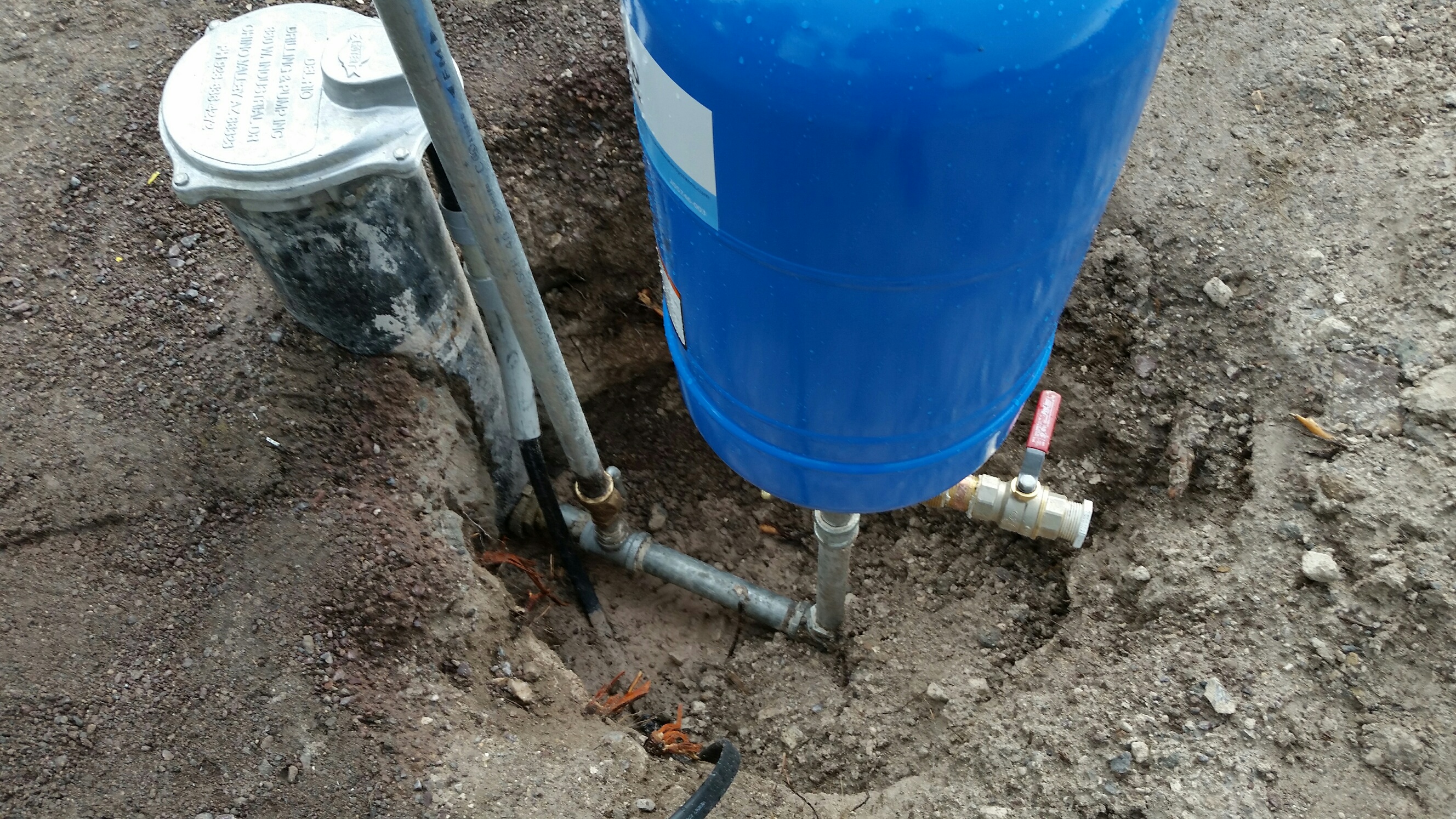

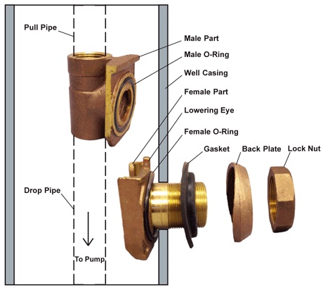

Just need some info before I dive into this job.
Looking at the below photo. I want to remove all the galvanized pipe up to the pitless adapter. I can do that without any worries of the pitless adapter coming loose in the well, right?
The large brass nut at the pitless (see photo) will be held in place with a wrench and then I plan on just unscrewing the male galvanized pipe that's currently threaded into it. Then it will be replaced with a 1.25" brass SharkBite male adapter. See photo.
On the brass threads do you typically use pipe goop or teflon tape?
   / How To Plumb Well Water Lines for 2 Homes #59
Don't hold the brass nut but the fitting the brass nut screws on to. As long as you don't unscrew the brass nut off the fitting the pitless will be held tight to the casing. Teflon tape or pipe dope either will work. I use both with the tape first then dope over the tape. In my opinion Teflon paste is too slick and doesn't let the fitting get tight.
