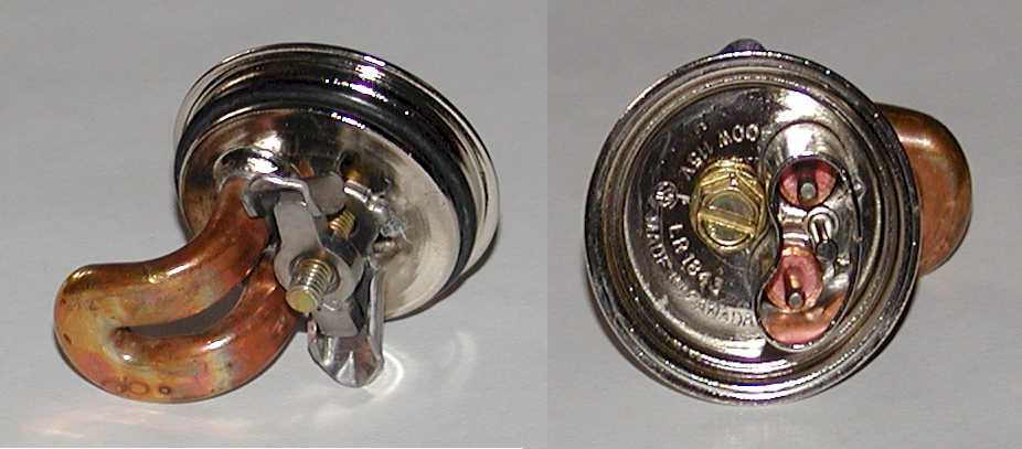

Here's a picture of the block heater for a TC25D. The electrical cord plugs into the 2 posts visible in the right hand picture.

Thanks for the info on the heater. Look forward to the picture.
