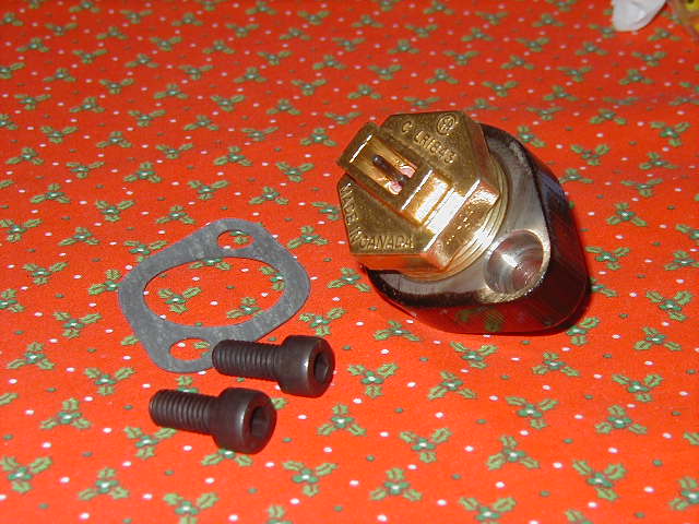

djradz ,
Thanks for the effort. I do have some good/bad news to report.
First the bad news :
I went with the JD part as described eariler
Now the good news :
Because the dealer did not give me all the correct parts or info to begin with , they did not charge me for the adapter. :)
The freeze plug that this uses is the one on the opposite side of the block as the starter. It is a regular plug with 2 screw sockets for the adapter to screw into , then the heater threads into this. Pic attached. Once I get it installed I'll post a pic.
Just a heads up for other JD owners who go this route.
Mark

JDGREEN4ME ,
Below are the JD Part Numbers. The freeze plug location is on the right side of the motor as viewed from the seat. Just above the throttle linkage towards the back. It is a bit crowded , but the plug has 2 screw slots next to it for the adapter.
AR871167 - Block Heater 400W $50.00
AM101390 - Adapter Kit - $42.00
Hope this helps. I'll post some more pics as I do the install.
Mark
