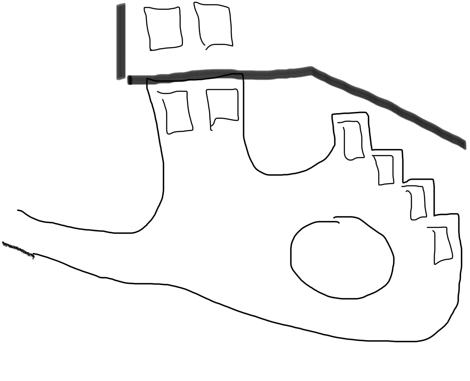

Do you have room for a circle? The house I grew up in, my father put in a nice circle with a planter in the middle that was about 20-25' across. You'd drive in and go around to the right. There were 4 parking spaces off of one side of the circle, and an entrance to the carport parking pad a little further around. It was quite attractive, you could have up to 6 cars parked and still drive around the circle and out, and nobody was blocked in except any cars already in the carport. It was about 200' to the road. There were also a few parking areas off to the sides of the drive, as well as along the road, as my folks liked to entertain a lot.
Roughly looked like this. (don't laugh, looks like a priceless Picasso :ROFLMAO: ).
