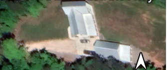

Unfortunately the front yard slopes too much for a circular drive and I don't own to the right of the drive.
   / How to Prevent Amazon, UPS, Fedex 3 point turn ruts? #22
Just off the edge of the apron behind the dark colored vehicle, downward in the pics, gravel to the trees. Enough area for the delivery truck to back into and turn around?
That is all clean gravel, it is wide enough to drive a dump truck down the right side of the garage to the back yard.
