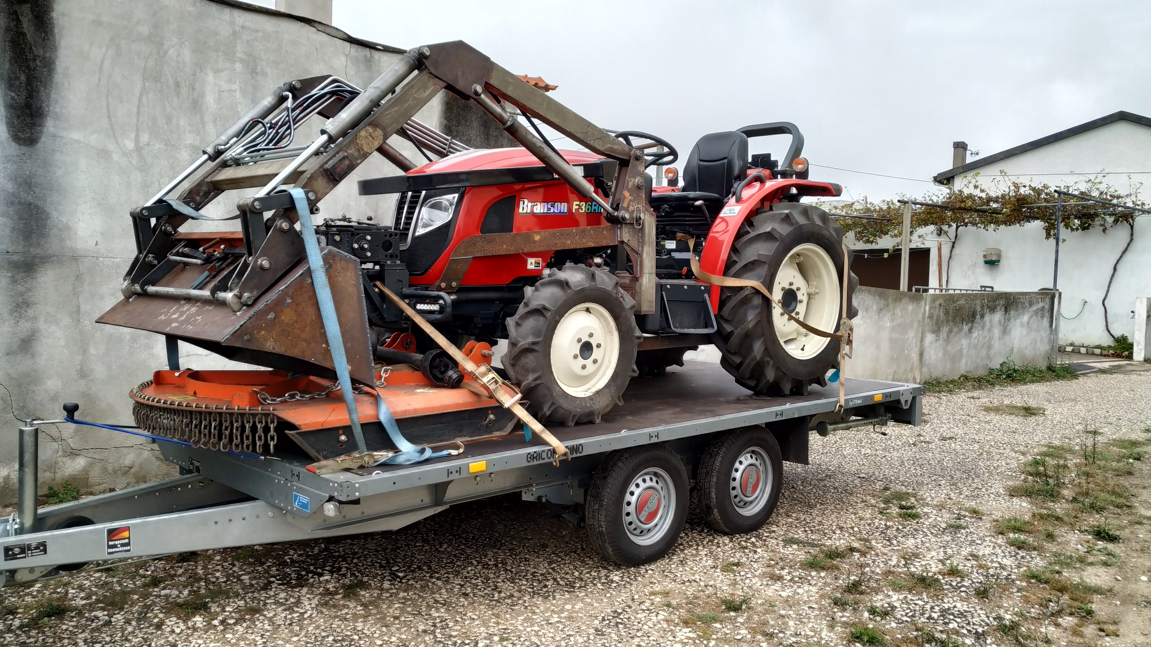

As Rock Crawler said, it's indeed a weight and balance thing.
Play with the setup till you have it just right. Even if that means stopping in the middle of a trip, to readjust, BTDT. Don't get the laziness get over you and disconnect the implements if necessary. I see most people will have mowers just hanging out the back, without any real reason as of why.

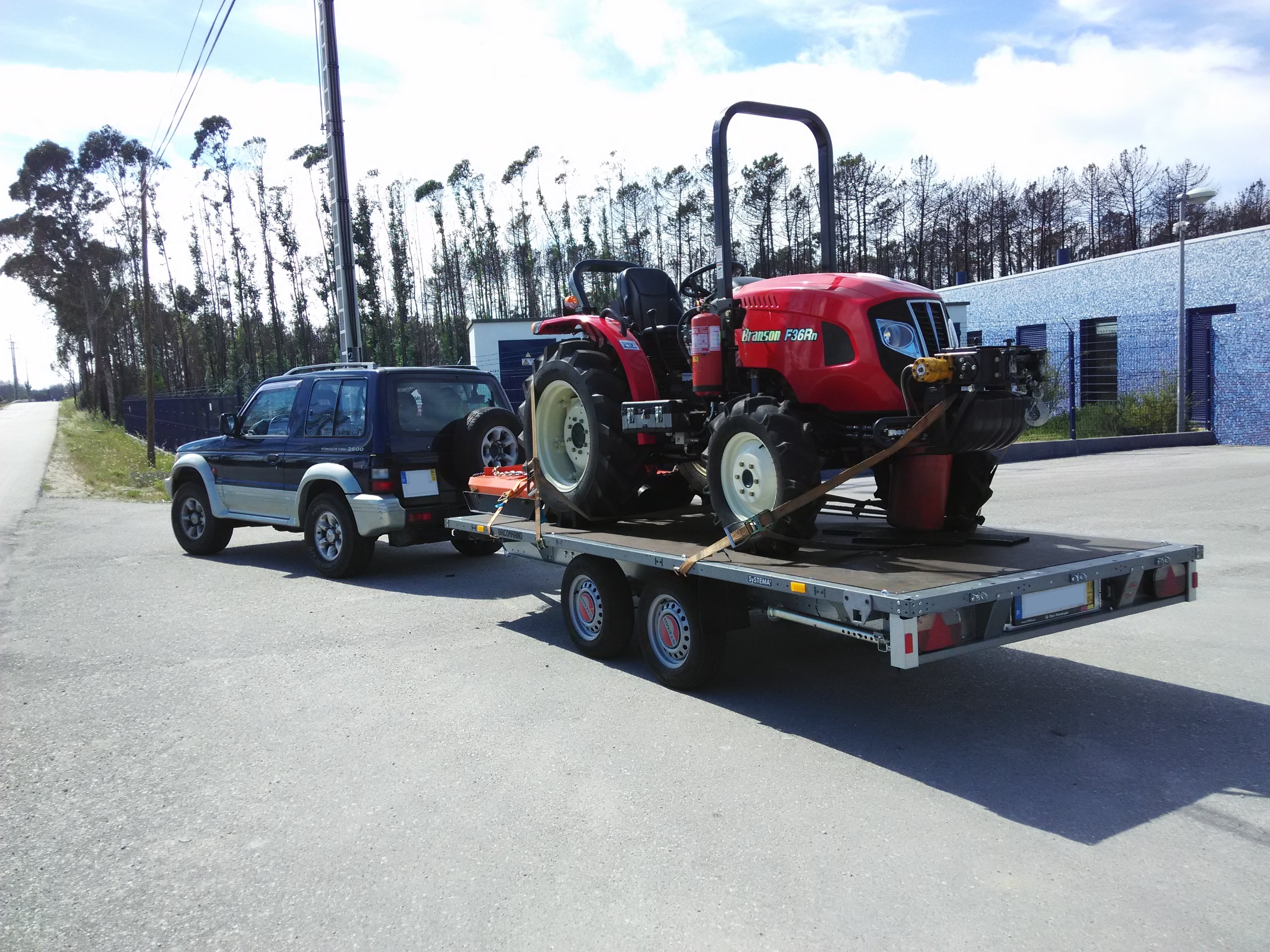

It's actually more stable than it looks up to 90 kph. Never went much above that.
The only time it got a bit sketchy on me was because I didn't load it quite right. Moved the tractor about 4 to 5" forward and everything was nice and stable again.
I've since replaced the 4x4 with a 2010 Mitsubishi L200 pickup truck as I got a good deal on it. Lost about 100 kg of towing capacity, but allows me to put an implement on the bed and relieve the trailer a bit more.

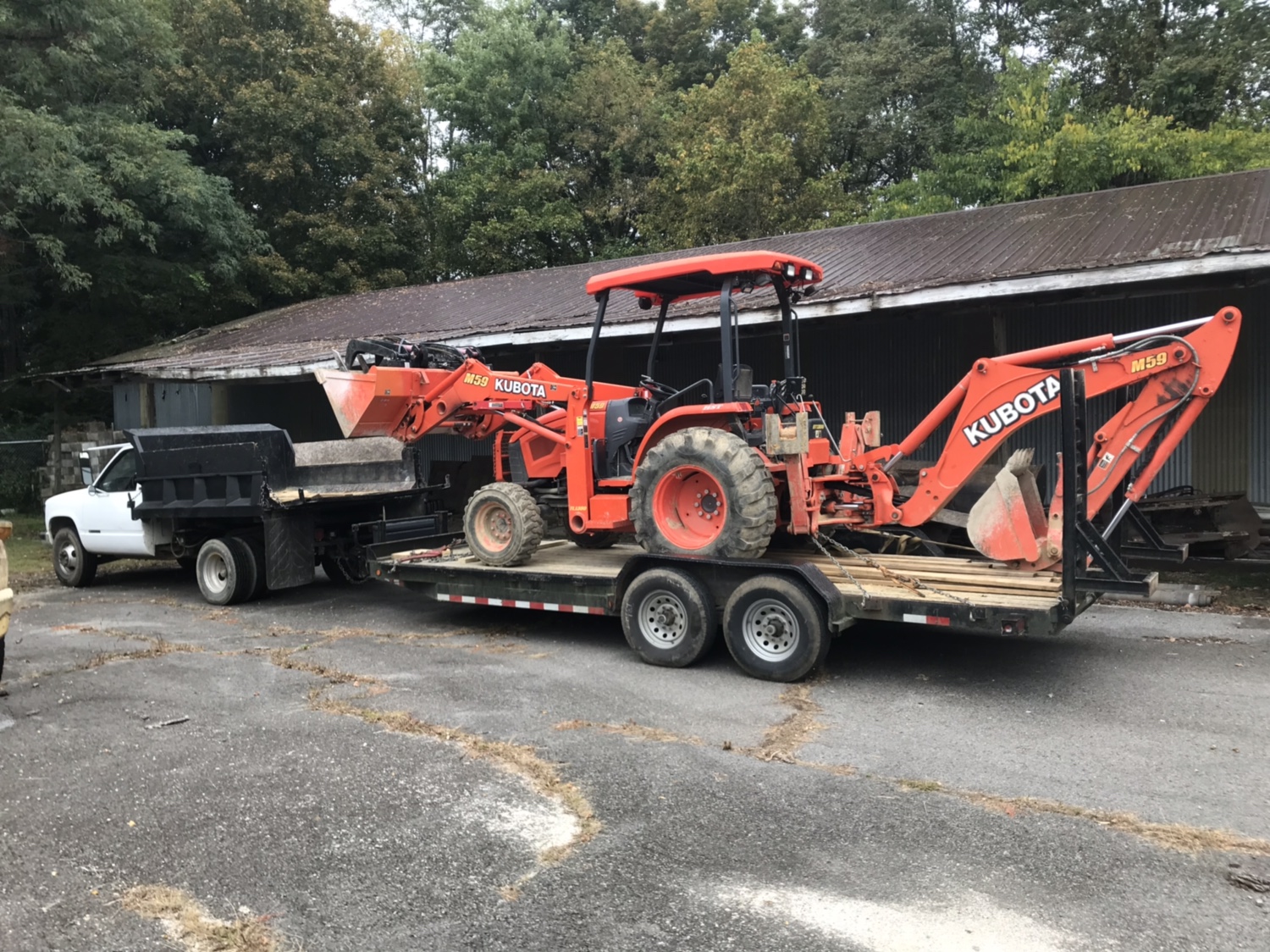

What’s the weight distribution on your tractor? My M59 sits very back heavy. I have to pull the rear tire forward of the center of the axle to get satisfactory tongue weight. IMG_9144.JPG

Not sure. It’s 7999lbs now and I’m about to add 300lb bolt on weights to each rear wheel and add a cutter bar on the bucket. That will put me around 8600lbs plus the weight of the cutter bar. The bush hog is 10ft long and weighs 1025 so total load will be under 9700lbs of payload. Might just have to make multiple trips lol. My buddies truck can only haul around 10k on the bumper, same as mine. Class 4 hitches. His has rails for 5th wheel, mine is just bumper.
Massey Ferguson 98 I have is 9500lbs just the tractor. So either way I’m towing 9500lbs of tractor whether I add weights to my tractor or not.

With the loader on, it's gets a bit front heavy with all the front weight and winch sitting there.
Also, note that European trailers have the axles centered with the bed of the trailer. I do have to pull the tractor a little backwards so I don't end up with too much tongue weight but at the same time, I have to take the implement off so it doesn't hang out the back.
Most times, I just measure the distance between the rear wheel well to the ground unloaded, then load it till it drops about 2 to 2.5". Seems to work well and I get a stable rig.
