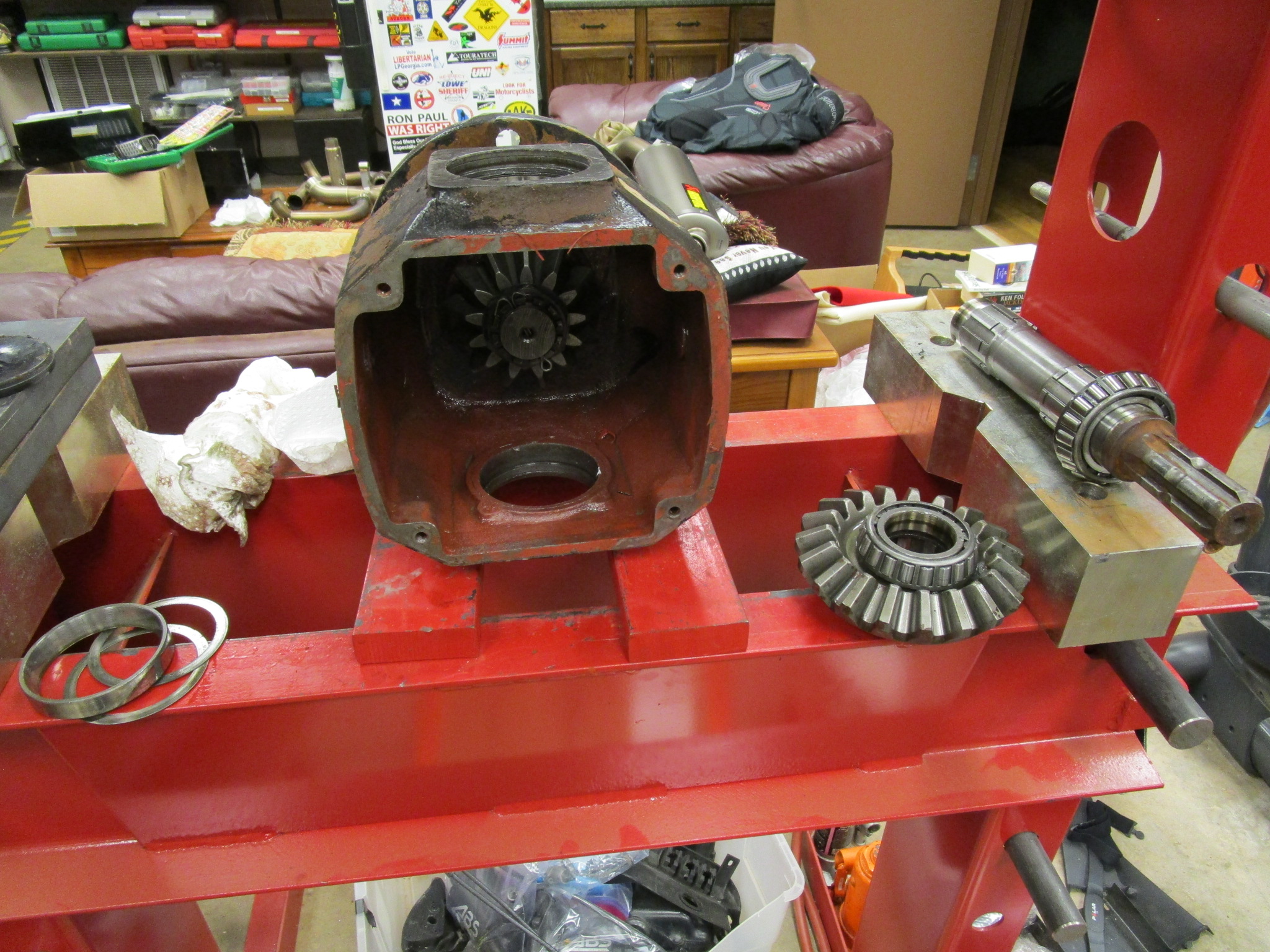

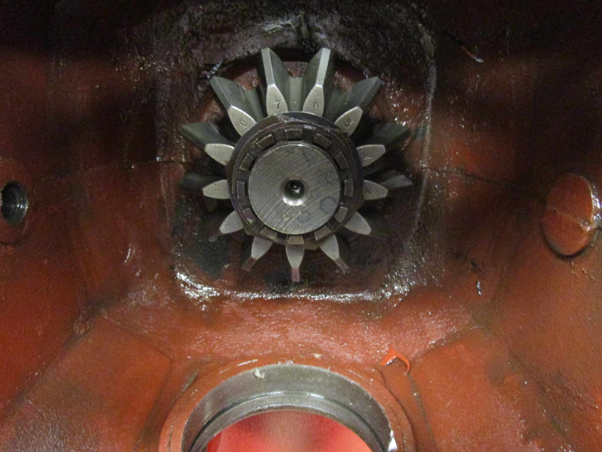

Well, it is clear now how to disembowel the beast...
In addition to the parts I had on order, the input shaft bearings, seals, and end cap will need to be ordered. I also had to order a 55mm 6 point socket to remove the output shaft nut.

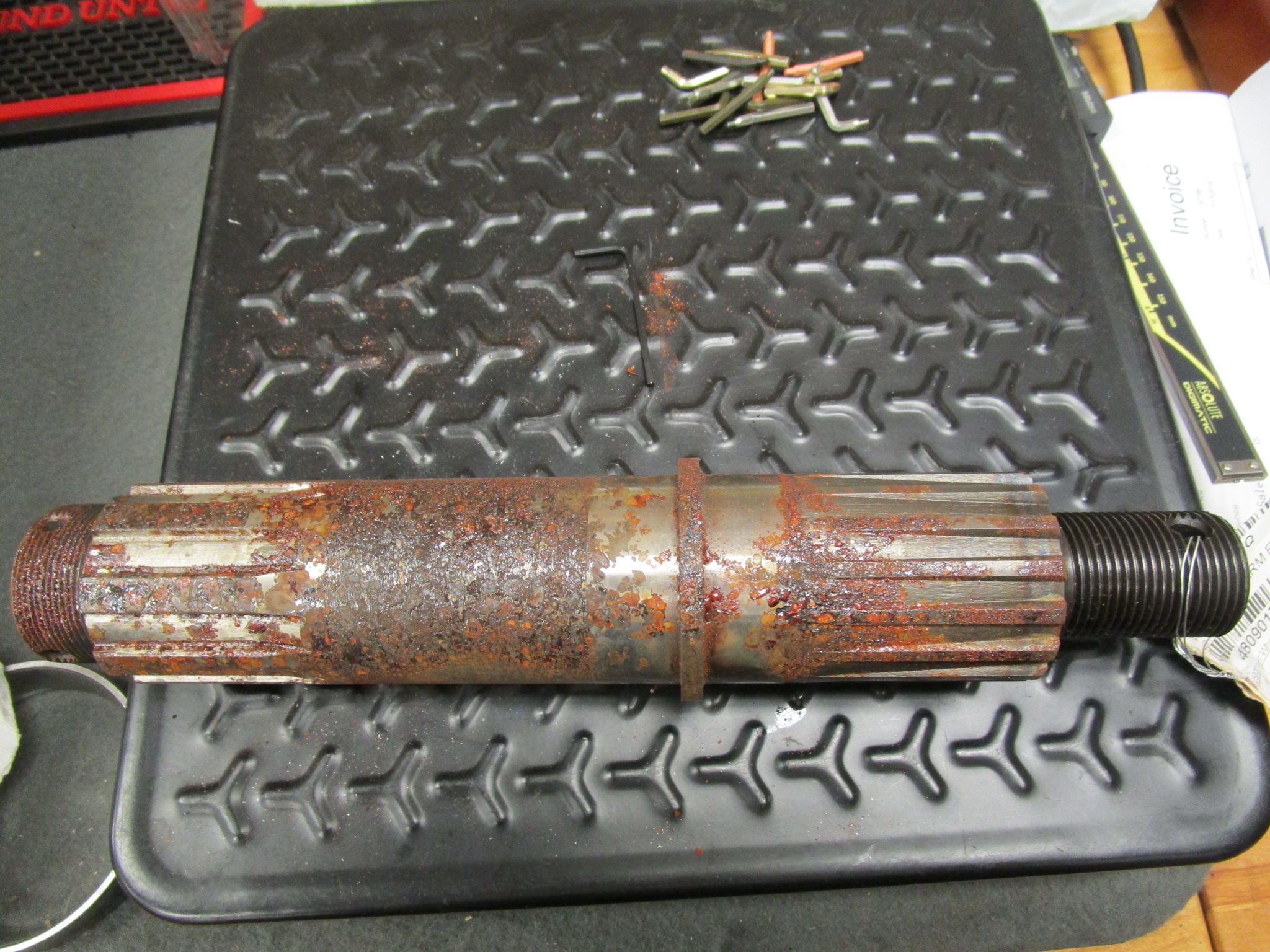

I opened up the box of parts I got from Messicks to find this surprise for the condition of my new output shaft, so back it goes....
I still have some level of uncertainty about the reassembly. I'm told that the shims won't change with new bearings and can go back where they were. A Bush Hog tech told me to pre-load the output shaft by tightening the 55mm nut until the moving torque on the shaft was 6-8 ft.-lb. without the shaft seal. That is straight-forward. Less obvious is how one would ever set the preload on the input shaft bearings. It is entirely by shims. I'll just hope that my guidance was correct and that no shim changes are necessary.

Holy smokes! That's really putting the OLD in New Old Stock!
   / How to rebuild a Bush Hog Rotary Cutter gearbox.
#29
The Messicks rep said they had problems with some Bush Hog parts because they don't put any kind of rust preventative on them. I am used to precision parts being wrapped in VCI paper. Not so these clowns.
   / How to rebuild a Bush Hog Rotary Cutter gearbox. #30
That is pitiful,, He'd be getting an ear full on that shaft..
