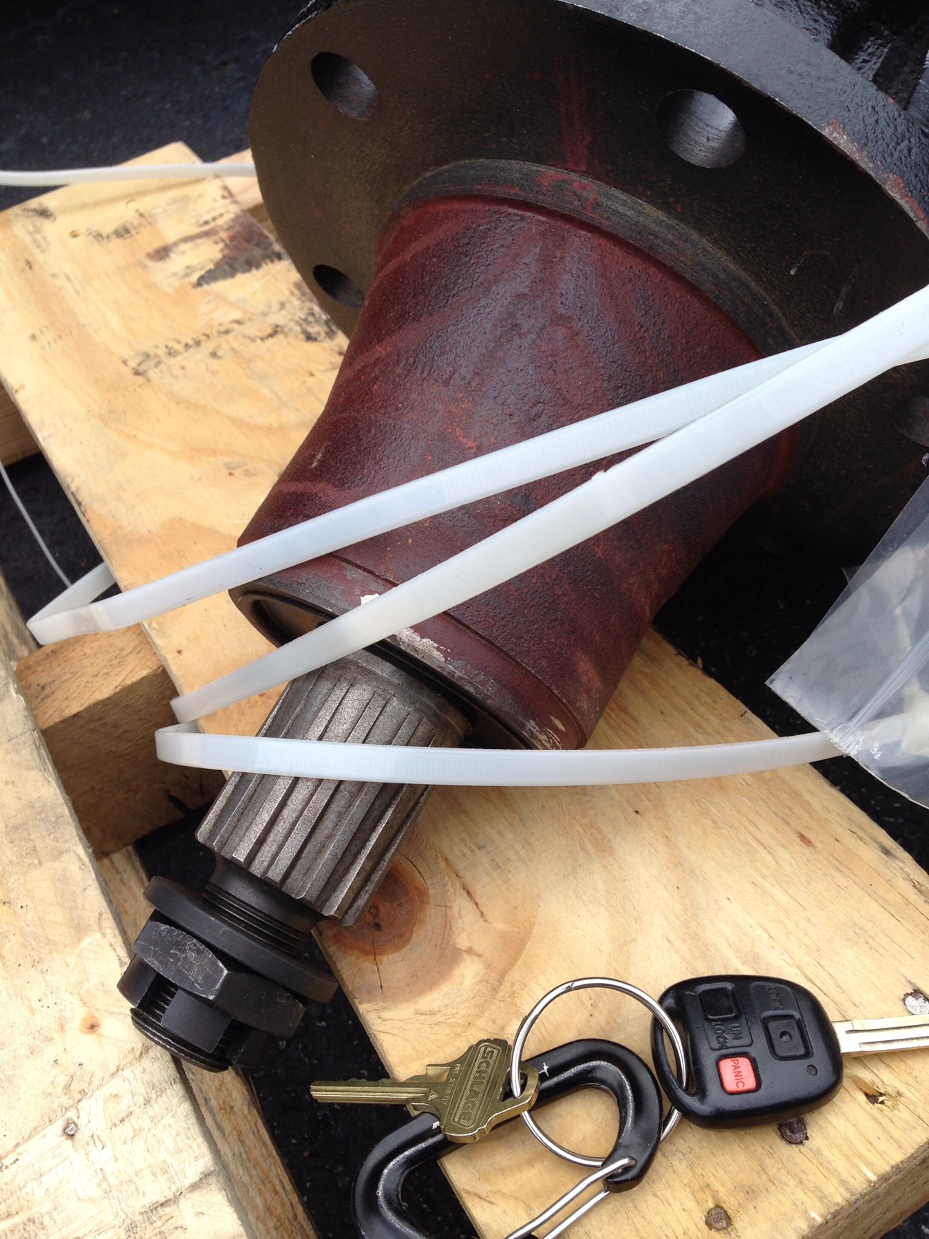

I opened up the box of parts I got from Messicks to find this surprise for the condition of my new output shaft, so back it goes....
I still have some level of uncertainty about the reassembly. I'm told that the shims won't change with new bearings and can go back where they were. A Bush Hog tech told me to pre-load the output shaft by tightening the 55mm nut until the moving torque on the shaft was 6-8 ft.-lb. without the shaft seal. That is straight-forward. Less obvious is how one would ever set the preload on the input shaft bearings. It is entirely by shims. I'll just hope that my guidance was correct and that no shim changes are necessary.

Holy smokes! That's really putting the OLD in New Old Stock!

The Messicks rep said they had problems with some Bush Hog parts because they don't put any kind of rust preventative on them. I am used to precision parts being wrapped in VCI paper. Not so these clowns.

That is pitiful,, He'd be getting an ear full on that shaft..

The part was not boxed, so Messicks should have seen the damage and not shipped the part in that condition, but having made the error, they are responding very well. Bush Hog should package the parts properly.
Those parts are pitiful.

How could you send that out?

That’s just wrong. Parts like that should be covered in cosmoline and wrapped in barrier paper at a minimum.

Find it very hard to accept COMER sent it out of manufacturing so it would arrive at Messick's in this terrible condition.
Please show us how the next one is protected.
The rusty shaft may have an interesting history like surviving Katrina :)
Messicks told me they come unprotected from Bush Hog in Alabama. I don't know if Bush Hog sources them from Comer or if they get someone stateside to make them. They had two shafts left at Messicks and the rep I talked with said that both were rust free but neither was packaged. I got my input shaft bearings and seals, along with a 55mm socket to continue the disassembly. All I lack is an undamaged output shaft.

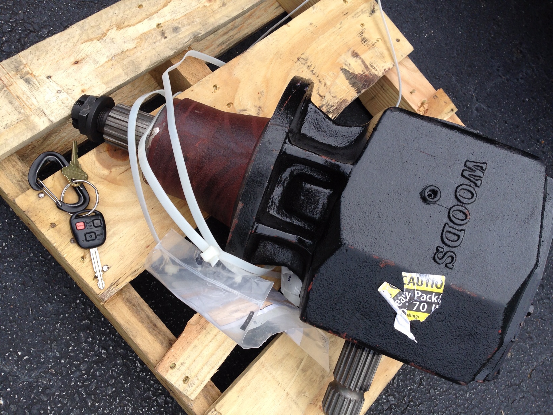

The replacement shaft arrived sans rust this time. The nut would not thread on though because of thread damage. If will be easy enough to dress up with a thread file. Whaddaya 'spect for $160, expensive plastic thread protectors, and, uh, a cardboard box?

That’s really pitiful. If you had not been waiting so long, I believe I would send that back as well. Messick’s should be embarrassed. You shouldn’t have to file a part this expensive. Where is their quality control?
