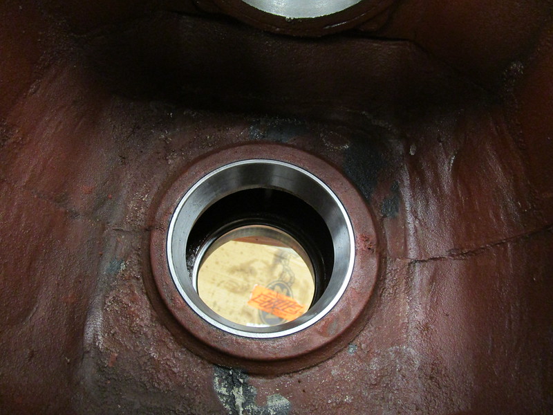

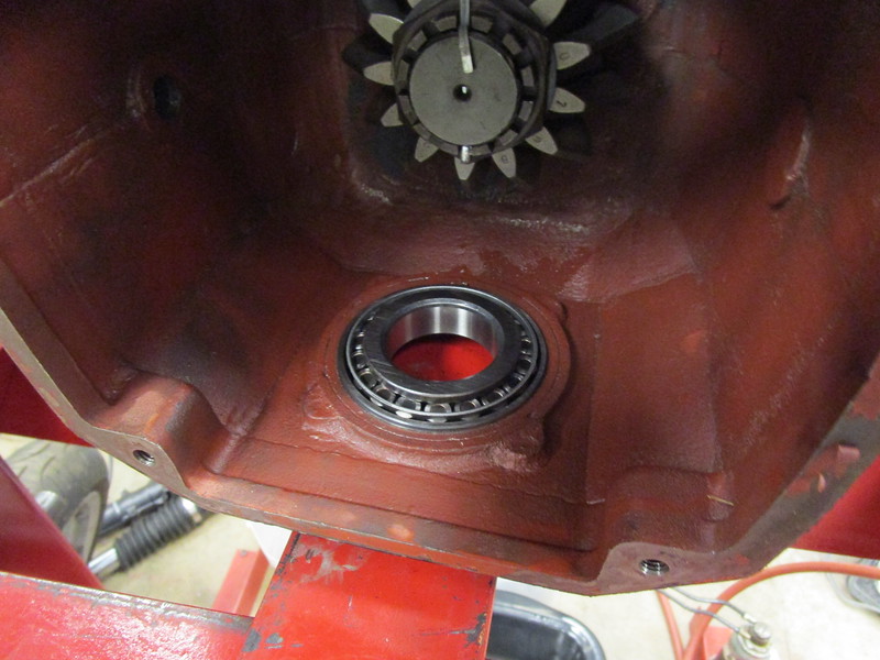

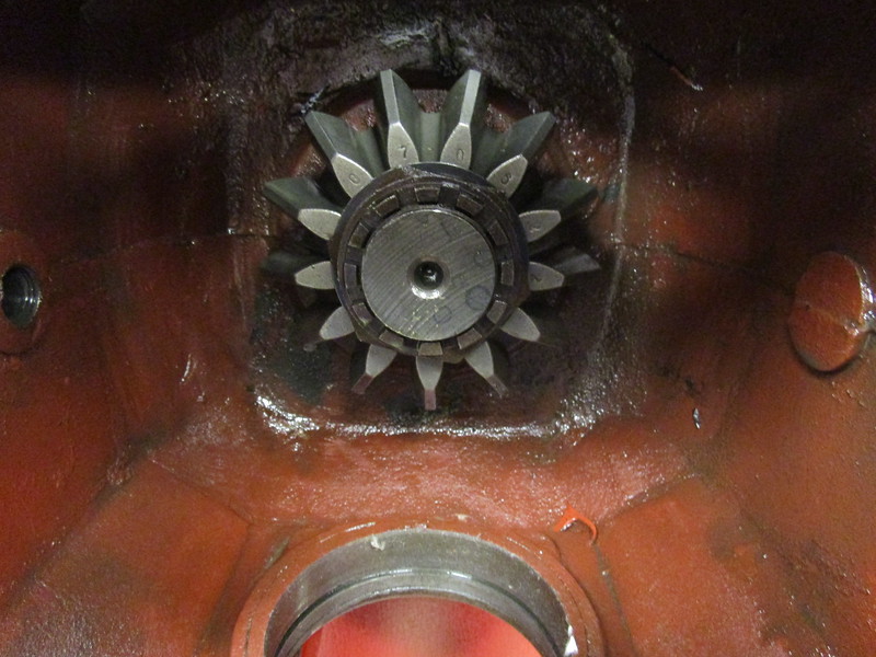

Secondly, it occurred to me that normal gear oil changes in this gearbox never exchange the gear oil that the output shaft bearings ride in. This is an issue because every time I have changed the gearbox oil, it was a water/oil emulsion because of condensation cycles. Since there is no drain plug, the oil is removed by suctioning it out through the vent plug. That only empties it down to the top of the inner output shaft bearing. There is a cavity formed between the two output shaft bearings where the oil is never changed. Water being heavier than oil, I imagine that there is more water down there than there is in the upper housing. Here is a picture that shows the area between the two bearings that does not get its oil changed...
It is clear from this picture that draining the gearbox reservoir does not even touch the lube in the lower cavity.
Hence forth, my plan is to place the cutter on its side with the fill plug facing down and drain it overnight through the fill plug. This should allow the lower cavity to drain through the upper bearing. After I refill the box, I will recheck the level the next day to replace the amount that went down into the lower cavity.

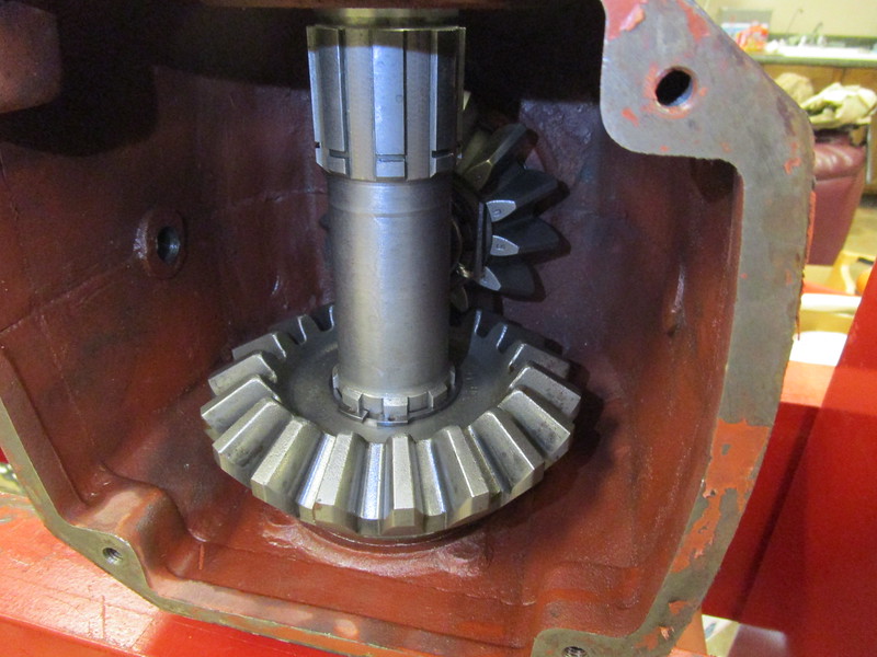

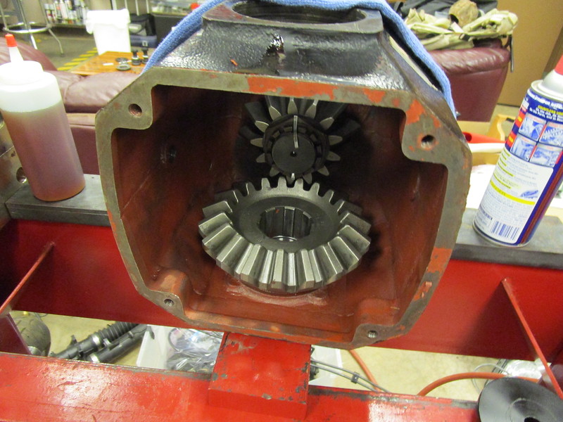

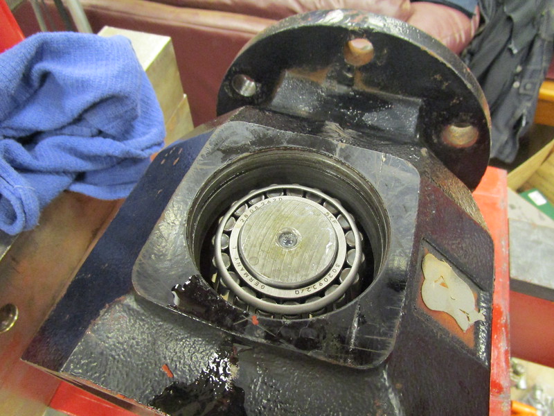

Back on this project for the input shaft fit-up. Getting ready for assembly, the input shaft and the outer races for both 30209 bearings went into the freezer. The inner races and bearings for both 30209's went into the oven at 250F along with the blind side bearing shim and the crown gear.

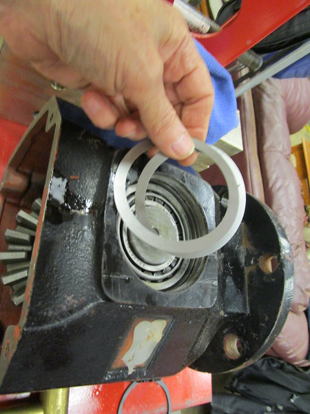

First install the input shaft snap ring and two shims

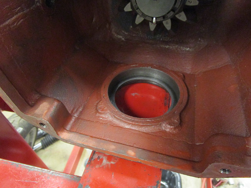

Next install the input bearing outer race from the inside with the taper facing in. With the race frozen, it drops into place with an easy tap.
Set the pre-heated 30209 input shaft bearing and inner race into the outer race.
Set the pre-heated crown gear into position aligning the inner bore with the bearing.
Install the external snap ring that fixes the position of the crown gear onto the input shaft and insert it from the blind bearing side until it is seated in both the input shaft bearing and the splines of the crown gear. The snap ring should be resting against the crown gear if it is sufficiently inserted.

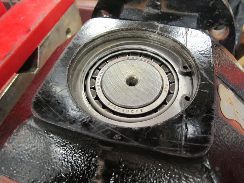

It is not shown in this picture, but now the thick blind bearing shim is installed on the input shaft.
Next the blind 30209 bearing is installed with the rollers facing to the outside.
The blind side bearing outer race is then tapped in using a mandrel, followed by two shims. If you use the heat/cool process, a light tap is all that is needed. For a mandrel, I used a 2-1/2" PVC conduit bushing. The OD of the bushings vary, so I selected one that was a bit under the 85mm (3.3") of the bore.

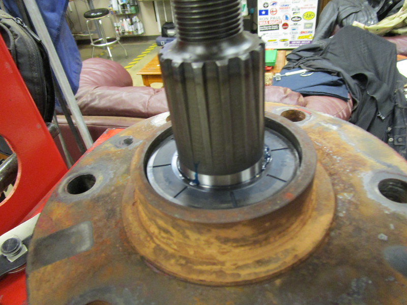

Next the snap ring is installed. Here is another advantage of a frozen shaft. Since the shaft has shrunk in all directions, there is little interference caused by the preload of the bearings. Set the snap ring in the bore and insert the conduit bushing and give it a light tap with a mallet. It will fall into the groove easily. Once the shaft is at room temperature, preload will magically appear.
I'll seal it up in the next post.

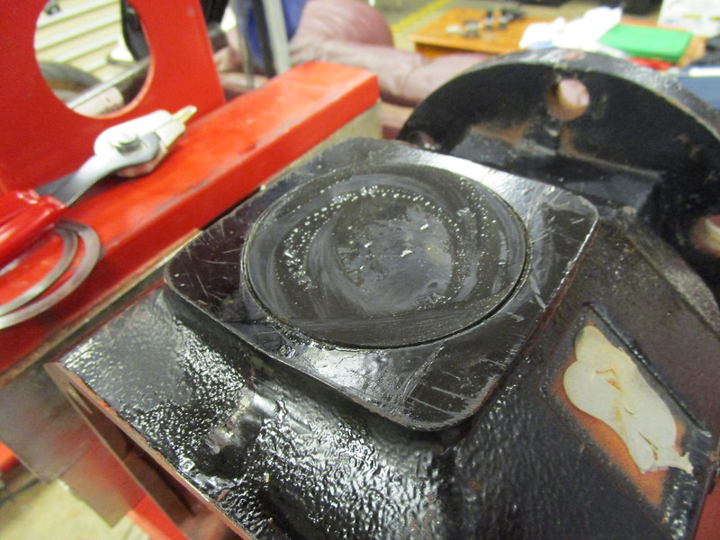

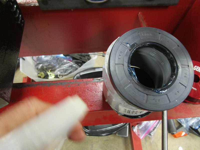

A new blind seal was tapped into place. I use either dish soap and water or tire bead lubricant to ease the installation. I don't like to use petroleum lubricants because I want it to dry once the seal is in place.

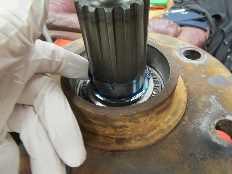

For the input shaft seal, I grease the land area where the seal will run and the ID of the seal itself. The OD of the seal, is again lubricated with soapy lube.
Same process for installation of the output shaft seal
The output shaft seal is pressed into a recess depth of 1/8" to allow fitment of the protective washer.
The protective washer is then tapped into place in the recess.

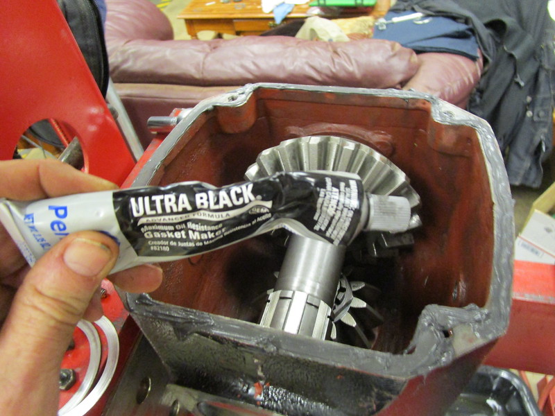

The cover was cleaned of old gasket material and the vent was pressure cleaned.
A light bead of Permatex Ultra Black was applied to the top of the gearcase.
