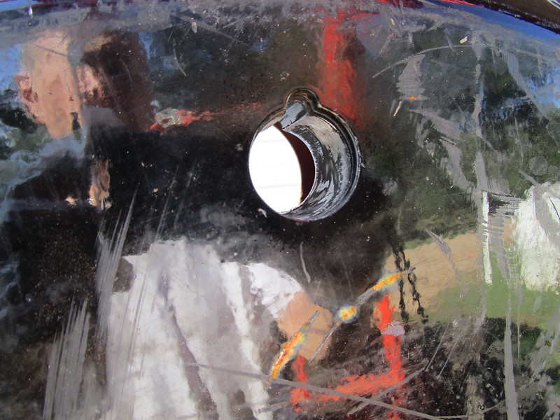

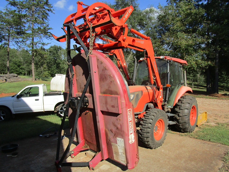

This project just won't die. I hung the cutter up to install the new stump jumper and blades.
One blade fits but the hole is too small for the other blade bolt to go through. $578.47 for a steel weldment and one of the bolt holes is too tight. This is not a precision fit. It is a keyed bolt. Make it a little too large instead of a little too small! Bush Hog should find something to do for a living that they are capable of. Manufacturing is not their calling.
It took more than this, but I had to grind the ID until the bolt would fit the hole. Absurd.
Finally, two blades hanging.
Bush Hog has lost a customer over this one. It has been a pathetic experience from beginning to end. My advice if you find yourself in a similar situation is to ignore everything I posted here and sell the POS for scrap iron. Then buy a cutter made by a company that is capable of machine manufacture. Maybe it will run ten years more. I hope so, as I stuffed a grand worth of parts into it. If it does not, there will be no Round Two for it.
Peace. Out. - Lee
