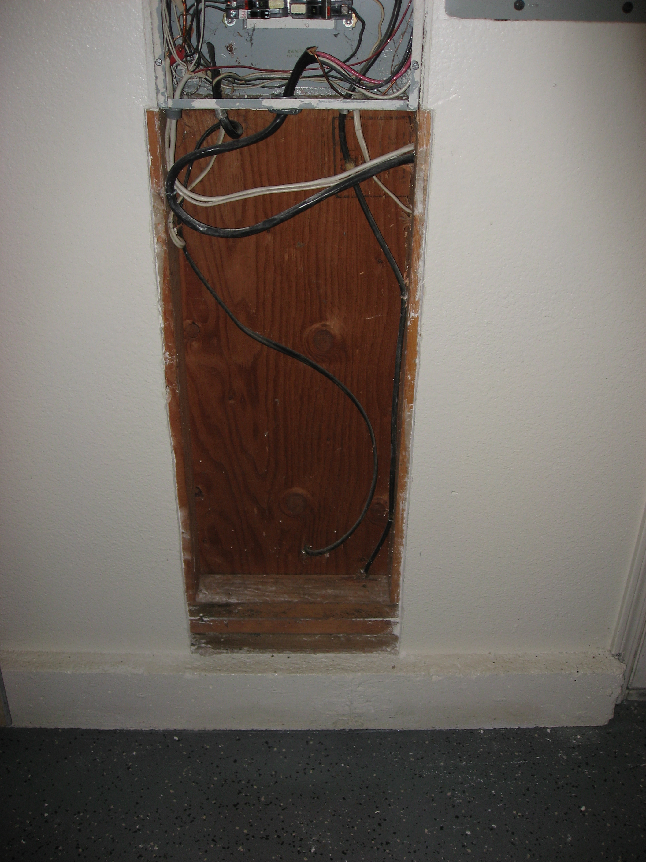

This was my next question. It is in a nicely finished garage that has orange peel texture on the walls and ceiling, so I'd like to make it easy to re-make the wall-to-ceiling finish. How do you make the horizontal cut without worrying about cutting into a wire? Just use a utility knife and cut most of the way through?

By code you cannot have any wire near a surface. That explains why drywall screws are 1 1/4" long and the wire runs are in the middle of the stud.
I hear ya, but my luck runs closer to Murphy's law.

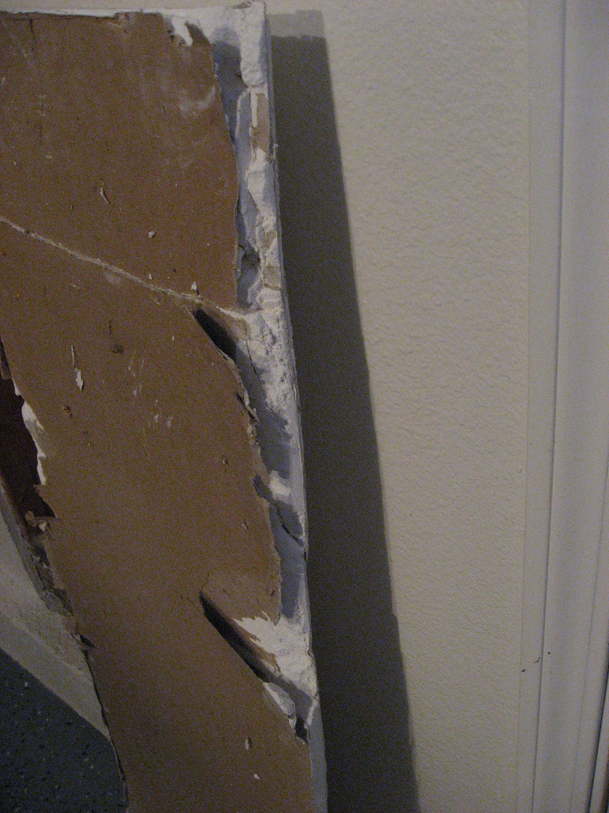

I took a shot at just using a utility knife down the center of the stud. It turns out part of it was glued as well as nailed. It's torn up a bit at the top back, but I may be able to clean it up enough to reuse the panel. I think for the top section I'll cut next to the stud and secure a 1x2 to attach it to when I reinstall it. As seen in the photo, there were definitely some wires within 1 1/4" of the stud surface.
I appreciate all the helpful suggestions.
