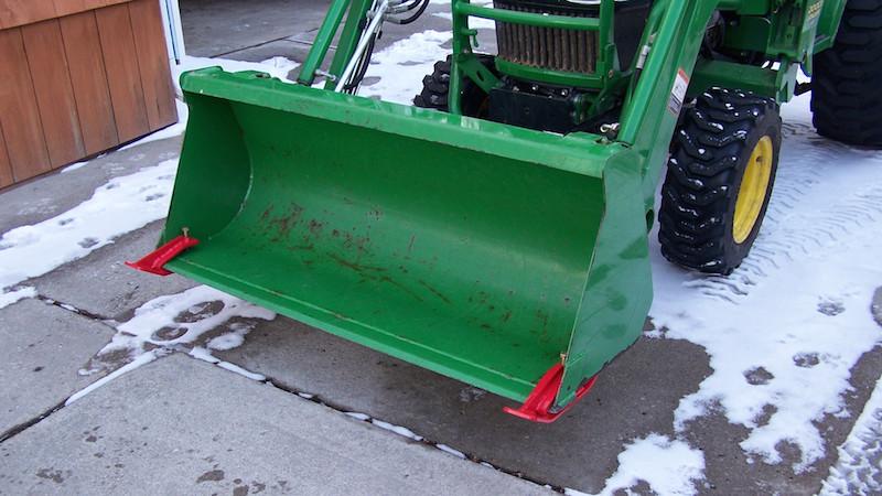

Buy three of these, too. Put one also in the middle of the bucket edge, and worry less how close the outer two are to corners. (I don't use chains) I use Box Blade to pull snow from buildings or doors to where it can be scooped and deposited. (I don't have a cab or wear coveralls for a barely 1 hr job)
Plows/blades are for pavement unless you are grading. They will generate 'curbs' over years of piling gravel along sides with snow. They will also scalp your crown. :eek:
Think ahead and plan to move snow like the bulky commodity is sometimes is. Pile it where Spring melt won't go to the wrong place, like down the driveway you plowed & banked into a river channel by using a pavement plow.
It's not that it snows much in MI, or that my own gravel driveway is 550' long, but I've been clearing it for 18 years. Much easier once I removed the 'curbs' and crowned it, and started using Edge Tamers. Edge Tamer - Move Snow With Your Tractor Loader Bucket – R2 Manufacturing

How do those work in the mud?
   / How To Remove Snow From 400 ft Gravel Driveway? #18
About the same as a blade with 'gage buttons', though your own experience may vary. :thumbsup:
eg: Is your mud from poor grade, poor drainage, filling holes with wood chips or drywall? The OP didn't even mention his mud. :confused:
I don't cause mud by intent, and quit dealing with mud once I removed the 'curbs' and graded my drive for proper drainage.
btw, I'm not the inventor of the product, maker, or marketer just someone who actually uses it. :confused2:
(standard disclaimer: "Individual results may be all wet.")
