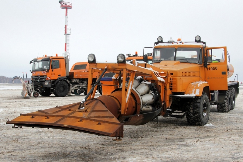

This is the only suitable equipment for your needs. Jet power!
