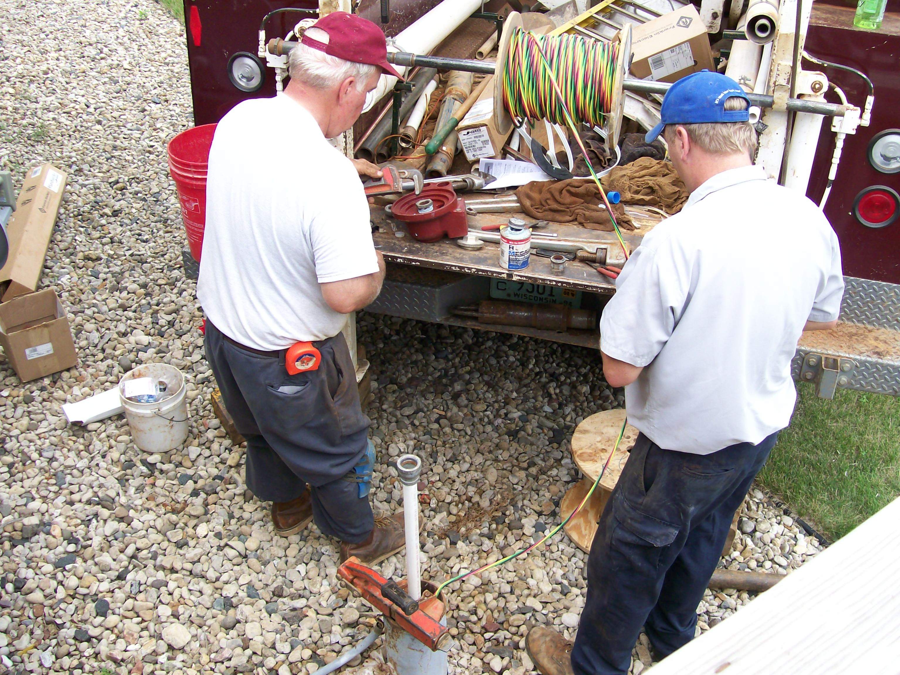

I have installed my well pump many years ago. I set my pump at 375 feet so it is near what you have.
There should be what is called a pitless adapter at the level the water pipe goes from the well to the house, around here it is at least 5 feet below ground level. There is a tool that looks like a large T-handle with a pipe fitting on one end that screws into the top of the pitless adapter.
The pipe going down to the pump is attached to the pitless adapter. The pitless adapter is a right angle fitting allowing the water to flow from the pump pipe then out through the side of the well casing to the house. When the T-handled tool is screwed into the top of the pitless adapter you can then give it a tug and remove one part of the adapter that has the water pipe connected to it.
Then you can begin to pull the pipe, wire, safety rope, and pump up out of the well. As you pull the pipe you will need some one to stretch out the pipe as it lay along the ground so it does not kink, wrapping it around the house works. Once you start this operation by hand you can not stop until the whole mess it out of the well. Pulling that slimmy pipe hand over hand for 300 feet will take a couple of people unless you have shoulders like the hulk.
The pump people have a three wheeld afair that sets on top of the well casing that is powered by an electric motor that drives the pipe and pump right up out of the well, all you need is someone to stretch out the pipe as it comes out of the well.
When I put my pump in I had a part of vice grips that have a pipe fitting welded to the jaws then cut in half. The inside diameter of the pipe fitting was a little smaller than the plastic well pipe. When we had to stop pulling or pushing the pipe we could clamp the vice grips on the pipe and rest it on the well casing.
You may be able to rent the machine that pulls the plastic well pipe. Check you wire going along the pipe over time the wire rubs on the pipe and itself and will chafe a bare spot through the insulation. Replace the nylon safety rope. You will need a splice kit for the underwater connection to the pump.
To have this done professionally should take about 3 hours, it will take you all day. The well should be shocked with at least a quart of bleach after everything is put back in.

while mine doesn't have a pitless adapter I do have PVC. It's 20' joints with collars that attach each joint. When I pull mine I use a 2X8 board thats long enough to span the casing say 10-12" long and I cut a slot in it that will just fit the OD of the tubing but not let the collar go by(some folks call this a slip block). My son and I will pull ours and its about 180'. As we are pulling it up we raise it high enough to get the collar up out of the casing, slide the board over the tubing and let it rest on top of the casing. At this time we unscrew the top joint out of the collar and lay it on the ground. Repeat for the remainder of joints all the while keeping a hold of the well rope that it tied to the pump. Our wires are just taped to the side of the tubing with black tape. Reverse procedure when installing back in well.

We have a 450' well, pump at 425'. We have black poly pipe. Was here when the well company replaced the pump.
They had a car rim mounted on a frame so it could rotate. They pulled the pipe up about 8', letting it ride over that rotating rim so the poly pip did not kink. Then the put a rope around the top of the poly pipe and well"head". There was an existing rope in the wheel, they tied to it too. Then, they drove 425' pulling the whole shabang out.
