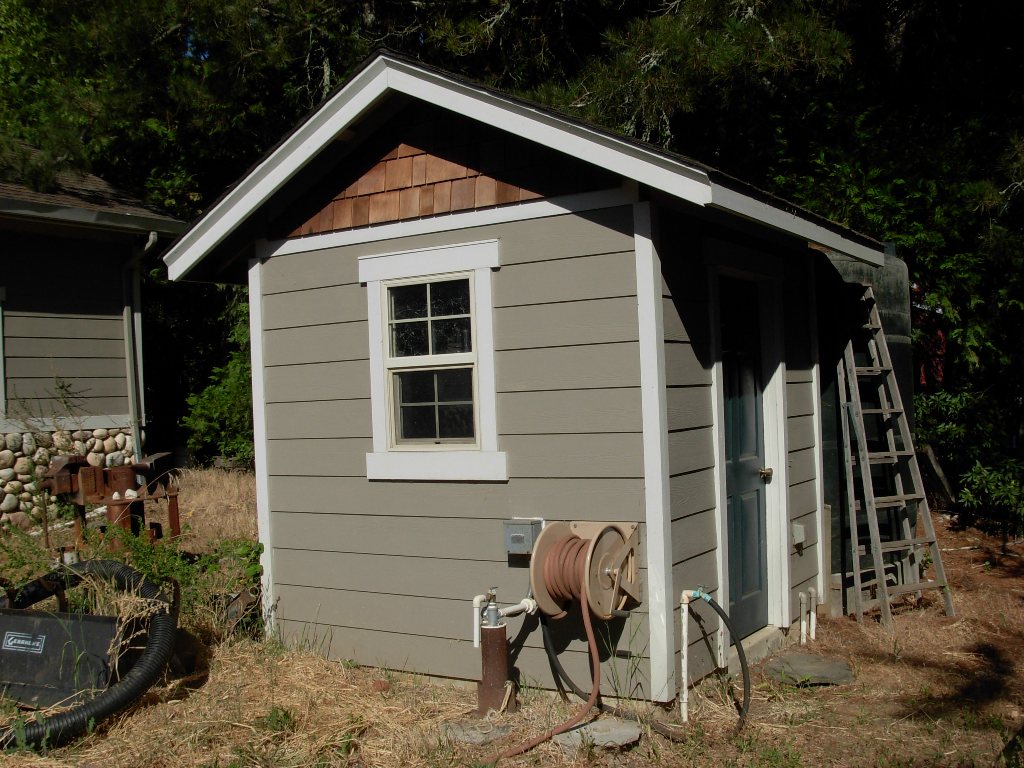

Pump house that I built to where I can still pull the pump.
