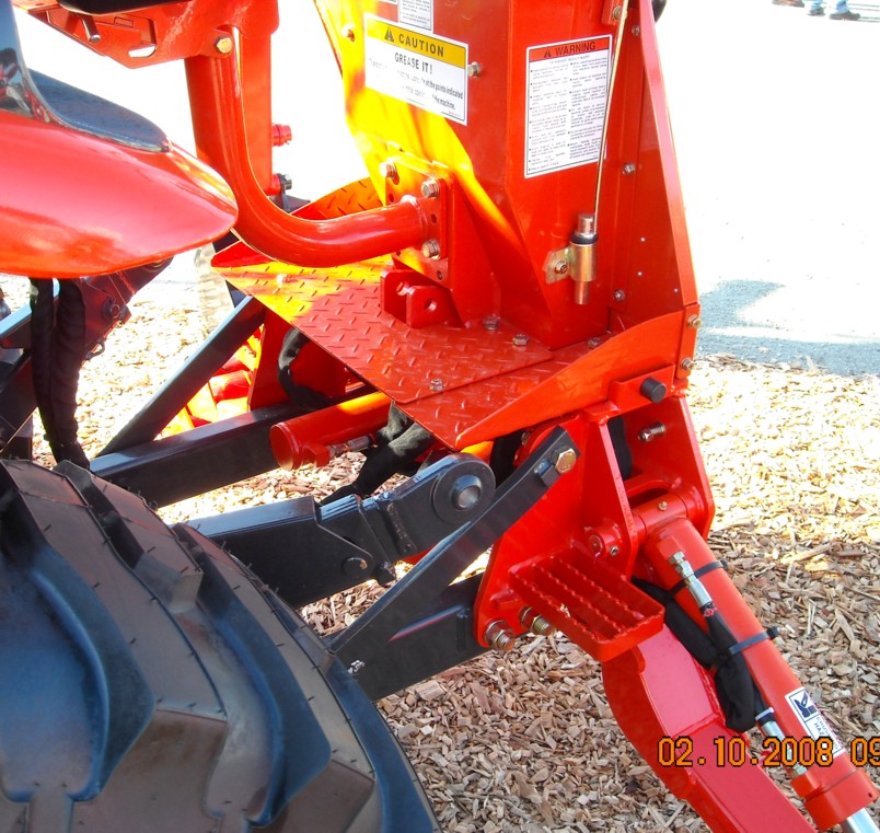

I'd buy that tractor if the price was right. Missing top link, not required for sub frame use & if tractor was purchased w/backhoe for rental use there probably never was one delivered. Bushings are wear items that are meant to be replaced. Most on TBN will probably never put the hours on a backhoe that this one has. As for a renter greasing, did you see the grease gun in the toolbox or on a bracket? Short term renters don't do maintenance unless told to & provided the tools/parts. Welding was done on the struts because the bolts kept loosening. Insufficient weld by amateur welder ! The struts are used to make the sub frame smaller for initial shipping then assembled. Woods sub frames are 1 piece - no assembly required. Weld on the boom -is this the first Kioti (or any other) underdesign issue we've seen that required a weld repair ? Missing loader frame bolts is a staple with Kioti. Loader assembly/installation is usually not done by the shops best mechanics and doubtful a torque wrench was used. I'd safety wire them if I was in the rental business. I considered safety wiring mine until I tightened them with a torque wrench to proper tightness & stopped loosing them. I try to take care of my tractors but got them to do work not to work on. Scratches & dents happen, waxing don't.

Missing top link, not required for sub frame use & if tractor was purchased w/backhoe for rental use there probably never was one delivered. ......Welding was done on the struts because the bolts kept loosening. Insufficient weld by amateur welder ! The struts are used to make the sub frame smaller for initial shipping then assembled. Woods sub frames are 1 piece - no assembly required.
Is your backhoe a 2375 or 2385, Mike? If so, does the owner's manual
say anything about using a toplink with the subframe? It is true that the
Kioti hoes at the shows don't usually have them, but they need them.
It seems that the newer hoe (2475) has a provision for a toplink (photo).
The one in the video is flexing to much longitudinally. That would cause
the strut bolts to loosen up. Even a good weld here would not last very
long with that much flex. I wish I had a good photo of under the seat of
a 2375....
The older style Woods ladder-style subframes that I have seen and
purchased all had enhanced toplinks. There was also sustantial assembly
required, esp for the parts that stayed on the tractor.

dfkrug, My backhoe is made by Long Mfg. & I adapted it to a Woods subframe. I can see that you're right about the toplink being necessary in this application. Here's a rock solid CK20 with toplink installed. http://www.youtube.com/watch?v=uGbc...0E0E78774&playnext_from=PL&playnext=1&index=2 I agree that if designed for a toplink then it should be used, however it's not like a toplink is an irreplacable part. On this tractor it may be necessary to limit flex in an underdesigned subframe, but we're not talking industrial TLB here either. Same for the bent bucket top edge. Most use their FEL for little more than a wheelbarrow, which is not a bad thing at all, but this one has worked harder than that. I'm just saying the unit needs some simple maintenance. It's not the complete piece of junk some implied. With a couple hundred in parts & some self supplied labor someone that can't afford new could get a lifetimes use out if it, using it as it was built to be used. And I still thinks that is a quality sales pitch. Why was it on u tube? MikeD74T
