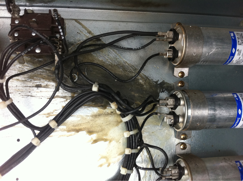

Attached a photo of a nice capacitor blowout for your entertainment.
The smoke got out of that 1...Funny how long parts last until the smoke gets out..Once that smoke gets out, that's it !

Would have been nice if it was just smoke but it had to violently puke its guts out all over the rest of the components. Once I fixed it you can hardly notice lol
Yes, I saw the puke.
can't say I've ever seen 1 do that !
