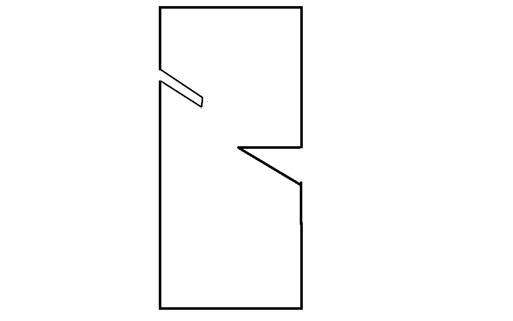

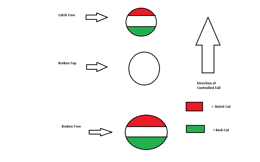

Just Me , But if I had the room to safely do it without dropping onto a building , etc... , I would notch the tree it is leaning into , ( A notch on opposite side of the leaner and prefer inline with the tree were the top came from ) , A small back cut of maybe 1/3 what would actually be used to fall the tree . Then cut a notch in tree that top came from and back cut it to fall directly into leaner and current " Catch " tree . Like Domino's . it will come down .
Above is a Very Crude Drawing of what I am describing .
How I would make cuts on both trees .
NOW , With that being said , That is Me and I know my experience level . We used to do it all the time cutting Lodgepole pine from 12" to 20" diameter for firewood . Would almost always get a hanger every weekend due to the close proximity that the tree's grew to each other . If We did , We would cut a notch in the " Catch " tree , small back cut , then drop a third tree right down the chute . Not a professional by any means , just been around for awhile . Not a fan of the cable idea unless you can get it Way UP , like at least half way , Bad things can happen if it decides to go the other direction .

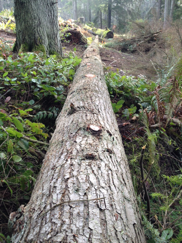

In the pictures below, you will note a tree that I have on my property that recently found itself in a precarious position. The noted tree is the TOP 80 feet of what was a 150 foot tree. It was blown off the top of the tree in a recent storm, came straight down and lodged itself in the ground and is now leaning against another tree. I need to safely remove this "tree top" so that it has a controlled fall. The third picture is the base of the tree top that is sitting on the ground. How should I do this?
If I cut to fell it as you would a normal tree, it could just buckle on me I am thinking. The only way that I can see to do this safely is with a 50 + foot chain tied to the base and pull it away from the tree it is leaning on. Any thoughts? Any suggestions?

And now for the rest of the story...I was successful in felling this broken tree. Wow...
In summary, I put an extension ladder up about 24 feet and connected a chain at that point. I connected that chain to a series of chain to stretch over 100 feet. I had estimated the top of this tree to be 80'. Pulling 90 deg from the lean, I tugged the chain with the tractor. It moved some, gave another couple of good tugs and down it came right where I thought it should fall. Measuring the tree after it was on the ground I measure 81'. Good guess.
Yes, it worked out well but I was definitely nervous for about 5 mins not knowing what might happen. I had an escape plan and glad I didn't need to use it.
