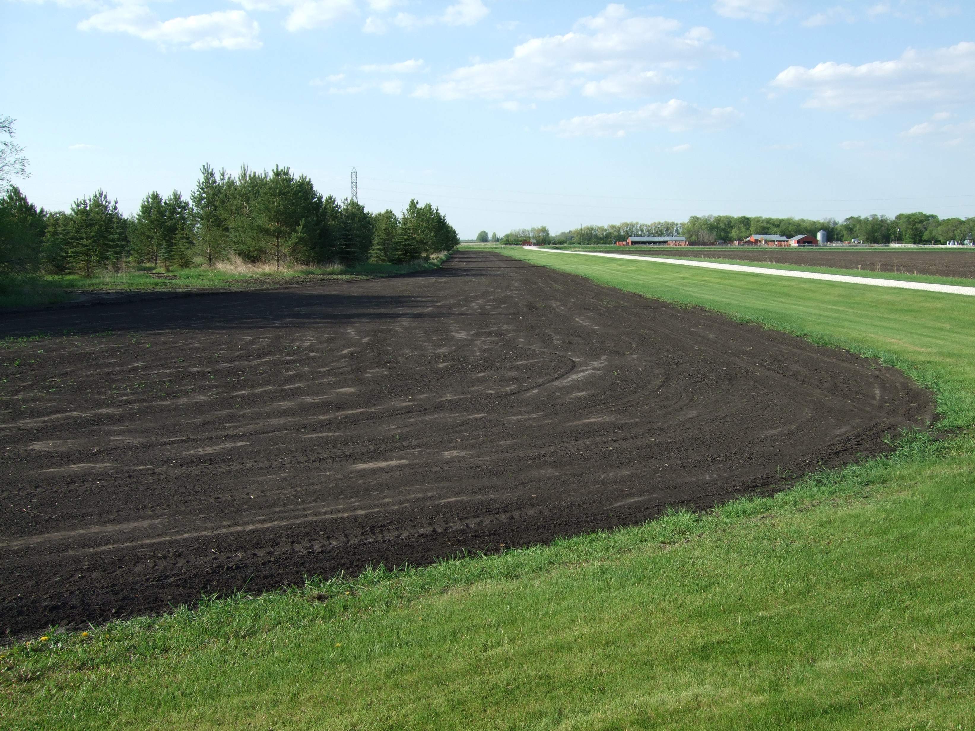

I have about an acre of grass to seed. I've levelled the area.
1) Should I till up the top 1" with the tiller?
2) Need to figure out some way to 'rake' in the seed using the tractor.
Ideas?

   / How to seed grass in large area?
I don't believe the soil is a problem. I have grown smaller patches to full thick lush grass in about 3-4 weeks. There is lush grass right beside the area where I am seeding.
I am going to lightly till (1") and then broadcast the seed. I think I am going to use a piece of chain link fencing to rake it in.

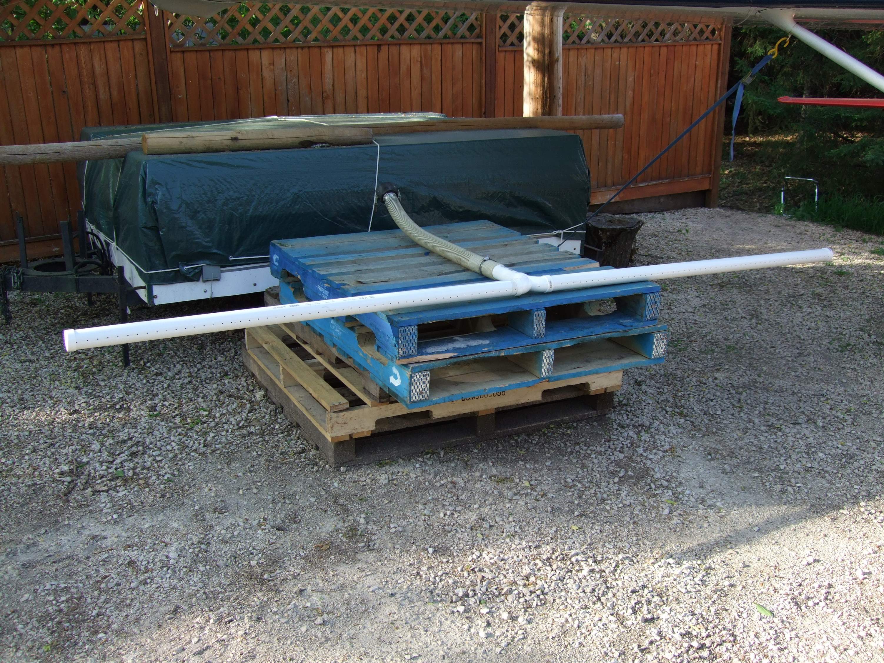

I built my watering system today. I have no running water out there. My system includes a 300 gallon tank, my pickup and my water distribution boom. Total cost to build the boom was $15. Holes are drilled every 1". They are 1/8" holes.
