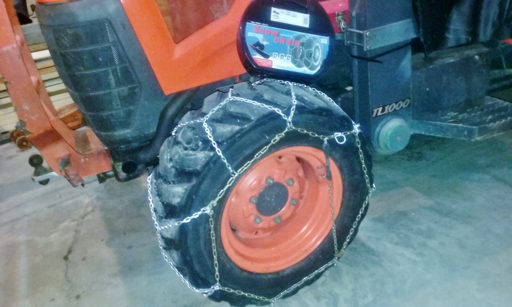

Backhoe has not been off in 2100 hours and 11 years. It would get too light in the rear.
Cheap chains, I expect they wont last, but if I use them just to steer and seldom in FWD, I might get through a season or two.
Amazon.com: ALEKO SCHAIN-13 Passenger Car Snow Chain, 12mm: Automotive
To guess you size, ALEKO SCH-13 Snow Chain for small vehicles

Well the $20 crappy little Amazon Prime Chains seen to help a bit, at least plowing 8" of fairly light snow. When these wear out, I'll put on a better set in the front.
That soft Cab is a blessing, I spent 4 hours in the seat tonight plowing, and it was 5 deg. F outside with 30 mph gusts.
Once the motor and drivetrain got some heat in it, I bet it was a balmy 35 deg. F in the Cab.

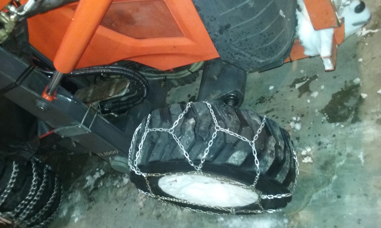

The Amazon cheapo 9mm chains almost made it thru this storm, Using front assist is what killed them, as the wimpy chains can't take the torque on a heavy tractor. I bought the next heavier 12 mm chain, same brand, still questionable, only $4 more from Amazon.
