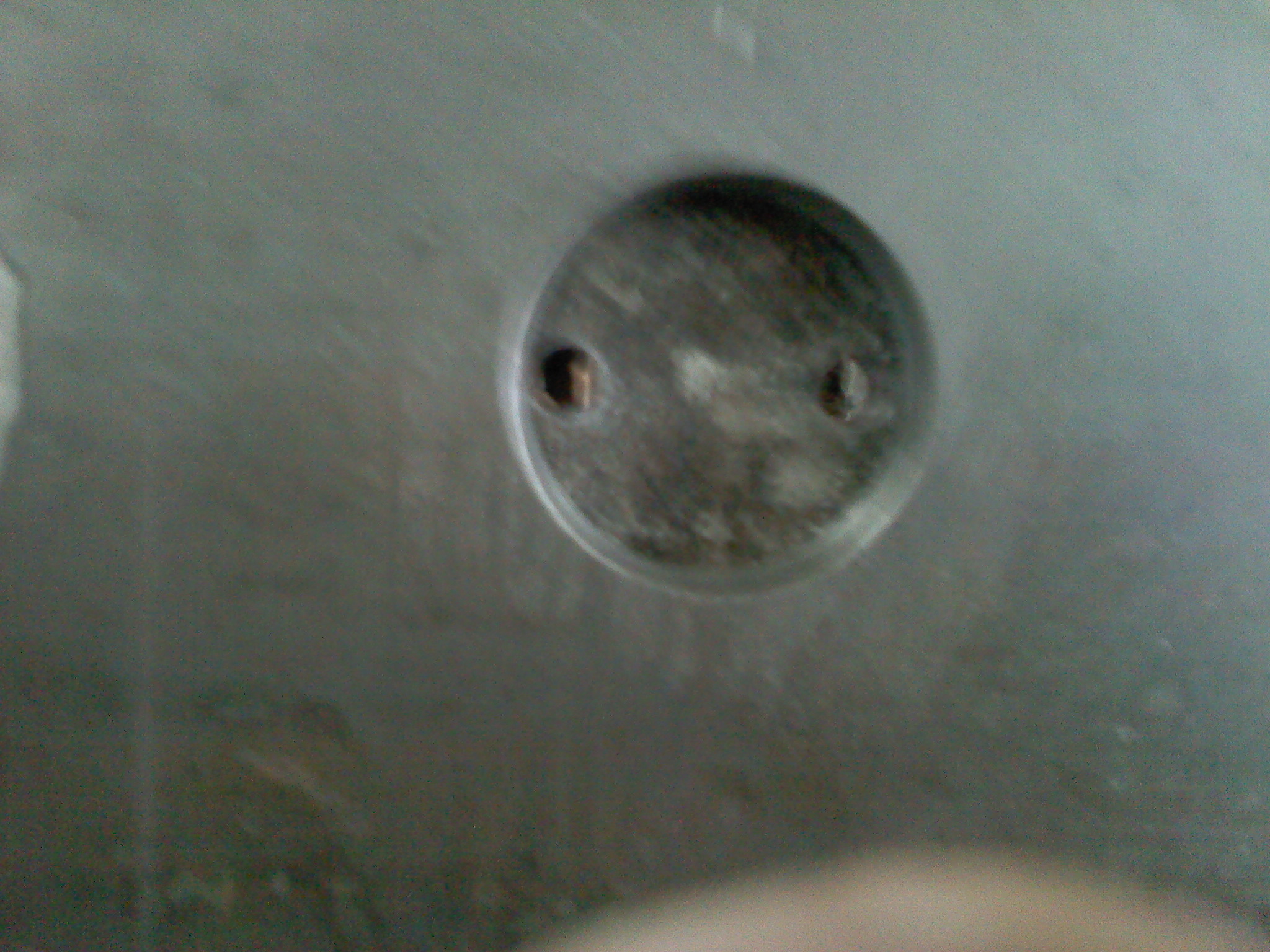

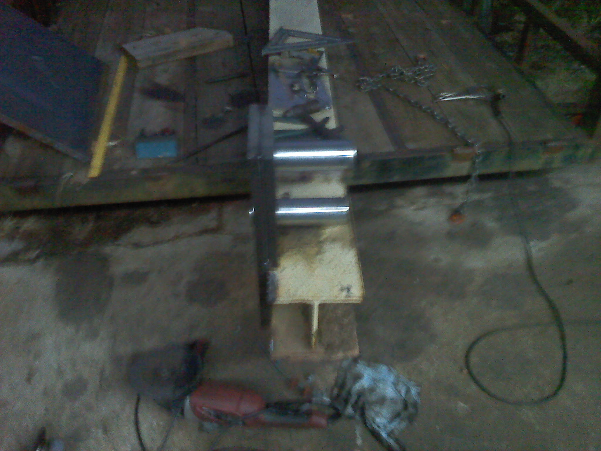

Well figured I would show a pic or two of what I have been sawing. Cylinder mounts for my processor build. Holes cut with a drill press and hole saws. Doubling the 1in plate. Predrilled 1/2in holes before finishing with 2.5in holesaw. This makes it a lot easier for the hole saw to cut thru the thick plate. Drilled one plate then spot welded the other plate to keep it square and used the holes in first plate as a guide for the second plate. After about 5 of thes holes, I noticed the pin wouldnt fit all the way thru the second layer of metl. It seems the last holes wherent as big as the first holes. Took a new holesaw and ran it thur again. I guess after sawing thru about 6inches of metal, the holesaw lost a little dia. Pins are 2.5in. Will be using twin 4.5in bore cyl. for the splitter. I had planned on welding the mounts to the hbeam today, but my Northerntool grinder gave up the ghost and I couldnt grind my bevels for welding.

Yep that would work, but my cylinders have 2.5in pin holes. I already had the pin material and the metal for the pin bosses. I also am mounting two cylinders, one above the other, on the same base. The hole saws worked out fine for this application. The holes may not be perfect, but they are close enough for what i am building. When I get the welding done and my pusher slide built, I'll post a few pics of the setup. Probably wont be this wkend tho. , I'll try to make some better pics so they are easier to see
