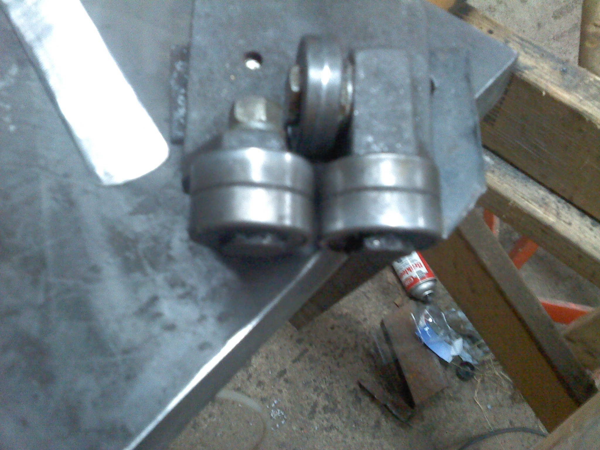

On my HF saw, the roller guide castings are a bit rough but seem to stay pretty square front to back - I tend to leave the rear one set, and the front one as much as possible. I also check with a small machinist square whenever I move 'em - a 4" or 6" clamped in the vise works well for that (nearly touching the blade, look for differences in square to blade distance)
Blade roller bearings - on both of mine, one is on a lock-nutted eccentric insert, I keep 'em just loose enough to (barely) get a new blade between them, helps minimise wander. (Thinking this may be one of your problems)
My misgivings on those sliding guides is the main reason I try NOT to move them unnecessarily, and if I do the machinist squares come out afterward.
Vertical squareness can kinda be "eyeballed", but the only sure way to know is test cuts. If you can't repeat results, it almost HAS to be too much slop somewhere... Steve

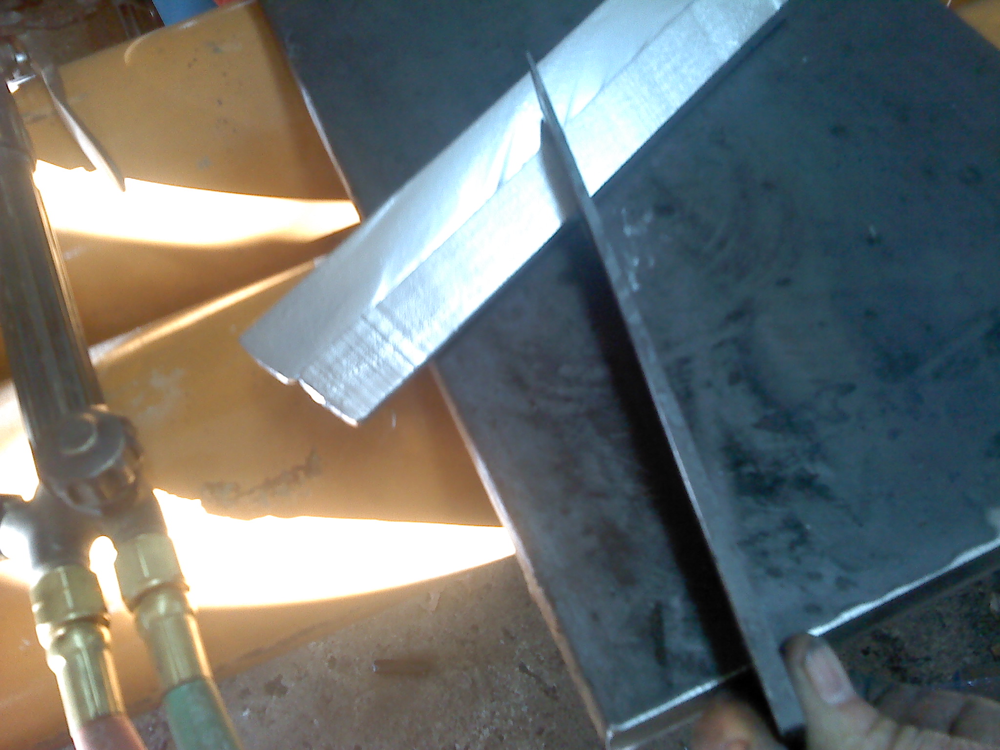

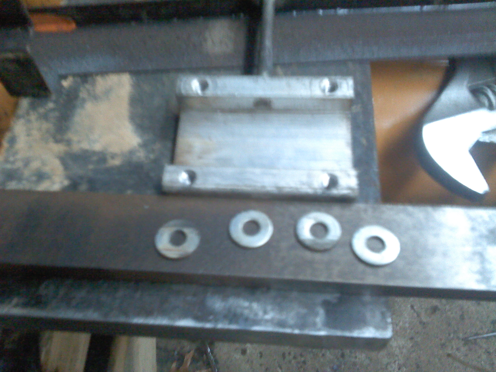

Steve, after reading what you said about the roller guide, I put my coat back on and went back to the shop. with just a little bit of effort, I could wiggle the guide, so I decided to take if off and look at it. The guide was pretty rusty and for some reason, the aluminum guide it slid thru had washers between the block and the frame. With the washers removed, the guide bar still slid thru it easily and I could still wiggle the bar. The aluminum block didnt seem to have much wear, but the guide rod still seemed to loose to suit me. I cleaned all the rust off the bar and gave it a shot of paint. I figure the paint will help keep it from rusting again and might take a little slop out of the assembly. When it dries, I'll put it back together sometime tomorrow. Got it setting beside the wood stove, baking the paint on. The rollers all seem tight, bearing good. The assembly the bearing bolt to is cast, so no flexing there. If this dont do it, all I can think of is the beam is just to flimsy. Its just thin rectangle tube with thin flat plate welded on to hold the band wheels. I could plate it to stiffen it up some, but that would probably make the arm to heavy. Heres a few pics of the guide assemble and the one cut that was almost perfectly square, you can just barely see the edge of the steel under the square. Plus one more wedge, the byproduct of trying to get everything square.

Those washers look to me like a "SEP" - I bought one of those about a month ago :confused: (Stands for Somebody Else's Problem) - IOW, looks like somebody tried to fix that problem and when it didn't help, you bought it :(
Well I'm not so sure those washers arent part of the original design. They do extend toward middle some to hold the slide bar, but I cant see where they are necessary. The bar is thinner than the slot in the aluminum block. I aint ready to give up on it just yet. I can remake that aluminum block, make it a tad longer and tighten up the clearances. I aint got time to fool with right it now, and I'm done cutting the 8in plate, so I'll put it back together and fiddle with later. I actually think just that thin layer of paint will take out most of the slop in the guide bar. That and working on leveling out the bed, which I think is the biggest problem. If you put a straight piece of steel on the bed and it rocks, I dont think you can adjust the blade enough to get a straight cut. I think the little heating and prying on the bed helped, some, Not exactly sure how i will get it perfect. It will take some time I'm sure, but short of cutting the bed out and replacing with something heavier, it probably aint going to happen. I do have a piece of 6x8 thick wall tube that would probably work, if I decide to give it a try. The saw cuts true enough on smaller metal so I'll live with it for now. I'll make another cut tomorrow just to see how it does (I need another wedge LOL),and then roll it back in the corner.
