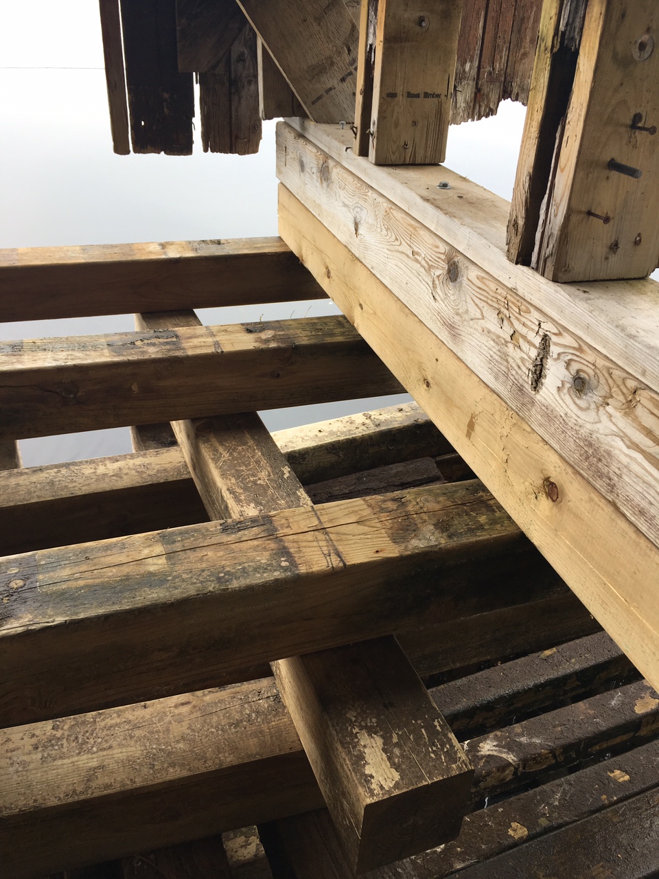

Hey, guys, great suggestions! Keep them coming. Remember, the cribs themselves are these massive 2014 deep beasties that are between 10 and 12 feet across at the top and who knows how wide at the bottom. They are not the problem, although I do need to do a little bit more attaching of my new 6 x 6 members for the last 3 feet or so of height that I used to replace the rotten old cedar crib members. And I can move the walls where if I want, just by hitting them with a sledgehammer. They slide easily on top of the crib. The problem is that the top of each wall does not want to move when the bottom does!
Anyway, I have to go home right now, and will be back at it next weekend. I will be thinking about this during the week as well.

...The problem is that the top of each wall does not want to move when the bottom does!....
The rear wall of the building must be anchored to something pretty stoutly, then. And the whole thing may be warped to the point of not wanting to go back. But most things can be coaxed with cables and turnbuckles over time.
Do as others have mentioned: Put a plum bob on each corner of the roof and see what has to go where to get the walls as centered under the roof edges as possible first.

You say you can't pull it over.
Perhaps you can push it.
With the bottoms parallel and affixed, use a jack (screw or hydraulic) and place the base at the correct wall with the top end to push the lean or tilt to when it is plumb.
Next some diagonal bracing to lock the newly plumbed wall in place.
Nothing is stronger than triangulation.
Since there will be some built up energy I would consider going past plumb as that wall will want to somewhat spring back.\
I know U can't brace across the front as that is a doorway but you sure can up at the rafter level from side to side.
Also in the 2 wall spaces each side of the door you could panel from the inside, the short side walls with plywood and that would 'lock' them parallel and plumb.

The cribbing is fine and stable, and we are using a de-icer in the winter to prevent ice damage, which is probably what caused the problem in the first place. So there is no further work to be done there. We just need to put the decking back on either side after we get the walls situated horizontally.
And I don’t think the problem is due to age-old warping. In fact, as you can see from one of the pictures, I USED to have them in the right place - you can see the clean spot where the bottom of the wall used to be, about a foot to the left of where it is now. It just doesn’t want to go back there again now.
This coming weekend I will be putting up some scaffolding inside to have a better look at the roof boards, because the plan is to completely reshingle the roof once I get everything in the exact position that I want it.
And thanks for the good suggestions out the plumbob. Actually, I can eyeball it pretty close, and the lien is quite obvious. In the end I can put up with some lean as long as it doesn’t look obvious.

OK, guys, here is a tough one for you. My 50' long, 100 year-old boathouse was sinking in to the lake at the end, but I have been able to replace enough of the (20' deep!) cribs on both sides so that the building is now up out of the water. BUT, it is crooked, and leaning. You can see in the photo where we tried hammering the walls to the right, hoping that the whole thing would move over, causing the whole boathouse to rotate a bit counterclockwise. And they did move (quite easily, actually). But only the bottom. (You can see where the side wall actually pulled away from the front wall.) Note that we have raised the wall a bit more since that photo, and in the Fall the water goes down quite a bit so we can walk on the crib joists. The second picture with yours truly shows this.
And because the end of the boathouse is 50' out into the water, we cannot simply attach a cable to the top corner and pull it sideways - there are no big trees growing out of the water LOL. This would be easy if the building was on land so I could just pull the top of the building over with a winch or what-not tied to a big tree.
It is so weird. I can hammer the bottom of both sides over, but the top does not want to come.
Any ideas, guys? Creative suggestions would be MUCH appreciated!

The knee braces between the wall and the truss create a rigid moment connection. I would make some temporary braces for the walls with long enough screw jacks which allow enough adjustment and then remove the knee braces. Looks to me like the connection at the top of the wall would be considered a hinge. Looks like it would go right back in place. Maybe I’m missing something.

So the Knee Braces are holding it in the crooked state? Disconnect them, straighten the building and then reconnect them in the plumb and square state? I wondered the same thing.
That’s what I’m seeing. I would not remove the knee braces without temporary braces on the walls. With one end of the structure open it appears they have pinned the connection at the top of the wall creating a moment frame. At least that’s what it looks like to me in the photos.
If the knee brace was holding roof, the roof would move with wall. Op said roof stays in place when wall moved
