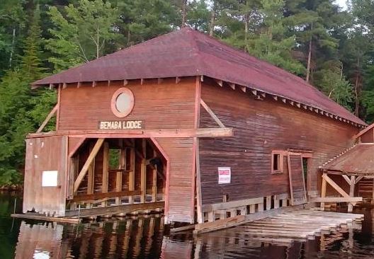

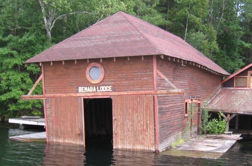

Hey, guys, great suggestions! Keep them coming. Remember, the cribs themselves are these massive 2014 deep beasties that are between 10 and 12 feet across at the top and who knows how wide at the bottom. They are not the problem, although I do need to do a little bit more attaching of my new 6 x 6 members for the last 3 feet or so of height that I used to replace the rotten old cedar crib members. And I can move the walls where if I want, just by hitting them with a sledgehammer. They slide easily on top of the crib. The problem is that the top of each wall does not want to move when the bottom does!
Anyway, I have to go home right now, and will be back at it next weekend. I will be thinking about this during the week as well.
   / How to straighten my boathouse? #23
...The problem is that the top of each wall does not want to move when the bottom does!....
The rear wall of the building must be anchored to something pretty stoutly, then. And the whole thing may be warped to the point of not wanting to go back. But most things can be coaxed with cables and turnbuckles over time.
Do as others have mentioned: Put a plum bob on each corner of the roof and see what has to go where to get the walls as centered under the roof edges as possible first.

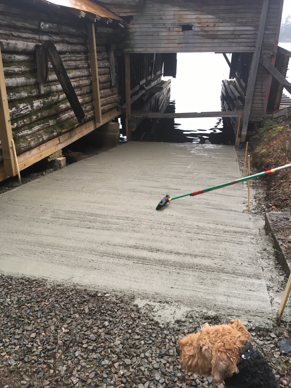

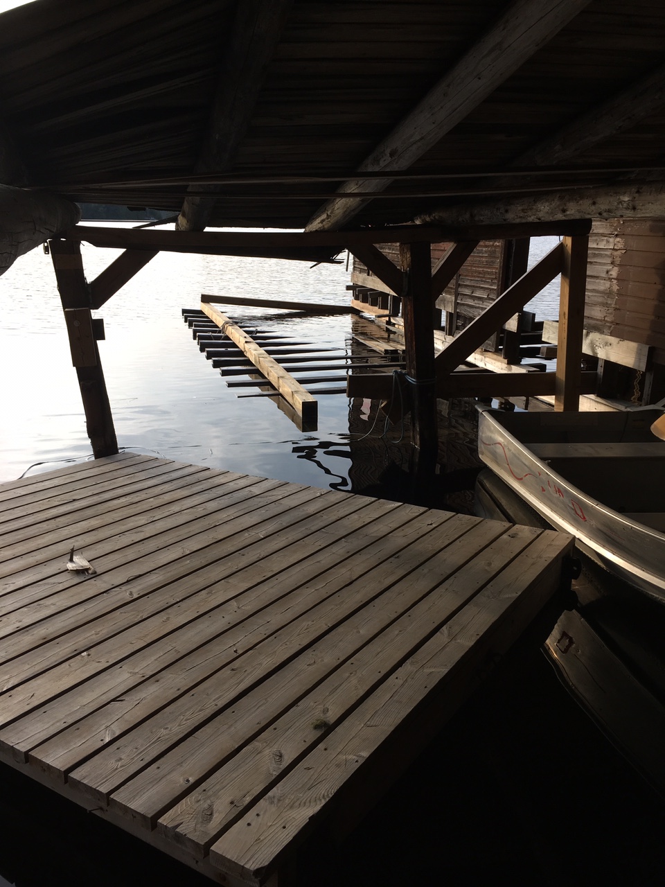

The cribbing is fine and stable, and we are using a de-icer in the winter to prevent ice damage, which is probably what caused the problem in the first place. So there is no further work to be done there. We just need to put the decking back on either side after we get the walls situated horizontally.
And I don’t think the problem is due to age-old warping. In fact, as you can see from one of the pictures, I USED to have them in the right place - you can see the clean spot where the bottom of the wall used to be, about a foot to the left of where it is now. It just doesn’t want to go back there again now.
This coming weekend I will be putting up some scaffolding inside to have a better look at the roof boards, because the plan is to completely reshingle the roof once I get everything in the exact position that I want it.
And thanks for the good suggestions out the plumbob. Actually, I can eyeball it pretty close, and the lien is quite obvious. In the end I can put up with some lean as long as it doesn’t look obvious.
Here are some more photos.
That last photo was taken in the fall, when I rebuilt the floor outside the boat house with new concrete. It is now a good boat ramp. And you can also get an idea of the lien on the right hand side, where I have bolted a couple of 6 x 6’s.
And thanks for the nice compliments as well, guys. I agree that this boat house is magnificent, and a landmark on the lake!
