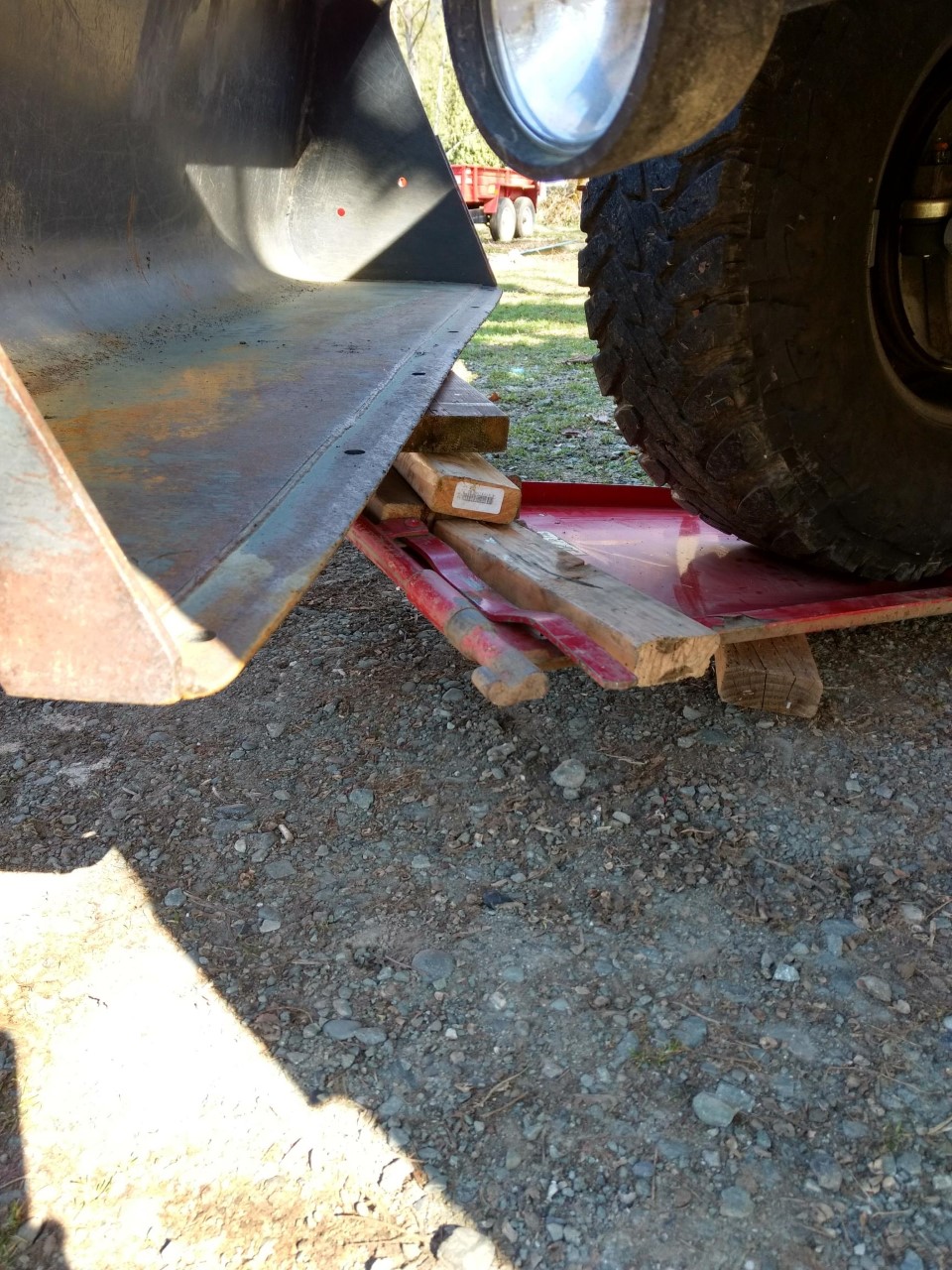

Took me a while before I could complete this work, but I managed to straighten out the tailgate and get it back on. Had it straightened back in March, but it took me a while before I was able to get around to drilling out one of the broken hinge pins: really difficult; had to break down and get a angle drill.
I pinned one edge of the tailgate with my truck, with a 2x4 along the "fault line," and then used the tractor bucket to push it back into shape. I didn't get real fancy on checking square in which case I wasn't sure that it was going to be good enough until I mounted it.

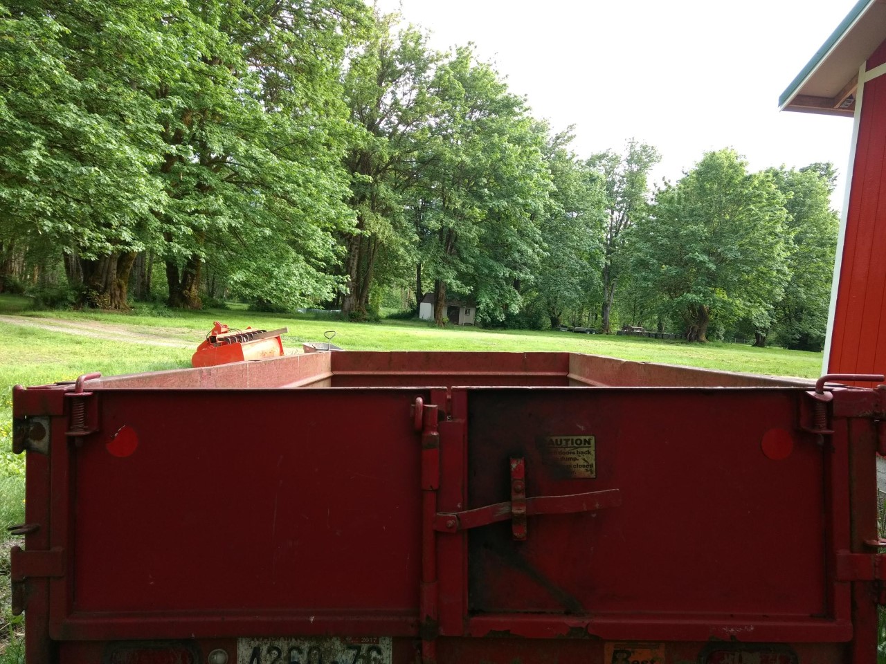

Tailgate mounted back on the trailer.

Well you managed to get the trailor almost perfectly framed in the background of that first picture straightening the tailgate.
Nice work all around :)
