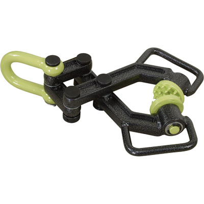

I am not sure this will work on all trees, but I have good luck just grubbing small trees on my place -- don't even have to get off the tractor (except to take pictures)!
The product is actually called a buckthorn puller, although I haven't any buckthorn.
