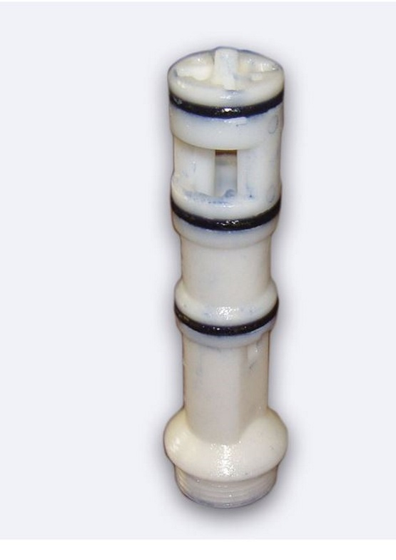

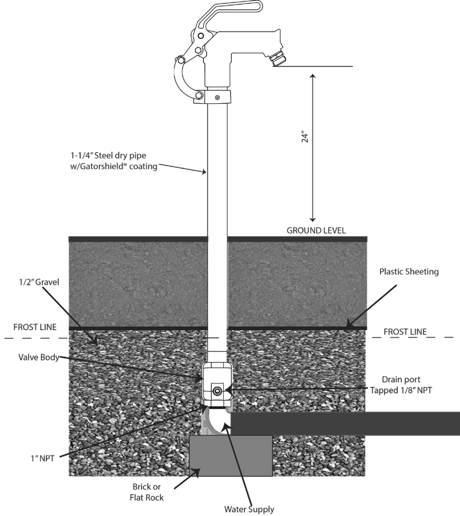

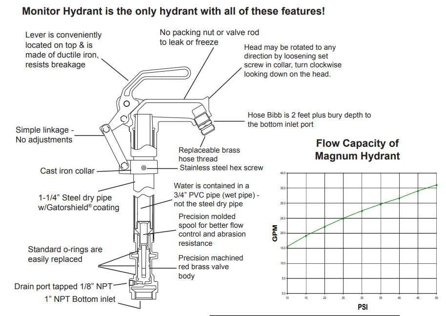

This style is the best frost proof hydrant that I have ever had: Baker Water Systems - Monitor® Magnum Yard Hydrant
The water valve works just like a hydraulic spool valve. And after the hydrant is installed the handle can be rotated to any position desired then held there with the set screw.

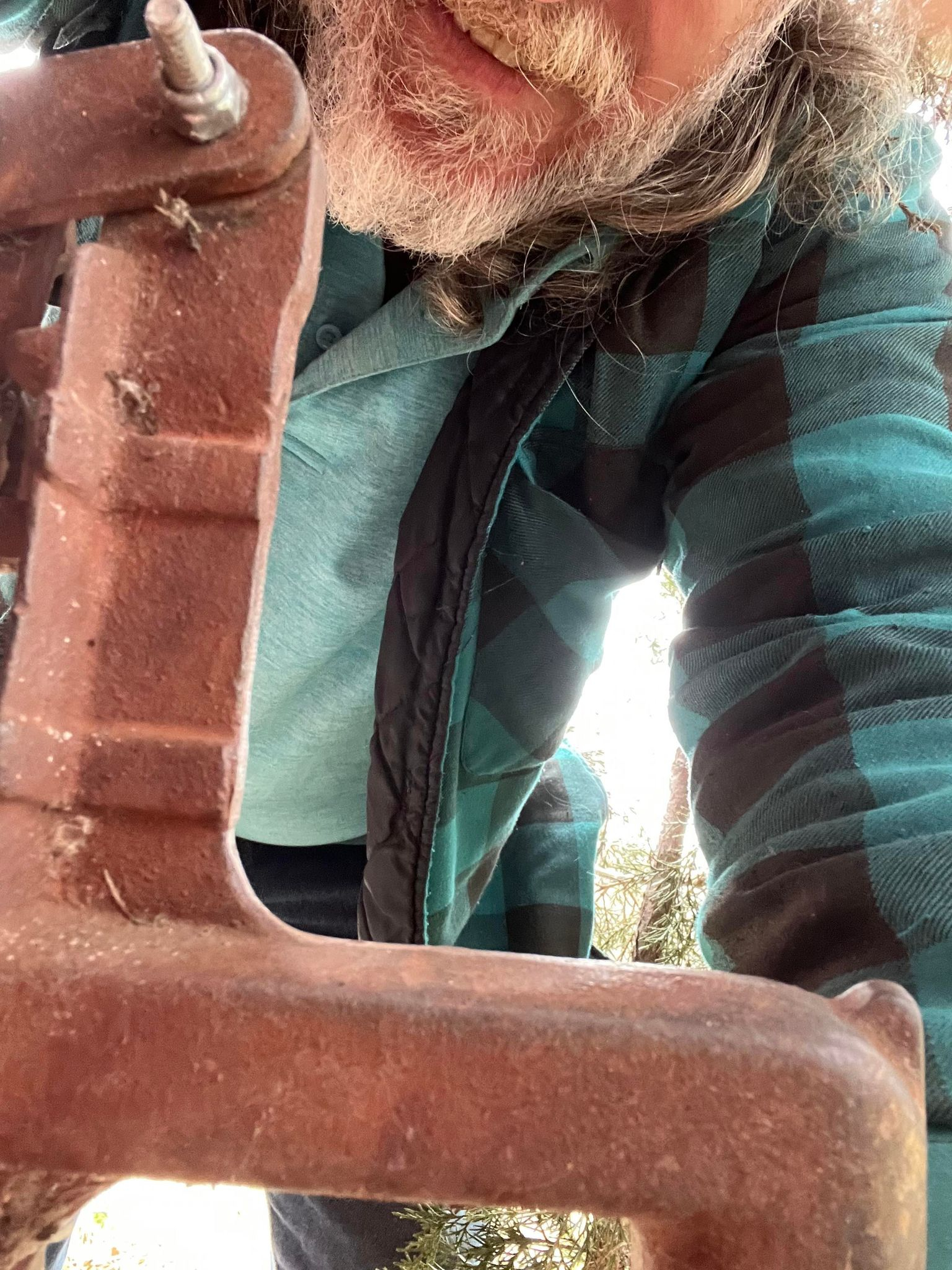

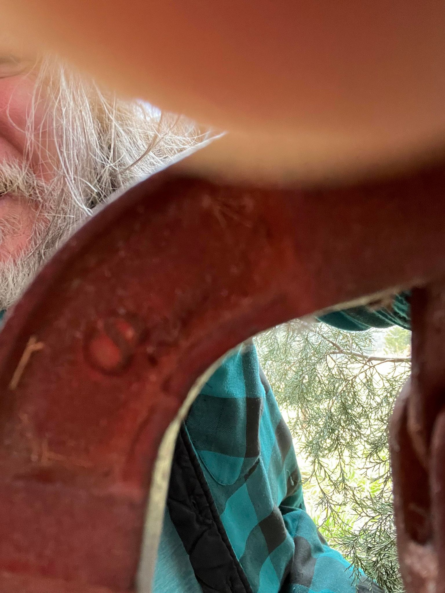

I'm having a very hard time identifying my hydrant to repair it. I'm pretty sure it's the plunger at the bottom of the shaft and want to get the correct one without having to replace the whole hydrant. Cannot really get to the backside of handle and spigot but was able to get a pic of the only identifying mark on the handle. No marks what so ever on right side of spigot.
It looks like there’s hardly room to raise the handle. Is there room for it to unscrew from the pipe? If it’s the plunger on the bottom, you might get lucky and be able to replace it with a “generic” plunger, or one from another model.
