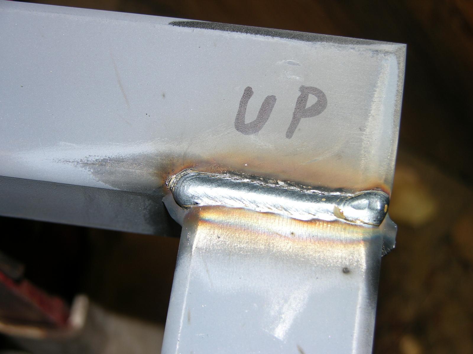

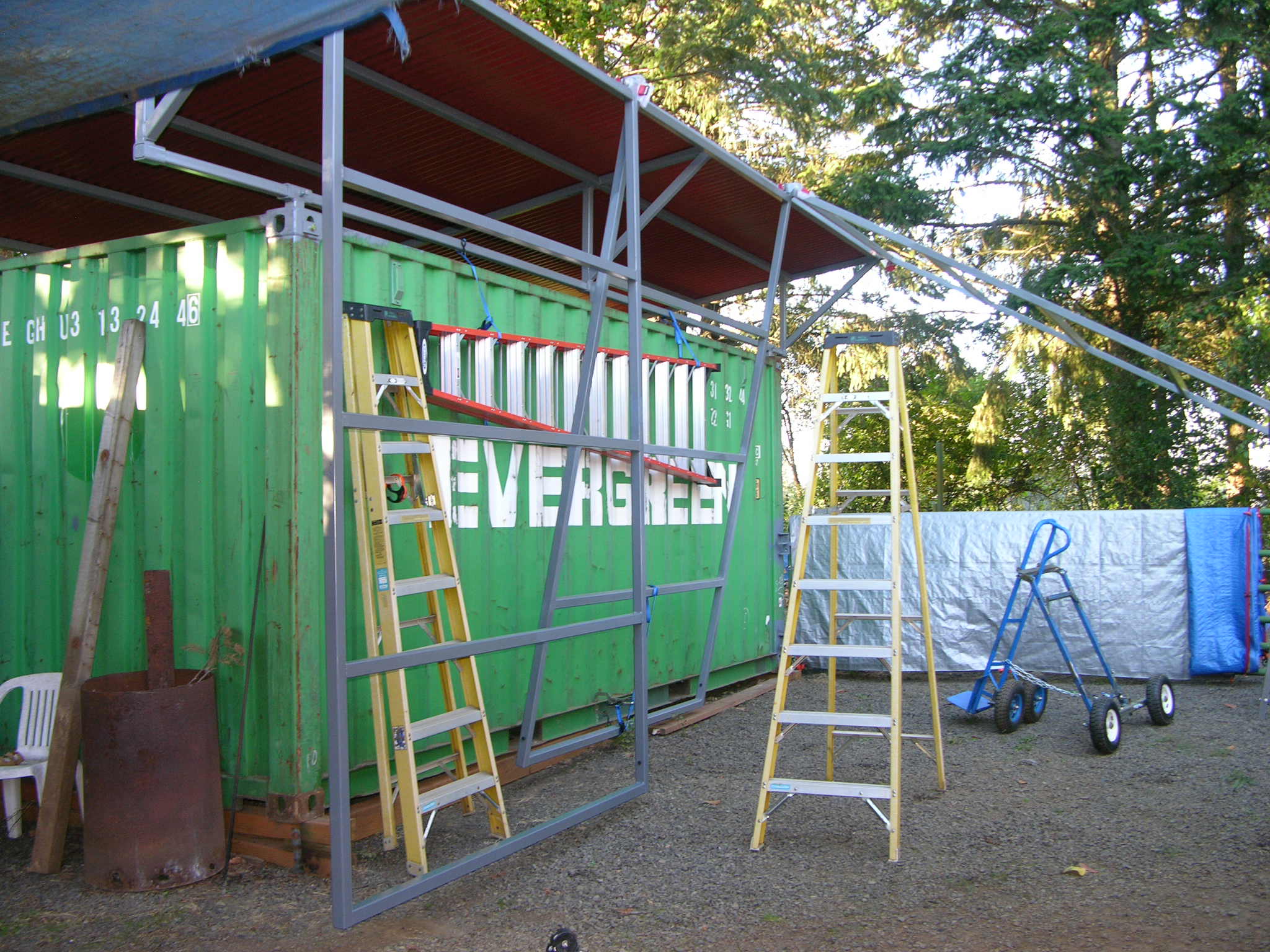

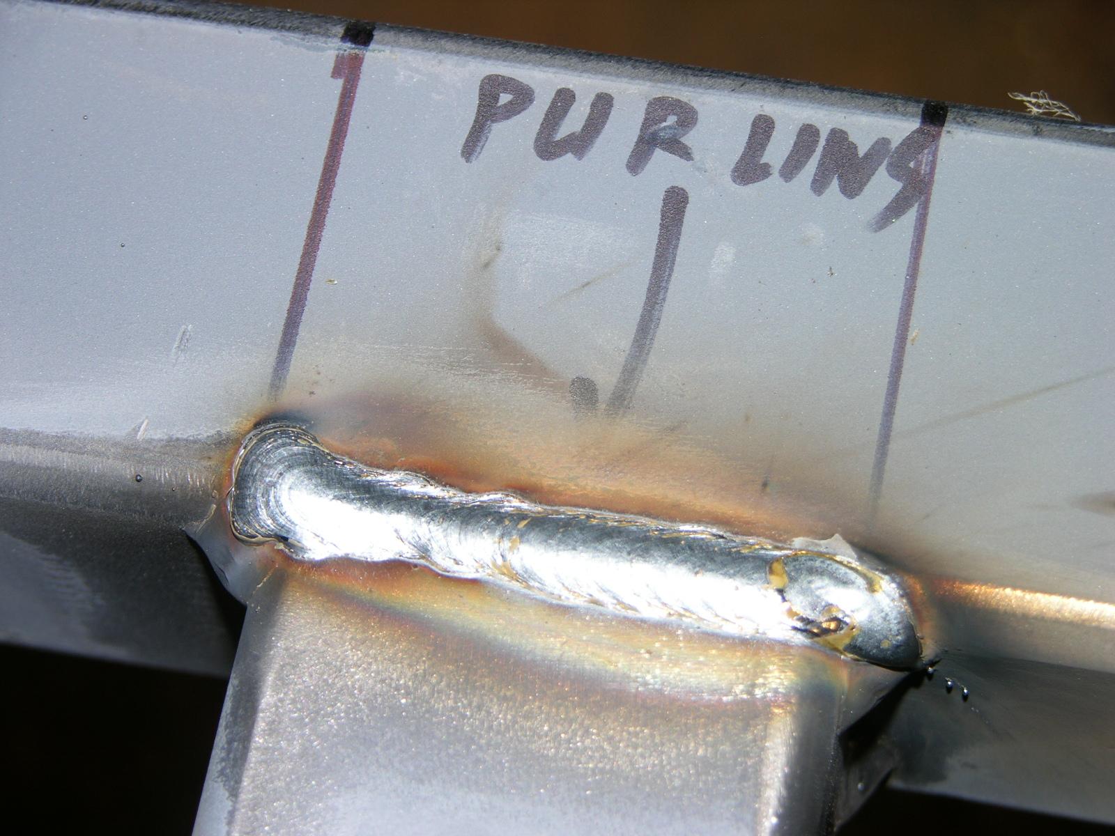

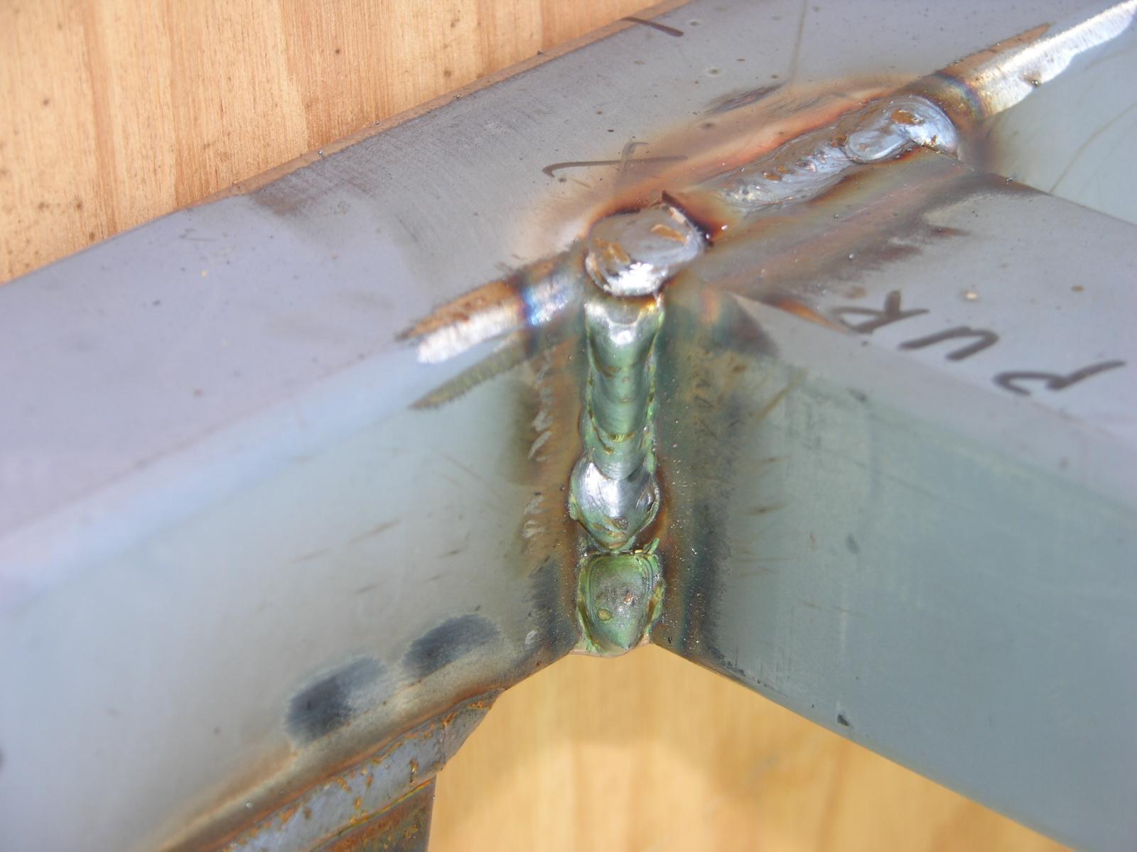

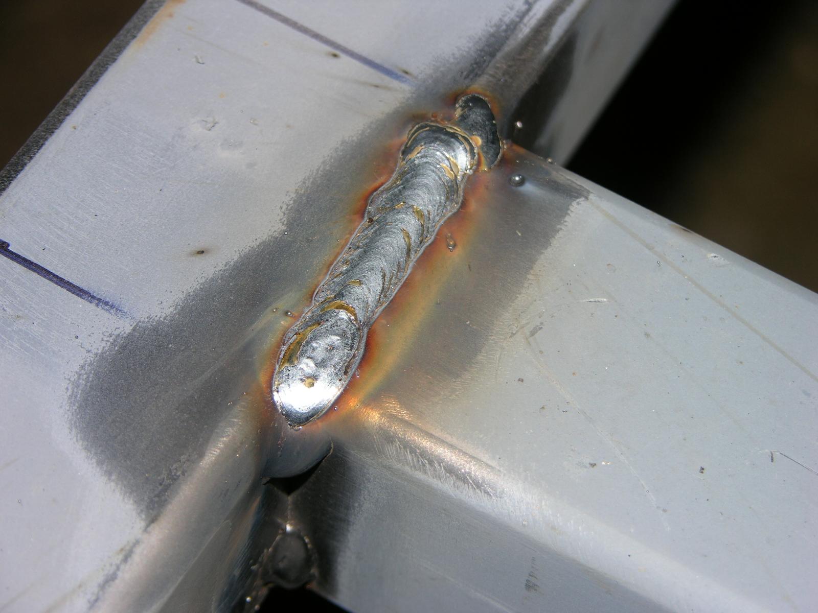

MIG is definitely a different animal than stick for visibility; the only angle I've found that works is to be alongside the weld path, not behind it - from there you can tell if your stickout is right, if your slight rearward tilt of the wire is right, etc - it DOES make it a bit harder to keep the bead STRAIGHT, but not impossible. If you want even MORE "fun", try a full size spool gun 10 feet in the air with a 6-7 mph wind - DSCN2241.JPG the plywood in the background was clamped to the .120 wall 2" tubing to block some wind; I also upped the gas to around 25 scfh instead of the usual 18-20. Can't really blame the vertical on wind, I just suck at vertical up... These others (all untouched after weld) were inside with normal mig gun, MM252/.035 Lincoln L56 wire/C25 gas - DSCN2359.JPG DSCN2361.JPG DSCN2362.JPG
This is the roof frame where they eventually ended up -
I'm now on my second and third MIG, bought the first one (now belongs to a friend) at least 10 years ago and since then I've used stick maybe TWICE - everything else gets done with the same combo mentioned above, from welding 14 ga. fence wire to emt conduit, up to 3/4" flat bar for 20 ton bending jigs. Best advice I ever got was from Jody at weldingtipsandtricks.com - specifically, to stay at the front of the puddle (in direction of travel), and NOT assume you're getting penetration unless you SEE the arc touch the parent metal.

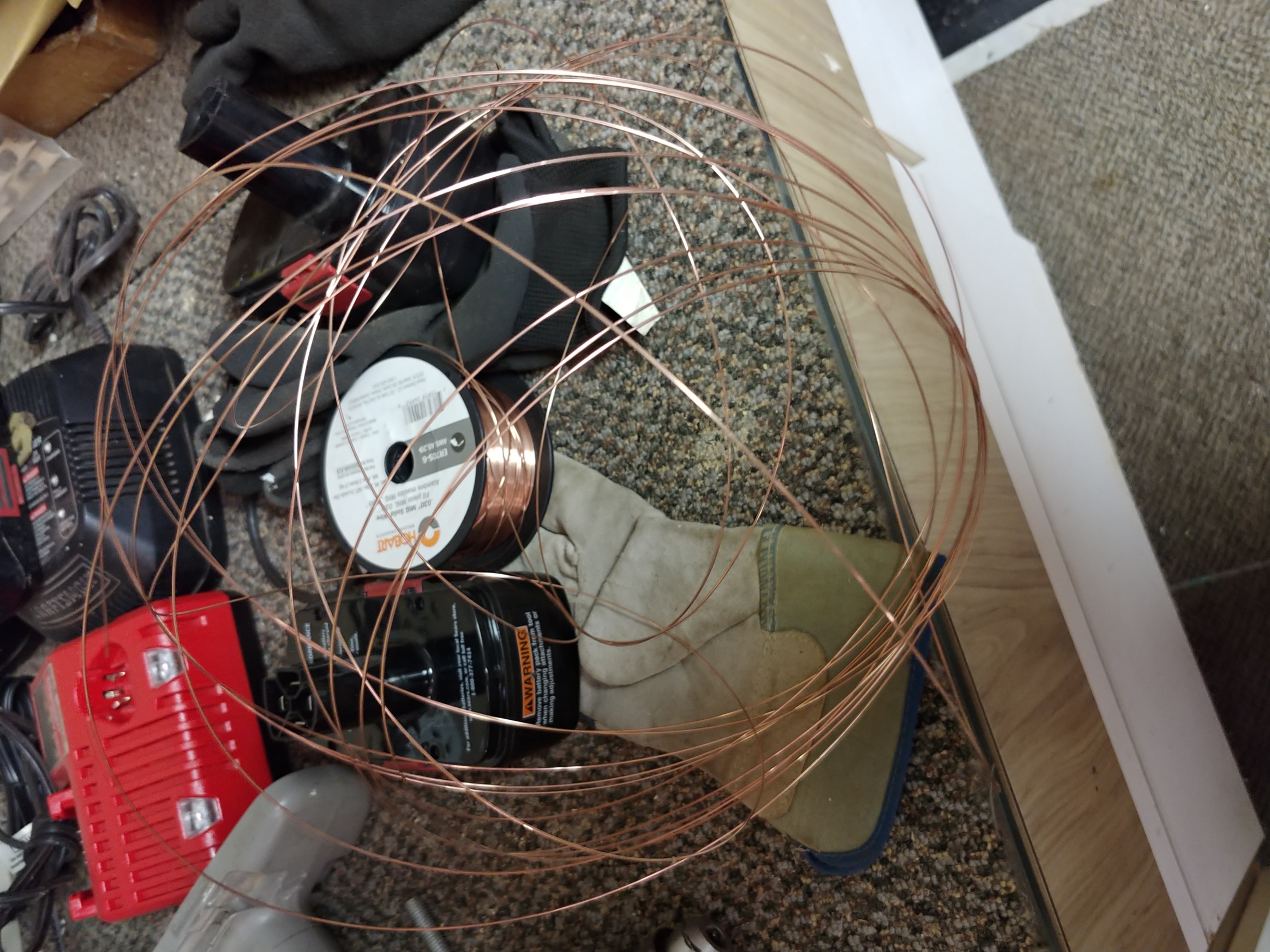

when transitioning to mig like me..............dont do this!!!:mur:

That happens whether you are transitioning or not. Happened today. Bigger spools have less cast and helix so they are a little more manageable.

im glad im not the only one, i almost said a bad word :eek:
   / How to transition to MIG? #179
You are not the only one, just cut it off and move on.
If it is an older spool then sometimes it is a good thing as the top layers build up corrosion which can cause bad things.
   / How to transition to MIG? #180
Been there done that. Little rolls can be finicky to handle especially when you’re in one of your “all thumbs”modes
LOL.
As coxhaus said snip and move on.
