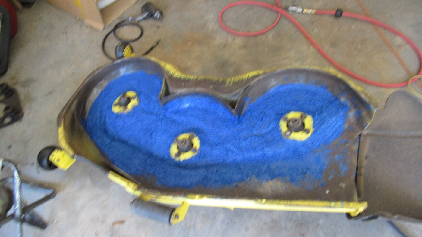

When I built the deck for my JD F725 I came across some Loctite PC9599 wearing compound on Amazon for $42. I went back later to try and buy another bucket of it and it was listed for over a $200. I see it listed now for $93.29.
It's blue epoxy stuff full of ceramic beads.
It's a pretty grainy finish that I was afraid would gather grass pretty bad but so far stuff seems to fall off of it.
