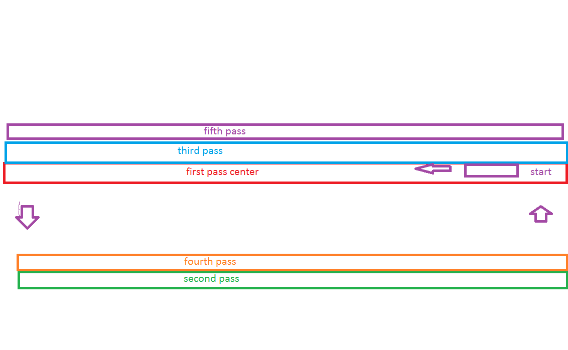

There was a time when quality of planting straight rows of ANYTHING meant something and I have seen men re disk and start over if the rows were crooked . I still plant by sight. When starting a rectangular field its best to start on longest side , when you get to the end lift swing wide and start back down on your next thru . When you get to the short rows just make a circle and then start the thru. it doesn't hurt to re drive on what you have planted with a drill . after your done it should take but maybe 2 rounds around the perimeter to plant the ends and the short side where you turned .
   / How To Use A Seed Drill #14
Here is the way we were taught.Of course you have to plant the ends.Just continue until completed.This gives equal and maximum turn around area.We have some long and narrow food plots so this doesn't help there.

I finally figured out why I was having so much trouble understanding the "start in the middle" strategy. I grew up here in the Midwest where typical field sizes range from 80 to 160 acres where it wouldn't be feasible to start out in the middle. There would be way too much "empty" driving from one side of the field to the other as the work progresses.
