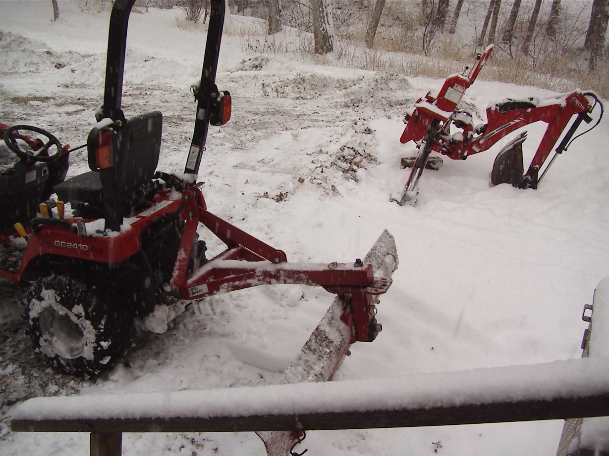

Cttractor, now you've got me worried. I wasn't really focusing on the front, but is it possible to load up the bucket so as to create more net weight? I know from my smaller garden tractor with a roto tiller behind what it's like to not be able to steer - like jumping off and pushing the front over :).
One thought is to keep the blade in closer to the rear. Because of the tilt pin format, the blade can be reversed rather awkwardly by reinstalling it, so I could shorten things so that it can't swing around 360 degrees. I'm not sure how close to the rear I should go, though. If I put on gauge wheels do I even need to consider reversing it??
I don't mind cautionary comments, in fact I welcome them, after all what good does it do to have one's head in the sand. I can comfortably lift one end of the blade so it isn't yet "that" heavy - I guess it's all relative - again I don't have any experience.

I'm not looking to frighten you, just to do as you have asked and offer insight into the issues you need to consider when building your blade.
As I and Yelbike have explained, when raised, the blade acts as a weight box and places ballast over the rear wheels. When it's resting on the ground, that weight no longer provides ballast because it's on the ground, plus, you now need adequate traction to drag that blade AND its load along the ground. One thing that can help is filling the wheels. That always adds weight that will remain on your tractor for additional traction. Or add wheel weights -- you can remove those when mowing so you don't overly compact your lawn and for soft ground.
As for the blade, I, too, like heavy duty construction. I just wanted to point out that you can't ignore the weight because it doesn't help you when it's on the ground. Second, I wouldn't pull the blade in too close. I run a six foot rear Woods blade for snow cleanup on my machine and it works well. I like the fact I can rotate the blade 360 degrees. In fact, I sometimes pull it backwards when cleaning snow from my lawn -- it won't dig it up that way.
You might ask, "Why does this jamoka plow his lawn? Is he daft?" Well, I may be daft, but the reason I found myself plowing some of my lawn last year was that we kept getting snow dumped on us, so I cleared a swath 30 feet off the edge of my driveway after the second December storm to assure I had enough space to put snow from additional storms. And man was I happy I did that! By March, I had a large 6 foot high wall of snow 25 feet deep that was only about four feet off the edge of the driveway. We had never gotten so much snow; another few storms and I would have run out of space for it. After that, my driveway would have gotten narrower until it couldn't pass a car.
So, the foregoing is just a long way of saying that I'd keep the ability to rotate the blade 360 degrees, would make the blade heavy duty, but not ignore its weight, and would consider loading the tires or installing wheel weights so my traction is not limited to my tractor's weight when the blade is down.
I hope this helps.

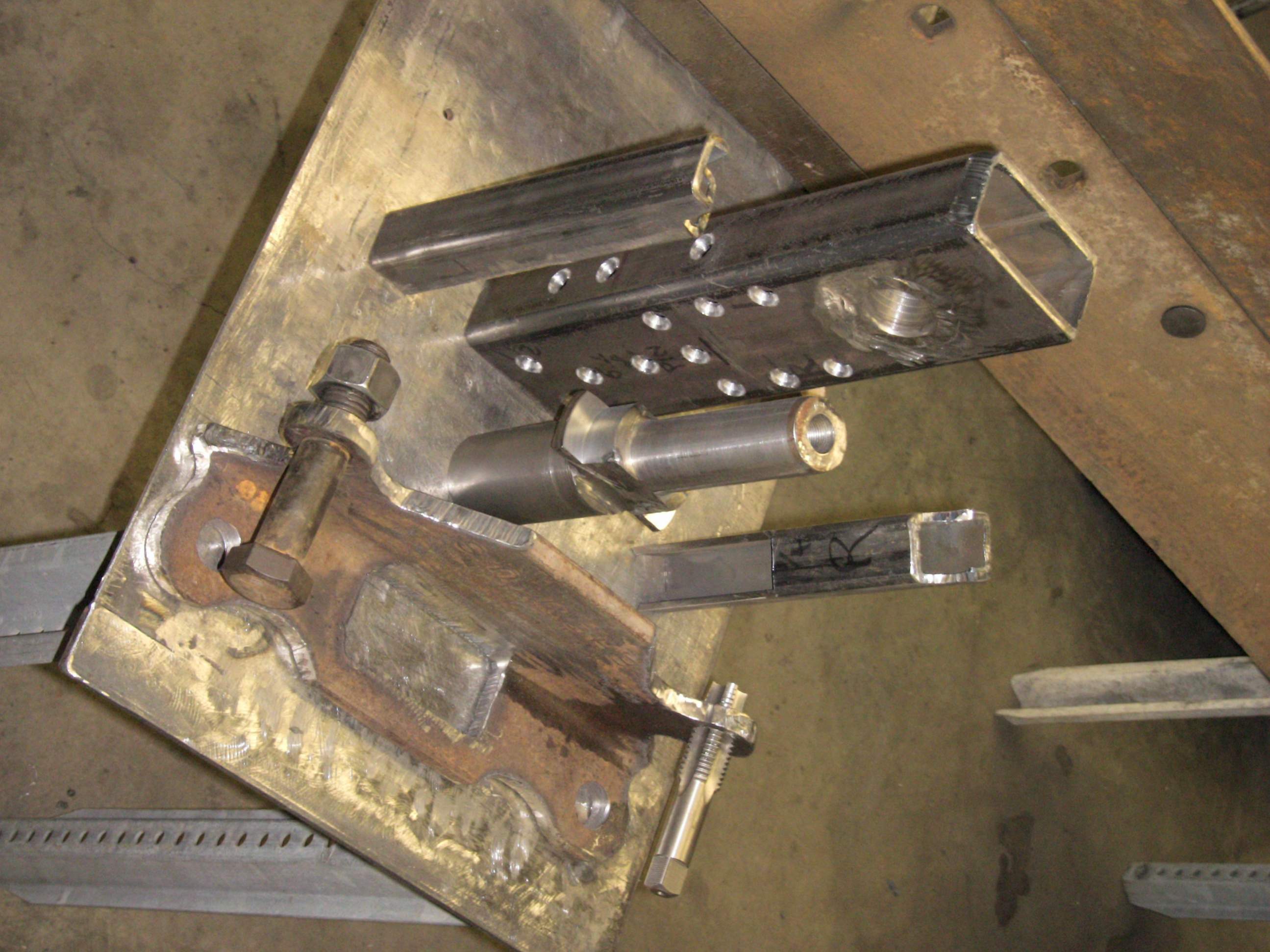

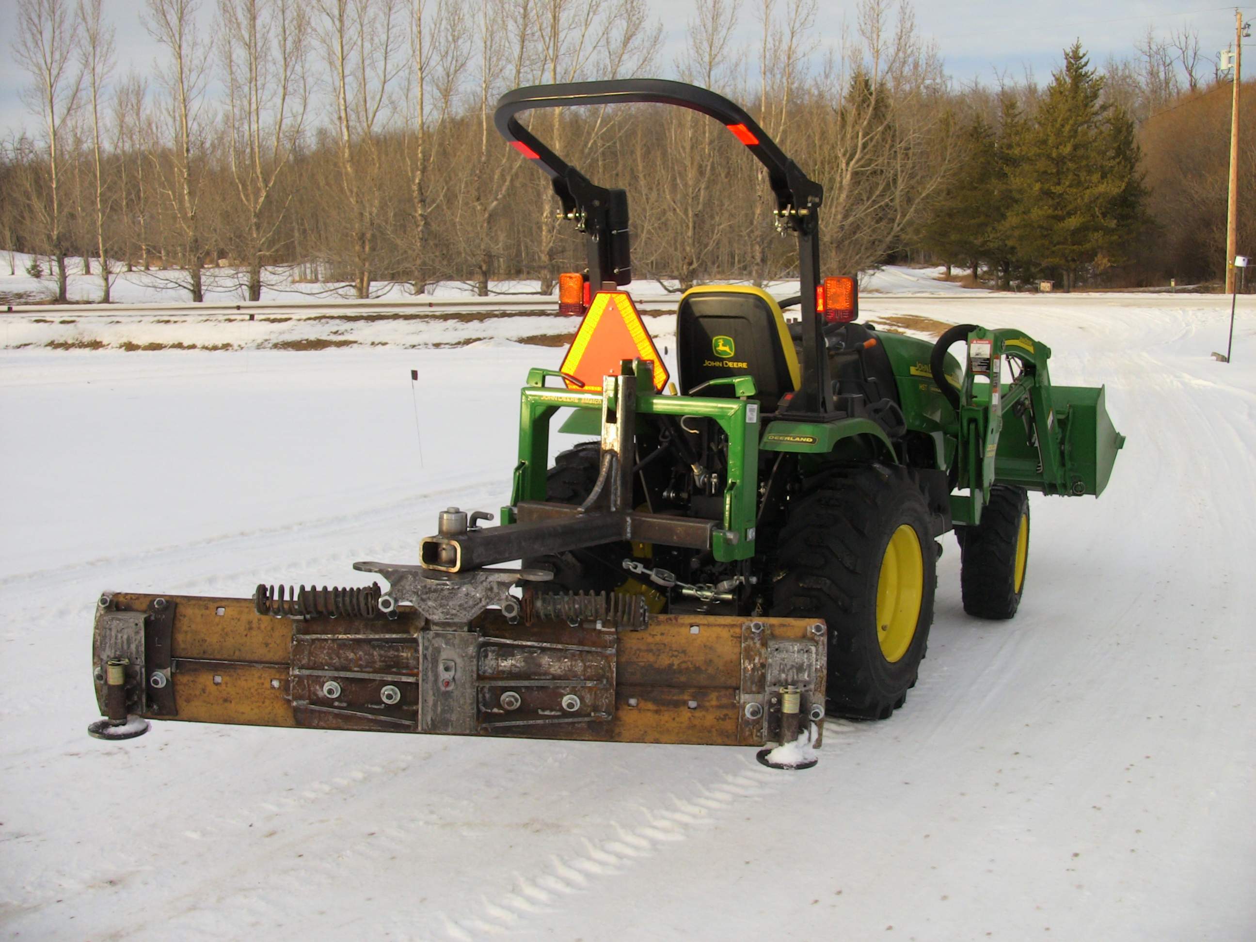

Well here is the latest regarding my rear snow blade. Considering mig gas and some odds and ends I spent about $200 and it was at least $200 worth of fun:laughing:
I have left the option of adding hydraulic angle open but for now since the tractor isn't blumbed for hydraulics, that's a future hope.
A friend convinced me, rightfully I believe, that offset would not be all that useful to me. Plus I reasoned that my light JD2320 would probably get pushed over sideways, negating its value. Of course this speeded up my dragging project substantially. The blade at 6'2" is out past the tractor about a foot when angled around 30 degrees.

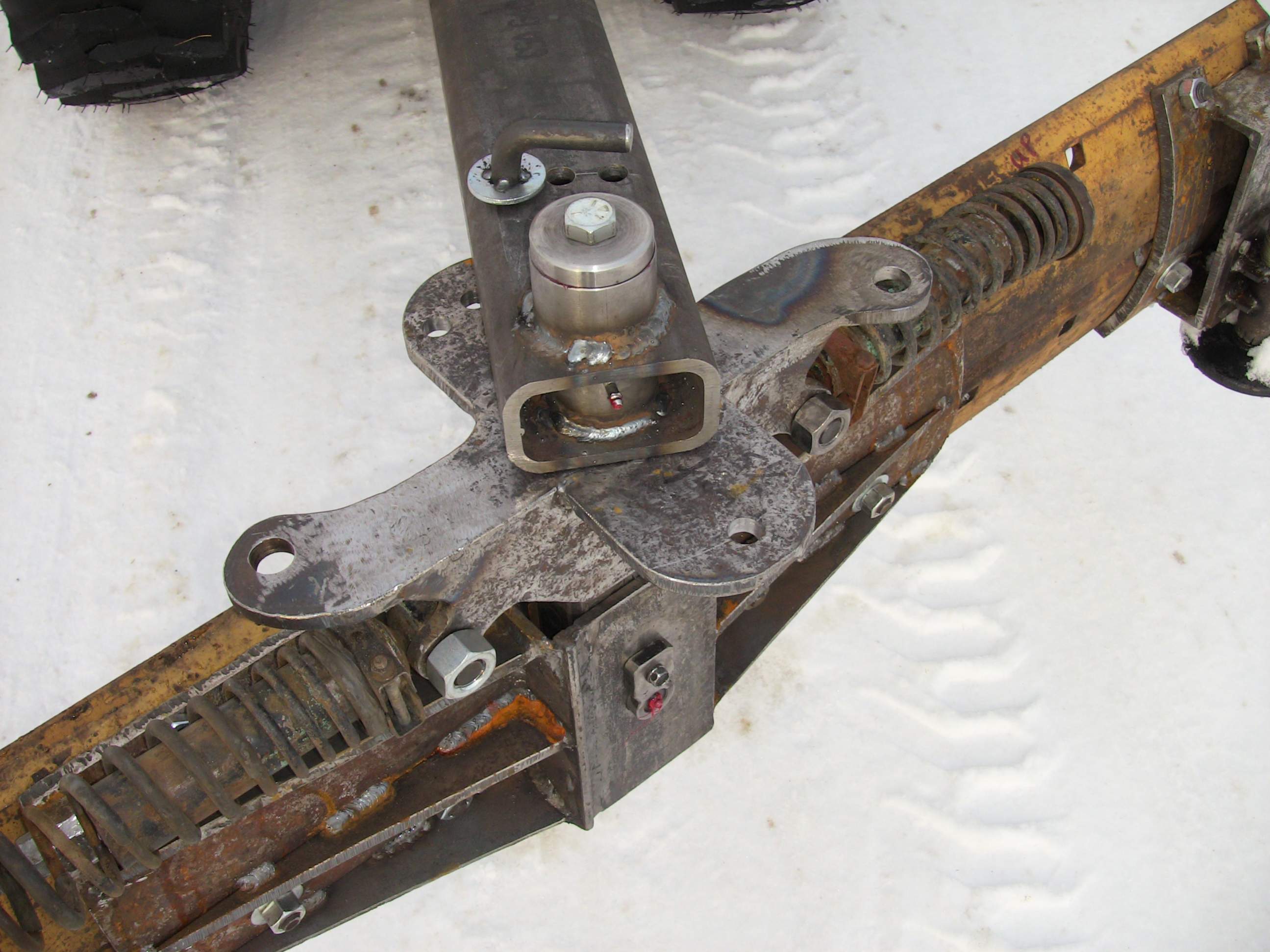

I have tried out the blade and feel that the floating tilt feature is useful. Have included some pics showing how I beefed up that 2x4 x 1/4" vertical piece that provides the tilt and rotation. Also, I purchased a scrap piece of 3x5 x 3/8" for the main beam ($65). It's overkill but I was insecure with 3x3 x 1/4. It facilitated the holes for the fixed pin for rotation and handled the rotation sleeve that was nearly 3" OD, nicely.
I'm very happy to have the weight. If I start to slip, I raise the blade slightly and have traction again. To prevent the floating tilt from swinging down and hooking something when the blade is elevated I added some old shock springs - seems to work fine - the blade follows the lay of the land nicely. I still need a support post and hopefully will sandblast and paint in the spring.
For summer use I'll probably add a pair of casters in place of the skids and possibly a center gauge wheel. Again, I think this floating tilt will help when leveling dirt but that remains to be seen.
Thanks again to those who helped with my insecurities, it wasn't really such a big deal, but that's hindsight.

Jack, nicely done! The whole thing looks "meaty" and hardy. I suspect it'll hold up quite well.
You may find that the skids work fine for grading. Many skids fail because they're not large enough; yours look big enough to float and not let the blade dig in except on the softest soil. Even a center gauge wheel doesn't work well when the surface you're on is too soft.

Wow!! Built like a tank! Nice job, I really like the floating feature. You should patent! I still think its land mine rated!:laughing:
