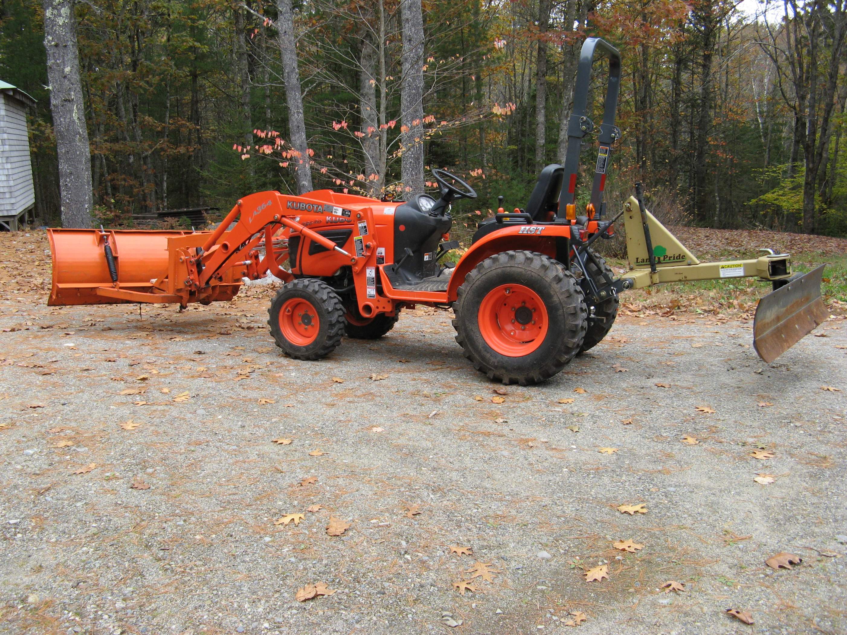

How about both? It's fast and gives me a lot of options for pulling or pushing and with the quick attach I can swap out the homemade front blade for a bucket to pile up snow. I use chains front and rear after things ice up - I go easy and no problems so far.:thumbsup:

The BX2660 is the best machine unless you need to push banks, it doesn't have quite enough weight to push back hard banks of snow.
Here is my BX1500 with the same blade.
Not only will it move snow quite well it is also great for pushing dirt gravel sand etc .
Try that with your snow blower.
