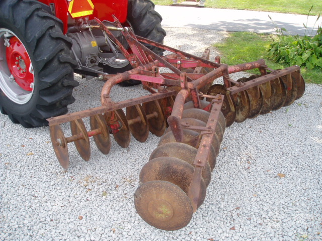

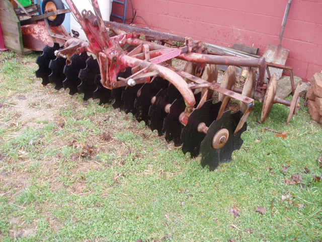

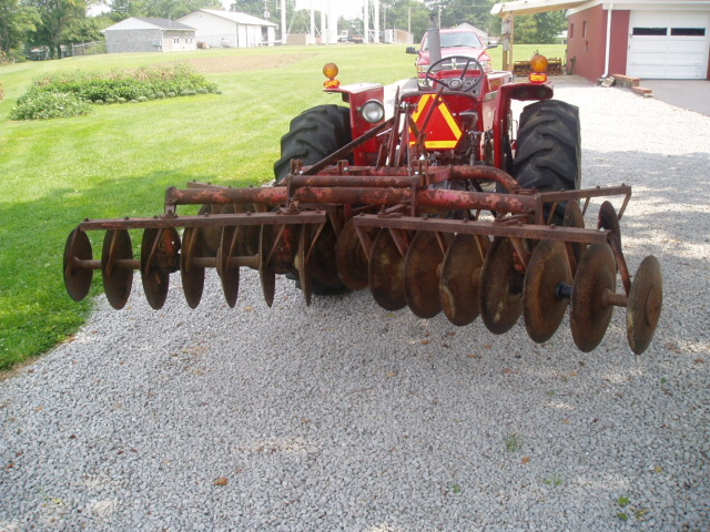

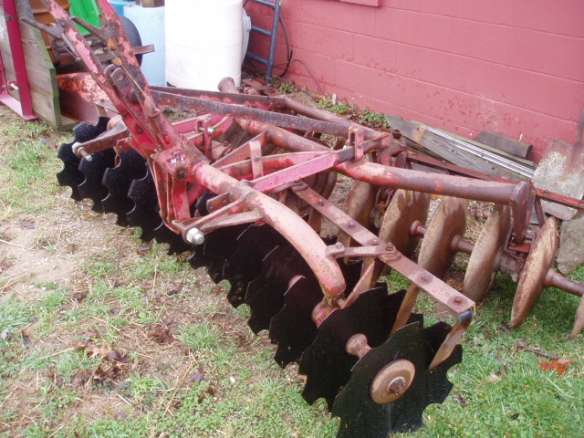

Yep....
MF #25 disc. I bought it as an 8'-10" model. I pulled all 4 axles, cut them down, and re-assembled with 1 less disc, one less spool per axle. Also I had to cut down the scraper assembly by one blade. That gave me a 7'-6" model. The tractor handled the 8'-10" version, but it wasn't legal to haul on the road. I replaced the disc blades on the front gangs, but otherwise had $00.00 involved, and roughly 4 hours time. Wider models USUALLY sell cheaper. Not nearly as much demand these days. Same disc can be reduced to a 6'er by eliminating another blade per gang.
First 2 pictures are the original, 2nd pair is cut down version.
