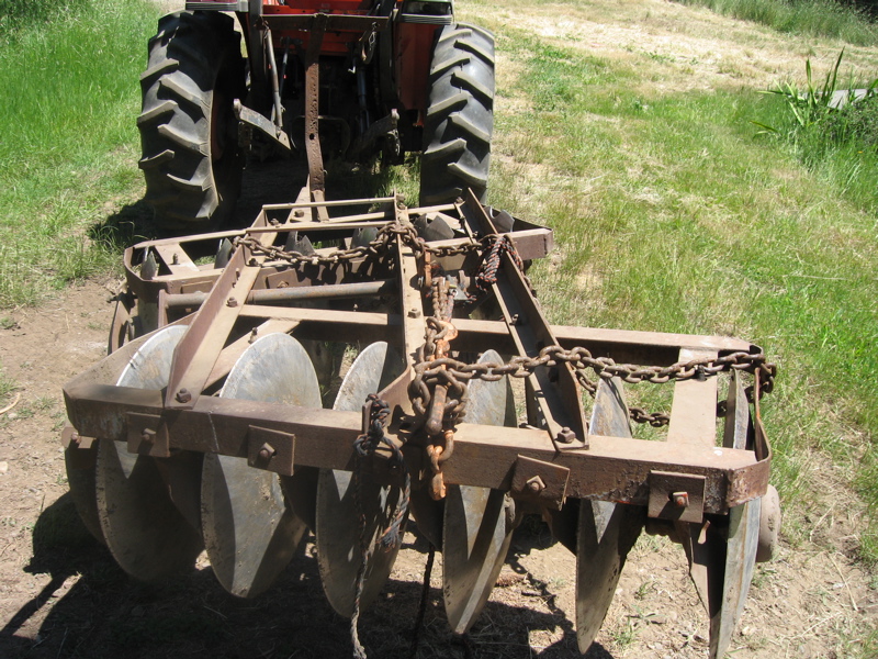

If anyone has any pictures of a modification to remove the hydraulic cylinder and replace it with a chain binder, or hand crank, that woudl sure help me out as I have no rear remotes on the cub. I'm thinking of a chain binder or a come along to raise and lower the wheels for transport.

to deal with transport disc without hydraulics on tractor, take the cylinder off and bolt some chain through the hole. the next part is tricky and might not work if disc is super heavy, but try to lift one end of the disc off the ground until the wheels have dropped, then tighten the chain with a binder. my picture has aboutt 18 feet too much chain. i have used come along, but it was difficult to disengage.

Depending ont he setup.. you could use a turn buckle.. and on some old implements where they needed an extend-to lower.. I've seen bottle jacks used then there was a flip down piece of metal that pinned in place to hold it so the jack didn't carry the load while on the road. Heck.. you might be able to use a couple cheap jacks to lif the frame in order to drop the wheels and do it that way too.. there's always more than one way to skin a cat.
Lastly.. this is an old trick I've seen alot of ford guys do.. as the old 9n/2n/8n were not super easy or convienient to tap hyds off of ( yes you could.. but ya lost the 3pt inthe process .. etc.. )
In any case.. a large diameter SA hyd cyl is mounted between the toplink and the 3pt drawbar. Your implement can be towed on the swinging drawbar.. have the cyl fille dwith oil when extended... run a hosse from the cyl to the cyl on the lift implement.. if it is SA.. great.. if it is DA.. run it to the side that will allow youto get the wheels down, and put a breather on the other side. Now.. bleed the system out real good and get oil in the hoses and acyls.. When you raise your 3pt, the cyl in the rear is compressed.. thus forcing oil down the line to the cyl on the implement.
I've seen at least a couple 8n guys doing this to run a dozer blad or snowplaow blade ont he front of their N by using a cyl mounted this way, 2 cyls can be used if you have 2 cyls that are on the lift implement..
This was way easier than chaingin the lift arms down and tapping the pressure point on the pump base cover to get hyd pressure out of the old N..

There is a racheting "cylinder" (I don't know the actual name for it). It is similar to the racheting chain binders but it is designed for use on equipment that doesn't have hydraulics. My Massey Harris 5' vineyard disc has one on it.

I think it's called a "Ratchet Lift Screw". It is an option on my pull-type mower. To raise the mower I have a cylinder that raises the wheels. The manual shows the "manual lift" option with what is called a "Ratchet Lift Screw" bolted in just like a hydraulic cylinder would be.
